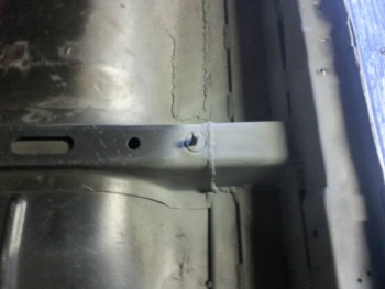

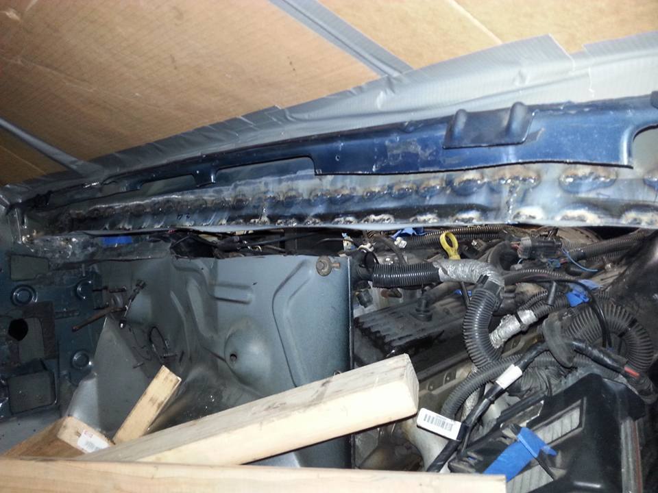

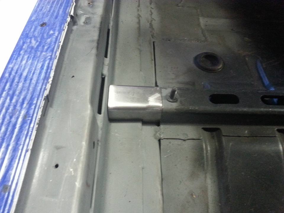

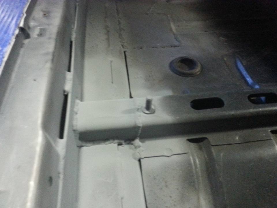

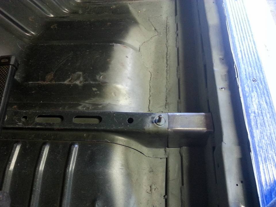

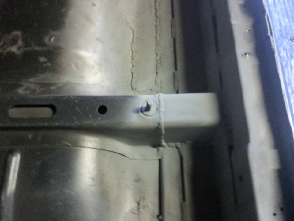

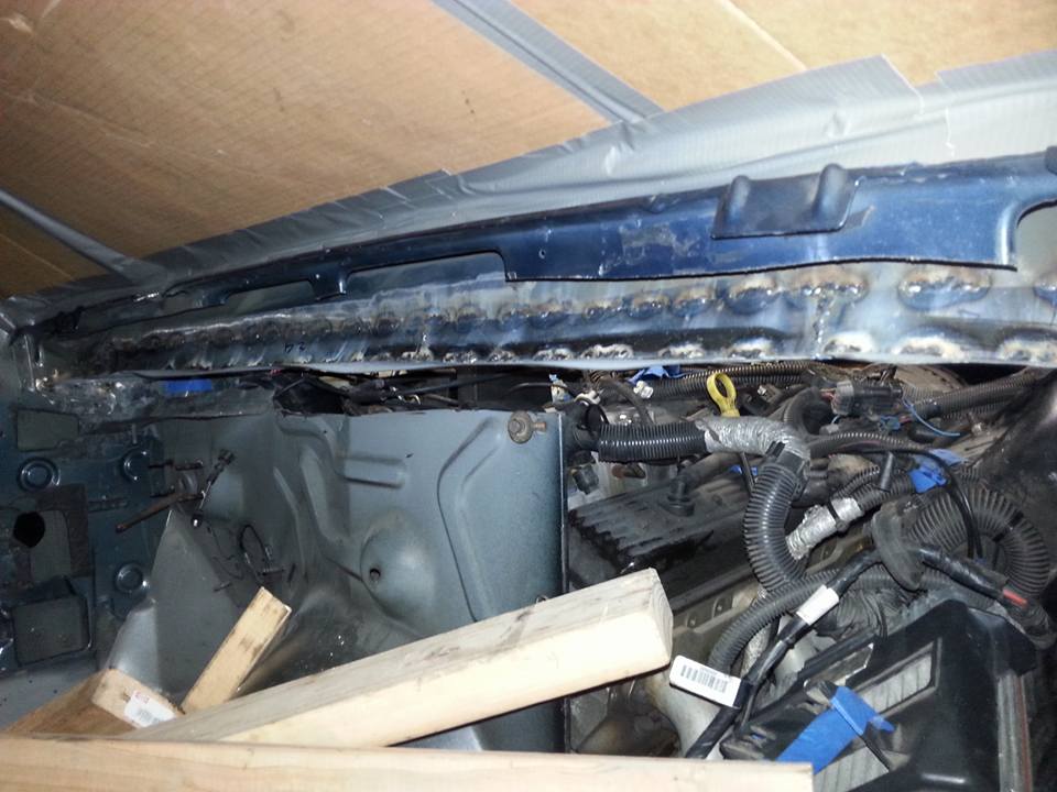

Bent up on the brake and welded in the missing sections of the seat rails. Also stitch welded in the back of the wiper cowl.

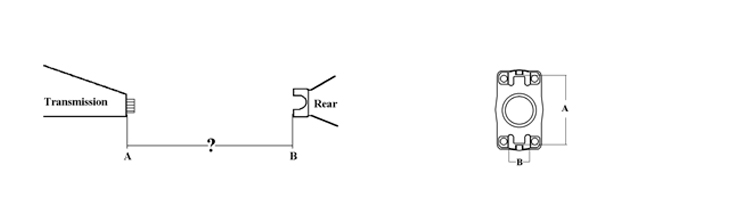

Just thought of this - are you going to have to shorten the drive shaft - or is the rear axle in the stockish location?

Drive shaft will have to be lengthened approx 2 inches.....ive just started to shop around and do research on who will be doing it......believe it or not the beretta has a longer wheel base than a 4 th gen camaro

Lengthened - dang! With all these late model swaps you always hear of shortening - not adding material!
Thats pretty cool - keep up the good work!
Re: Beretta Z28
Look in to a truck drive shaft. Easier and less cost to shorten than the other way around.

Drive shaft shop will make all new and ball Parked 400$$ approx cost to fab.....another shop by me will cut the tube out and weld in a new longer shaft for approx 300$$ ....im gonna measure it tonight and see .....

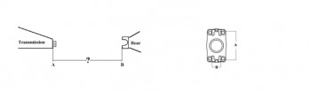

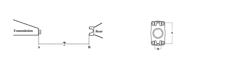

driveshaft will need to be 46 5/8 inches long from the face of the tans where the seal sits to the face or center line of the yoke. also it will need to be the same spline count on the output shaft and have the same yoke as a chevy 10 bolt rearend A= 3 1/2 inches and B =1 1/2 inches.
