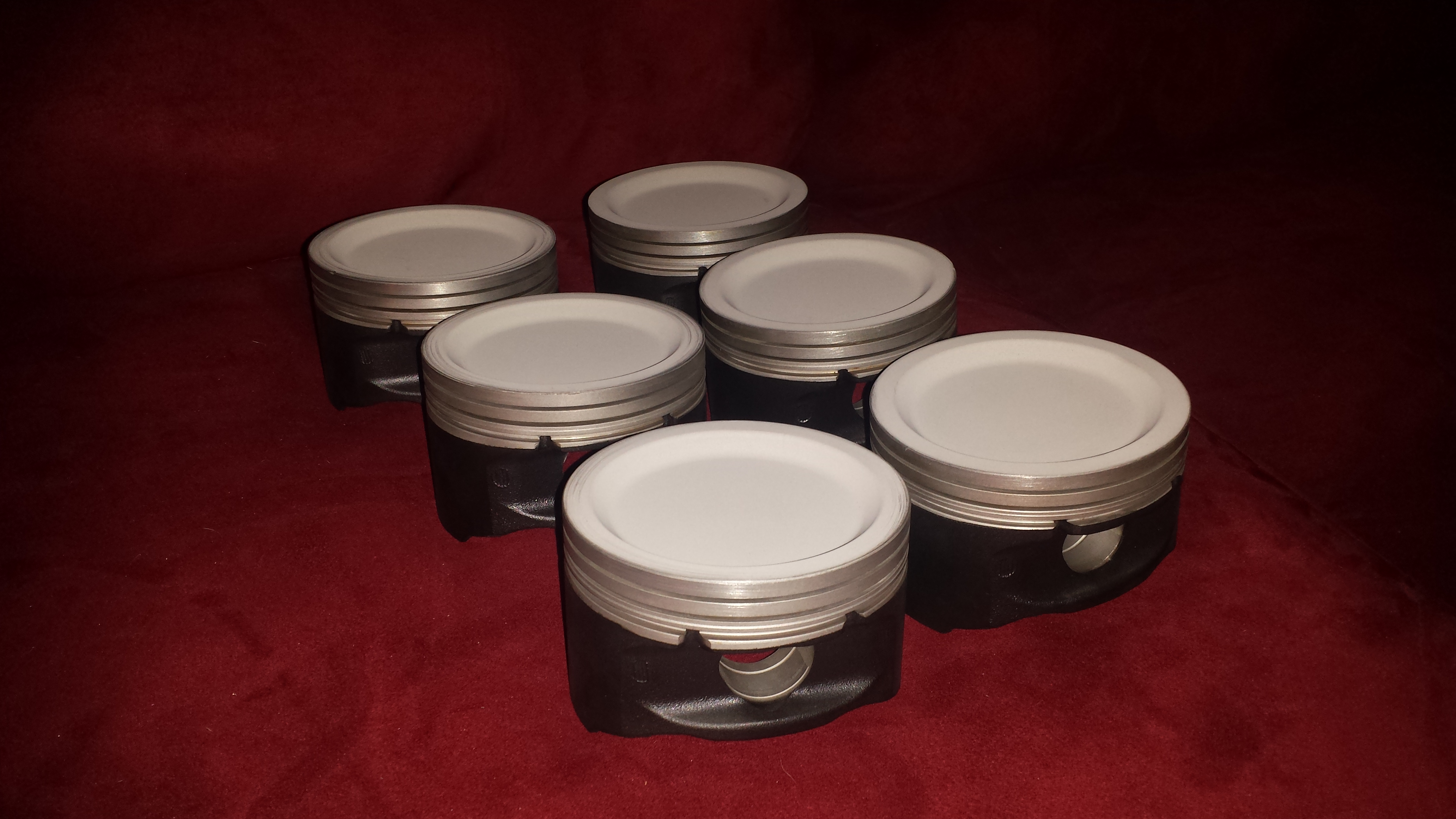

Was there ever a oil squirter for the pistons available on the 60*?
Re: 1996 Mr.Pink
on the 3500 yes just cylinder 5/6. On the later 3900 and 3500 vvt I believe the block changed enough to allow all cylinders to have a squirter. Unfortunately the LX9 3500 there isnt enough room to machine a flat to install two more squirters, otherwise I would be doing that.
And actually the bits I have cleaned up the block WAY quicker than I expected... I was using just a single cut carbide bur
- Posts: 677
- Location: Charlotte, NC
Re: 1996 Mr.Pink
Ah - that sucks..
How do these work - are they fed by the oil galley and then spray upwards?
Re: 1996 Mr.Pink
The squirters are nice but I don't think they are NECESSARY.... The only thing I noticed about the 3400 I bought was the backs of the 5-6 pistons were clean... vs the rest had carbon and oil deposit build up from not being constantly washed with oil. And yeah the hole taps right into the main cam oil galley and there is a valve in it that prevent's the oil from draining out of that squirter, it only lets oil by when under pressure.

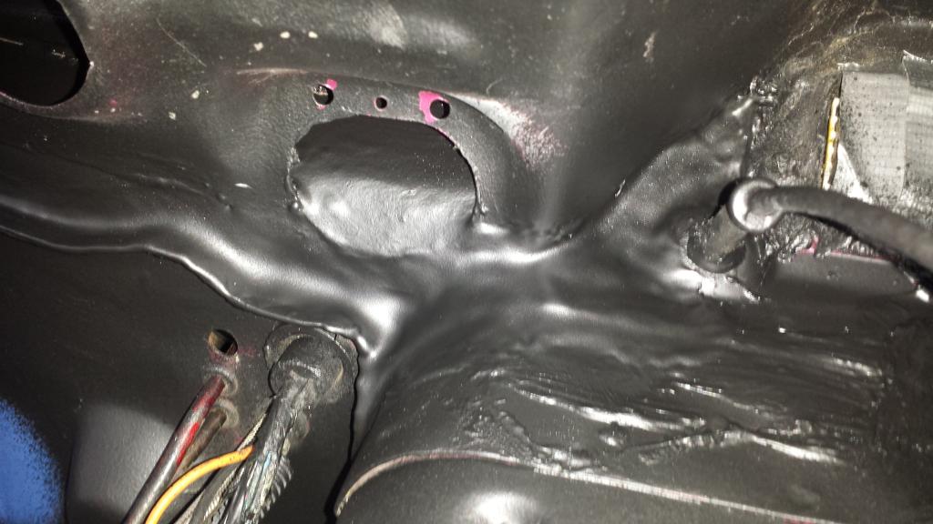

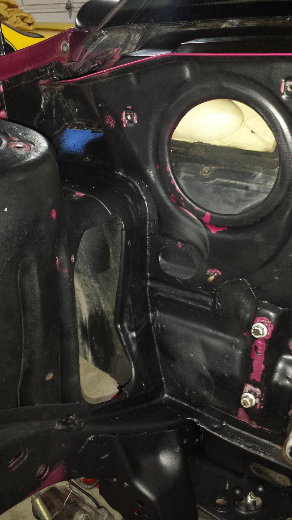

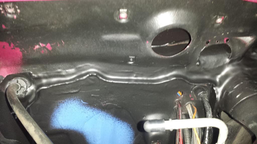

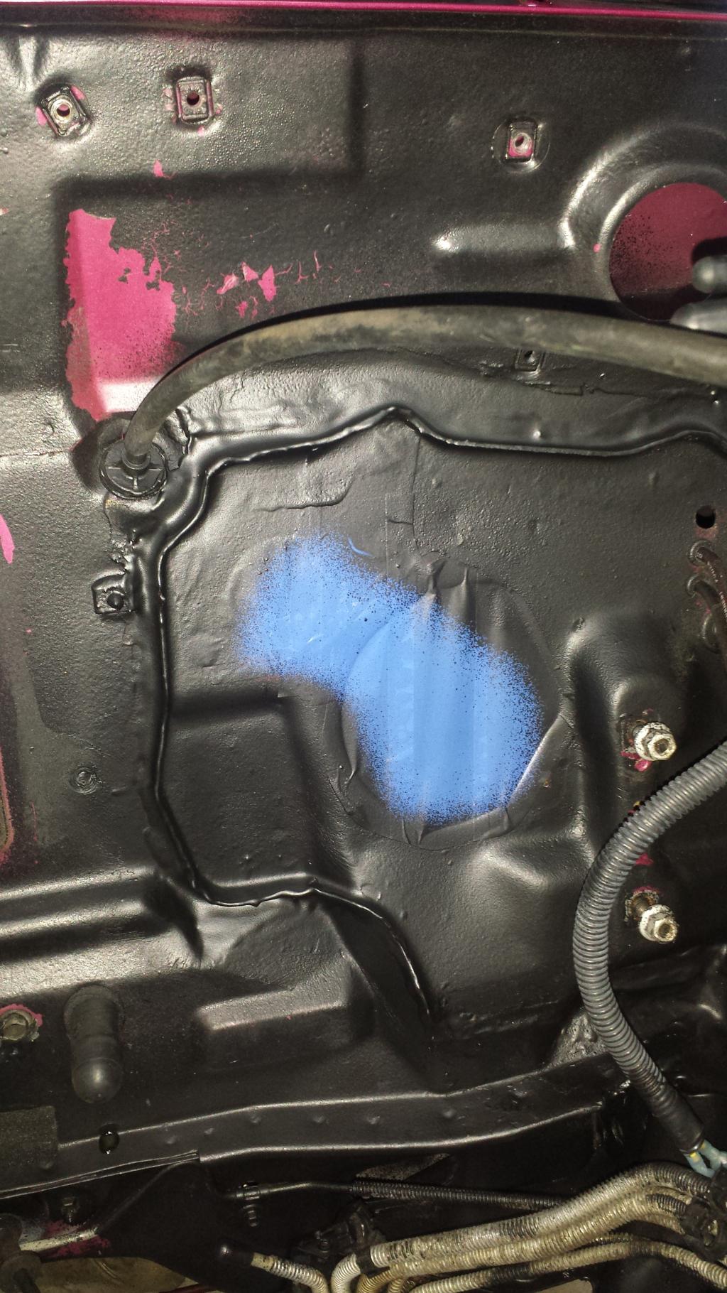

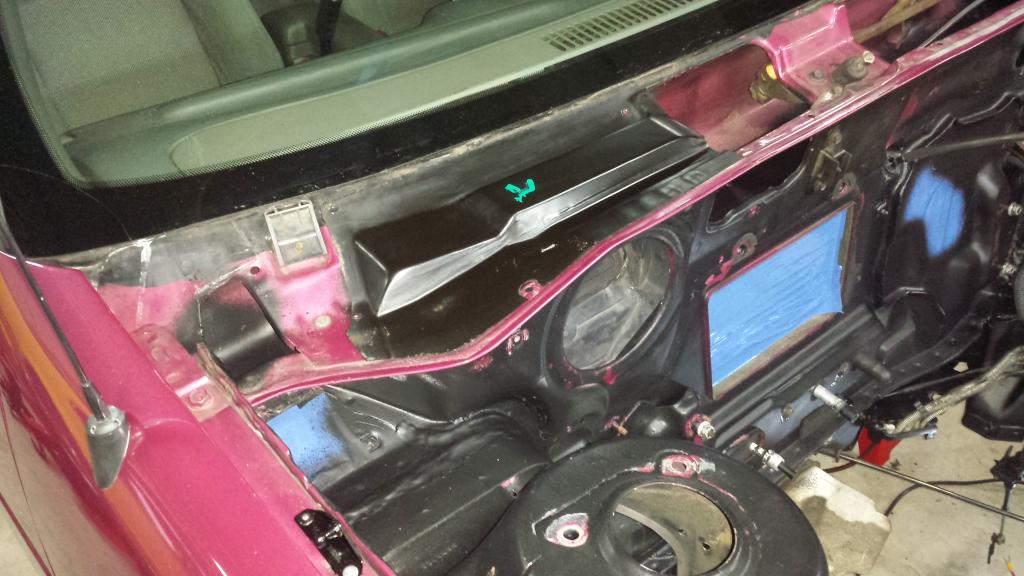

Re: 1996 Mr.Pink

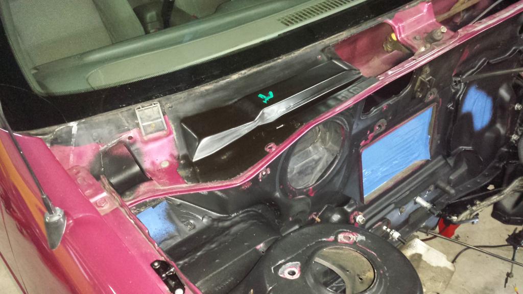

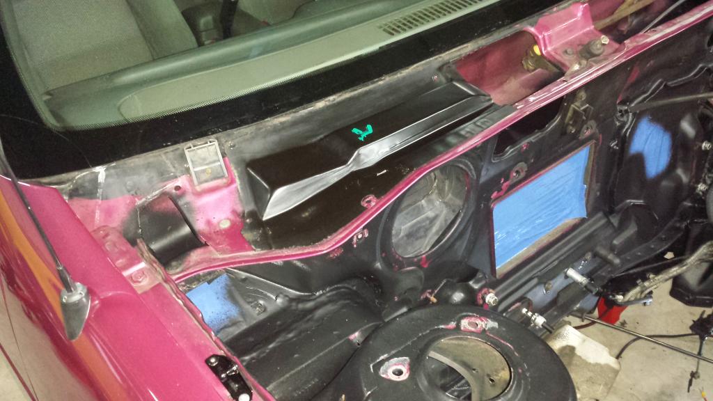

I re-sealed the firewall with the napa sealant, did two thin coats this time so no areas cracked on me. I then sprayed over that coating with the Leak Seal stuff from rustolieum... Seems to work good. That also dried up nicely and didn't stay a tacky mess like some rubberized undercoatings do. I still need to clean up and spray the rest of the bay with the bed liner I got.
Here is the older fresh air vent cover in place as well...
