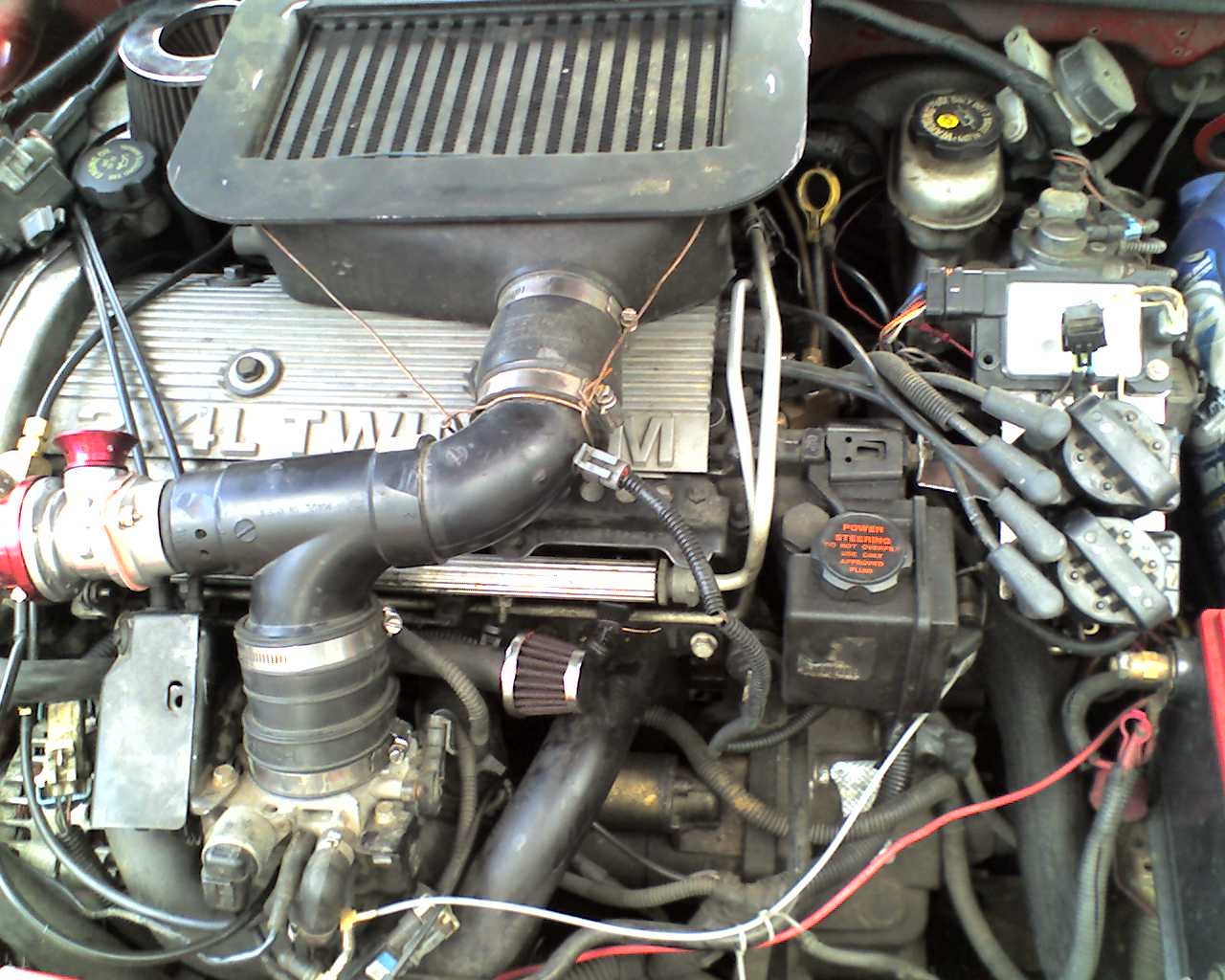

Or you could just turbo-charge your 2.4, it worked for me, and my little '97 Z will totally decimate my '89 Camaro RS 5-speed Police Special 350 car, at least up to highway speeds. In fact, it almost keeps up with my 3800 SC 5-speed GTU up to 80 mph.

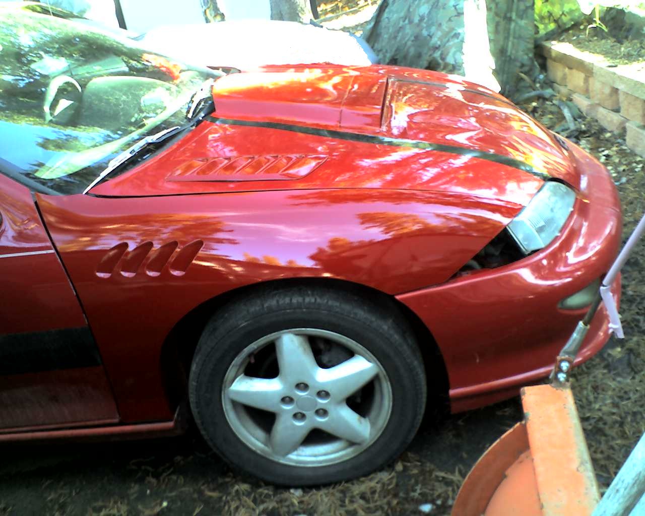

'97 Z-24, notice the fender is the only clean spot on the car, because the steel Z-3 fenders are new!
The intercooler is small, but so is the IHI turbo feeding into it.  It receives cold air directly from the functional hood scoop.
