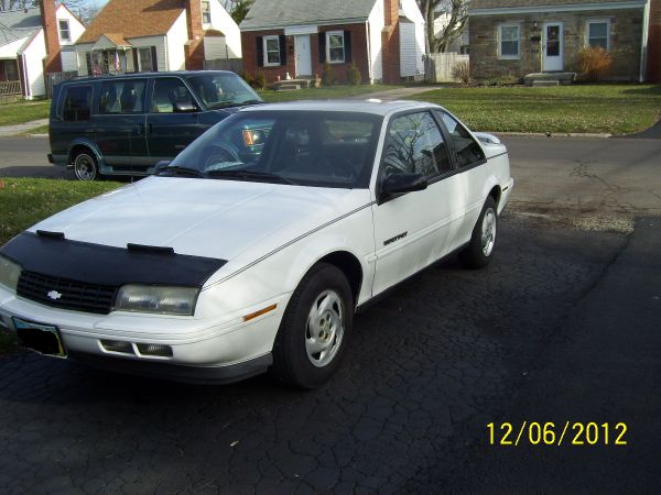

Nice looking car. I assume from your name you have the 2.2 four-cylinder? With that engine and the five-speed, you probably get as good or better MPG than most of the new cars in the dealer lots... I can't tell from the pic for certain, but it looks like someone put "Beretta GT" emblems on your doors. They look good, and the car looks very well kept. Congrats on your first Beretta, I warn you though, they can be addictive.
