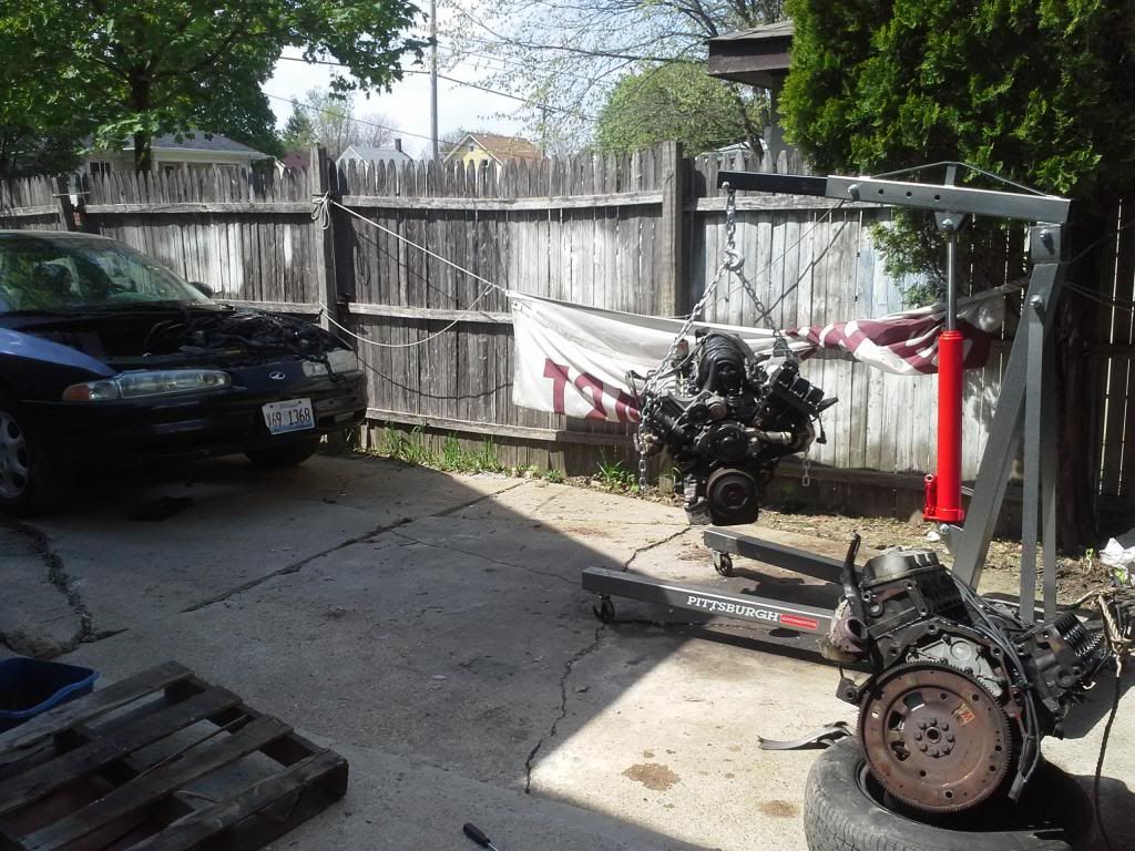

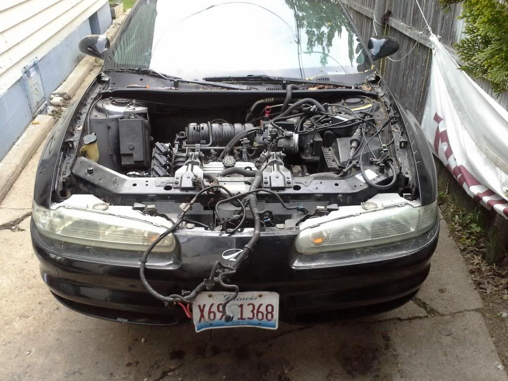

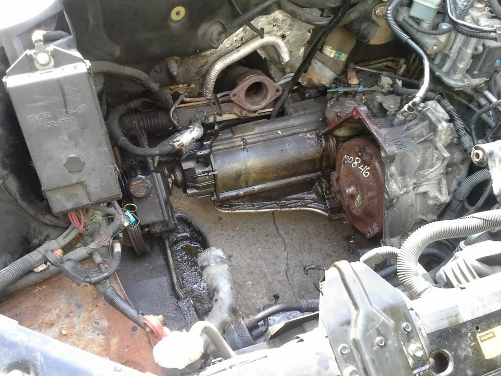

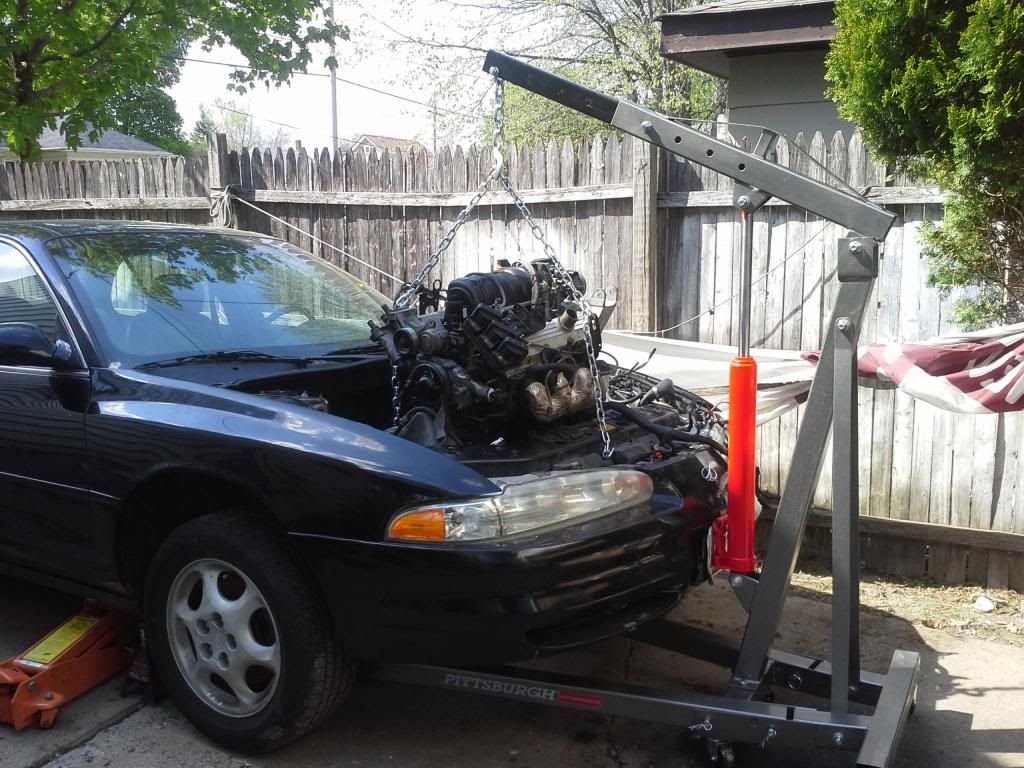

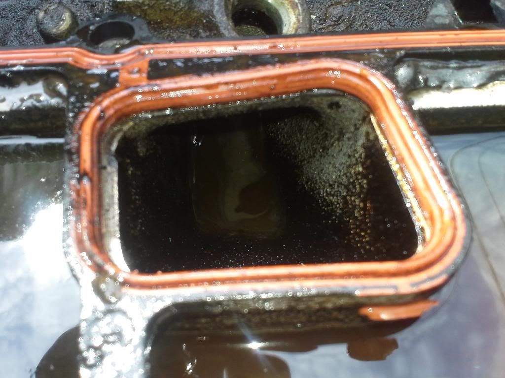

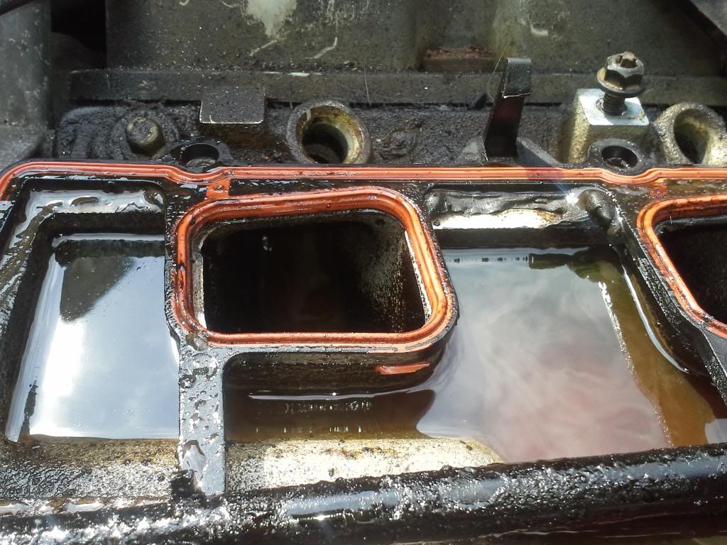

Sooo my brothers olds Intrigue has been out of commission since last october after killing itself during an autocross event. It was his first time out and at one point had the car sideways through the slalom slamming into multiple cones...good times. The notorious issue of the lower intake manifold plenum gasket on the 3800 series 2 gave out, effectively drowning the car in antifreeze. the car got towed home and just sat in the driveway since he doesn't have the funds to see to this issue.....until last week where I decided to fix it up for him as his graduation present. I got a used 91,000 mile motor from a 99 grand prix for a cool 500 bucks and decided to do the swap myself. At a leisurely pace, it's taken me a week to complete and it for the most part. it's in there, the wires and lines are all connected, and all that's left is to fill the fluids and put in some aluminum gaskets that won't fail like the oem ones. The original engine isn't hydro-locked and i managed to get the fluid out of the cylinders as with draining the contaminated oil. I figure I can freshen up this block...for my beretta! jk, but seriously, these 90 degree engines are cake to work on and actually this little project was quite fun.

I would STRONGLY recommend using conventional green/gold long-life antifreeze in that engine, NOT the Death-Cool crap -that might have a lot to do with why your original gaskets failed (that and the fact that GM just can't seem to understand that PLASTIC is not a good material for internal engine gaskets :fool: ...) .
