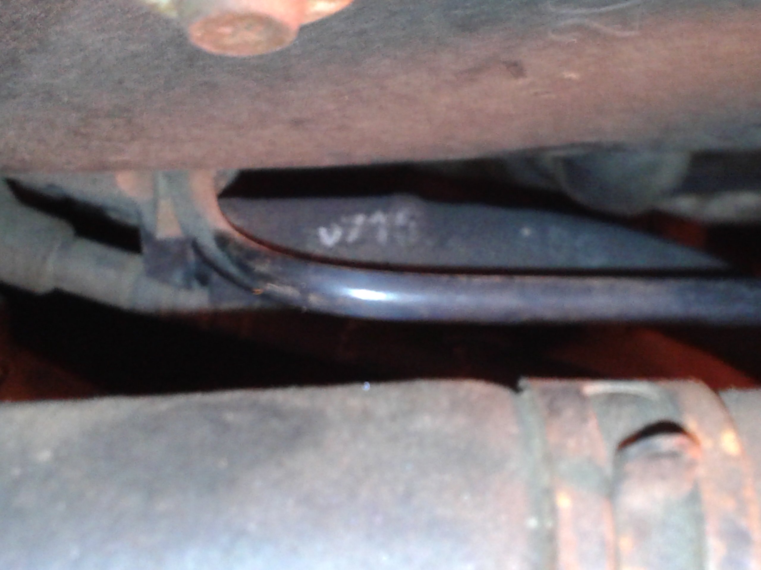

Update on my earlier post that's not approved yet.
I tried taking the hose off the back of the manifold, which I assume is the one you're talking about (photo included) and plugged it. This didn't change the idle, but instead made the car run rough, so I put the hose back on.
After turning the ignition on and off a few times, without starting, the car decided it was done idling high and now it went back to the earlier 'rough' idle. Instead of idling about the usual 600RPMs, it idles at 350~ which eventually causes it to stall. I decided to take it down the highway for a little bit and the back to see if it cleared this up (which is needed for the new IAC). It still idled rough after bringing it home, but after shutting it off, the fan was no longer constantly running. Starting it back up about two minutes later, the idle condition is still the same, about 350 RPMs, stalls, only the fan runs all the time again. I let it sit for 20 minutes and it still did it.
When I was turning the ignition on and off (without starting it), the engine light only flashed on and didn't stay on (about a half a second). One of the times the engine light stayed on, but after turning it off and on it went away. The engine light hasn't stayed on any of the times this has happened. My brother said it flashed on and off really quickly a week ago when he was driving it, but that stopped after about a half a minute.

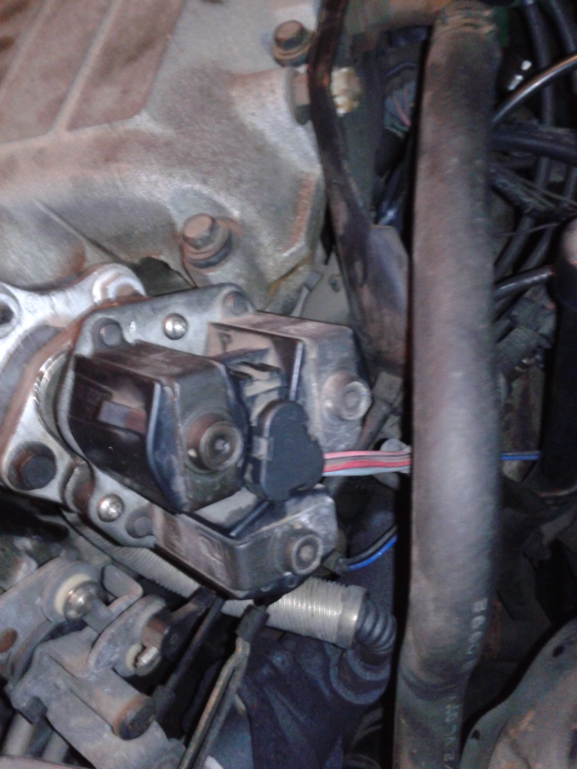

Some other things worth noting:
While my brother was driving it on the highway a week ago (when this all started happening), he said the speedometer started working for about 3 minutes again and stopped at that time. This was also the drive when the flash engine light went on and off really fast for about 30 seconds.
My brother in all his infinite knowledge tried adjusting the idle screw for the engine to fix it. It apparently didn't change anything and he said he set it back to where it was before adjusting it, but that could be wrong and the cause for the rough idle if the IAC is now fixed.
The EGR valve I cleaned I may not have put solenoids on the right direction (I took the whole thing apart). I have included photos. If you guys could, please take a look and let me know if it's on the right direction. While the valve itself is slotted, the solenoids are not so they can be rotated without the right valves being in the right spot on the valve. I put it back with the flat edge facing the flat part of the valve, which I assume was the right way.
