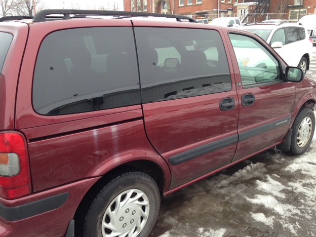

Well an update on this, whatever injector stuck/broke seems fine now
it must have known, but in more exciting news
Re: Rich smelly and farty - part 2 saga continues
3X00 donor van?
Nicey nice nice
