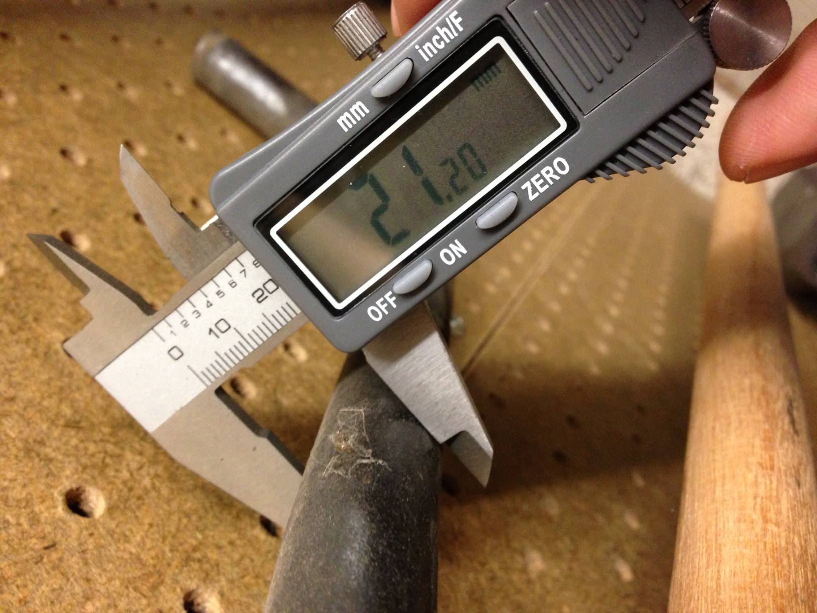

I'm pretty sure the Z51 bar was 21MM and the hollow non-Z51 bar was 19MM, but I'll measure when I get home and confirm.

Just Calaford Maizie 51 solid swaybar and it is nearly 21mm thick (.815")

I just went out and measured my solid Z51 bar, and it is indeed 21MM as I remembered. The hollow bars are 19MM stock. I was pretty sure it was 21MM, cuz I knew the Addco one was around the same size and I didn't understand why people would go with that vs. the Z51 since they were almost the same and the Z51 could be had for a fraction of the cost.

crap hope my 19mm ones fit

Addco bar is 1" for the rear... not 3/4 so thats 25.4mm, another good reason to go to that over Z51... I knew it was bigger than the factory bar but I guess I was stuck on 19mm being the largest there was.
Slinky wrote:crap hope my 19mm ones fit
they will probably be tight but should be able to fit them... if not you have the ability to bore them to 20mm... Don't go to exactly 21, you don't want it loose.
