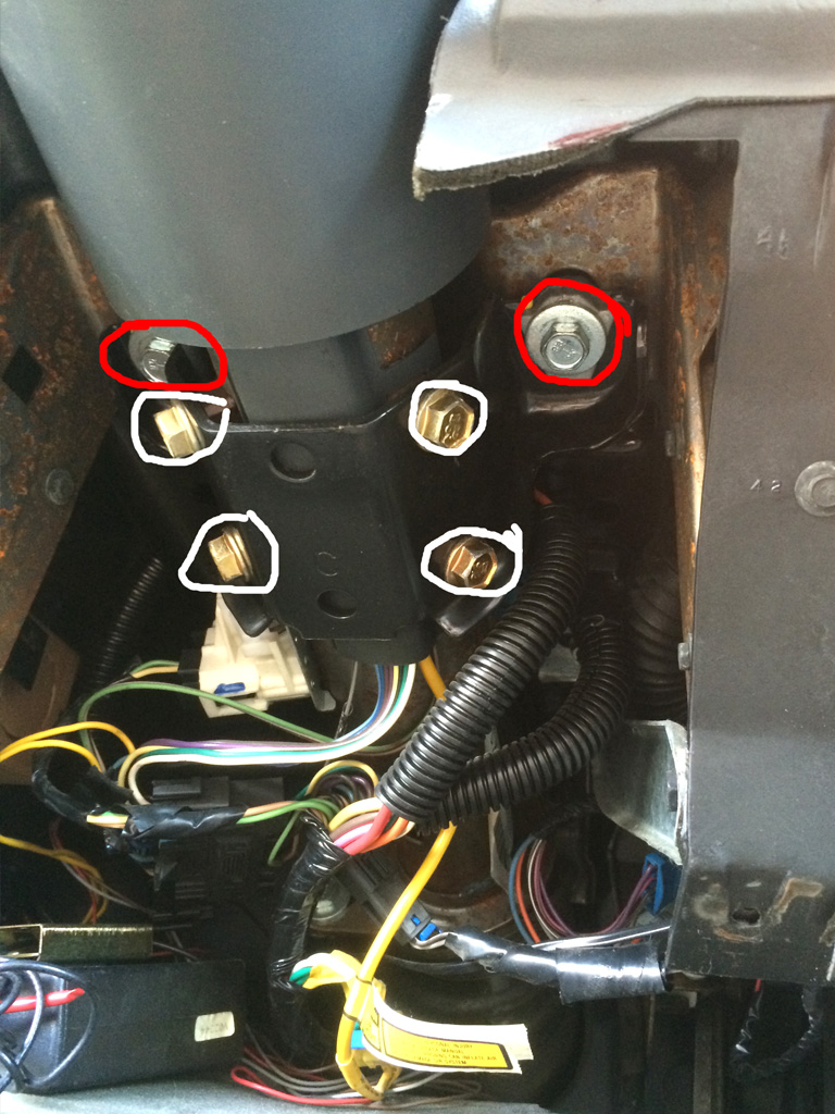

Finally I had some inspiration or what ever to take a photo...
So this is it under covers. Which bolts (red or white) I should remove? Or all of them or something else? ._.
I haven't removed it already 'cause I didn't wanna do it outside the garage (weather is a problem). If my plans won't change, I can do it next week. Also, is there something else I should note when dropping it down?

Re: How to remove the steering wheel with airbag?
The switch Woody described is the white one on the left of the steering column actually.
Loosen the bolts / screws and pull the switch forwards more, then tighten it back up. You should regain your ability to use your brights if this switch was moved back too bar.
I've done this on a '93 Century before, pretty easy fix.

removing just the red circled bolts should drop the steering column, it will still be attached by the U joint at the end and it will just hang down some. You should be able to see the high beam switch when you do this as well as adjust it from there.

Yeah I managed to adjust that thing. It was easy once I managed to loosen the two bolts, it was pretty easy. I didn't have to touch on the steering column thing after all.
Biggest problem was getting my hands, some light and tools to turn those damn things. Not much room to do anything there.
