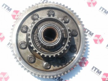

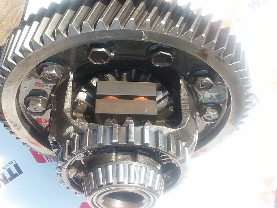

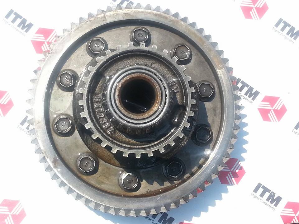

Engineered performance LSD for the getrag 282. Fresh full rebuild by jeff at ep, it was fully rebuilt with shimmed springs. This might be the strongest lsd that was ever in a beretta. Very street friendly. I had about 500 miles on this, did one auto cross with it in the rain. Performed great! Then my clutch died, along with 4 wheel bearings.. so im doing something a little different with my car now. I have no use for this now..
This comes as a complete unit. Bearings included. The diff is the stronger 92? Style. It was purchased from jeff. It has only seen redline MTL with lsd additive since the rebuild. Stock v6 gearing.
$550 and its yours. Shipped to the US. $600 for Canada.
