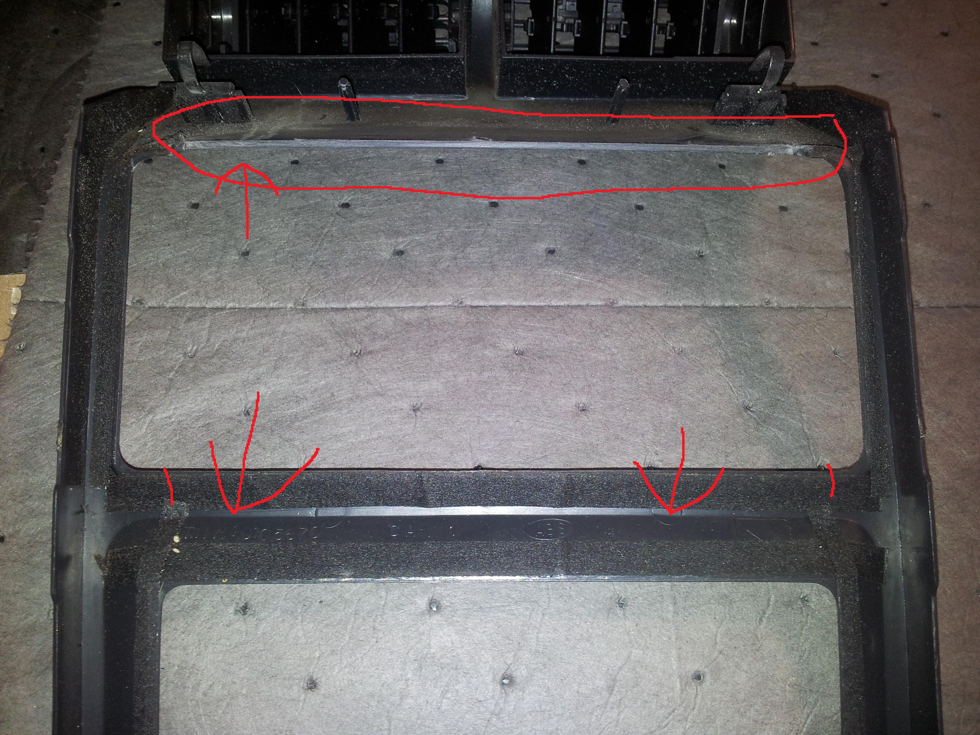

though as most of us know the radio opening in the dash is big enough to accommodate a double din radio, but the trim plate is only a din and 1/2 opening. so whats a guy or gal to do. here is what i did. after removing the face/trim plate. i had to figure out the centering of the radio to the face plate. best way i saw was to have the new radio in and see were i would need to trim. which i marked in this pic. <br />i trimmed the excess at the upper and lower ribs of the trim plate. now granted this wont be the same for all radios. this is just my experience.

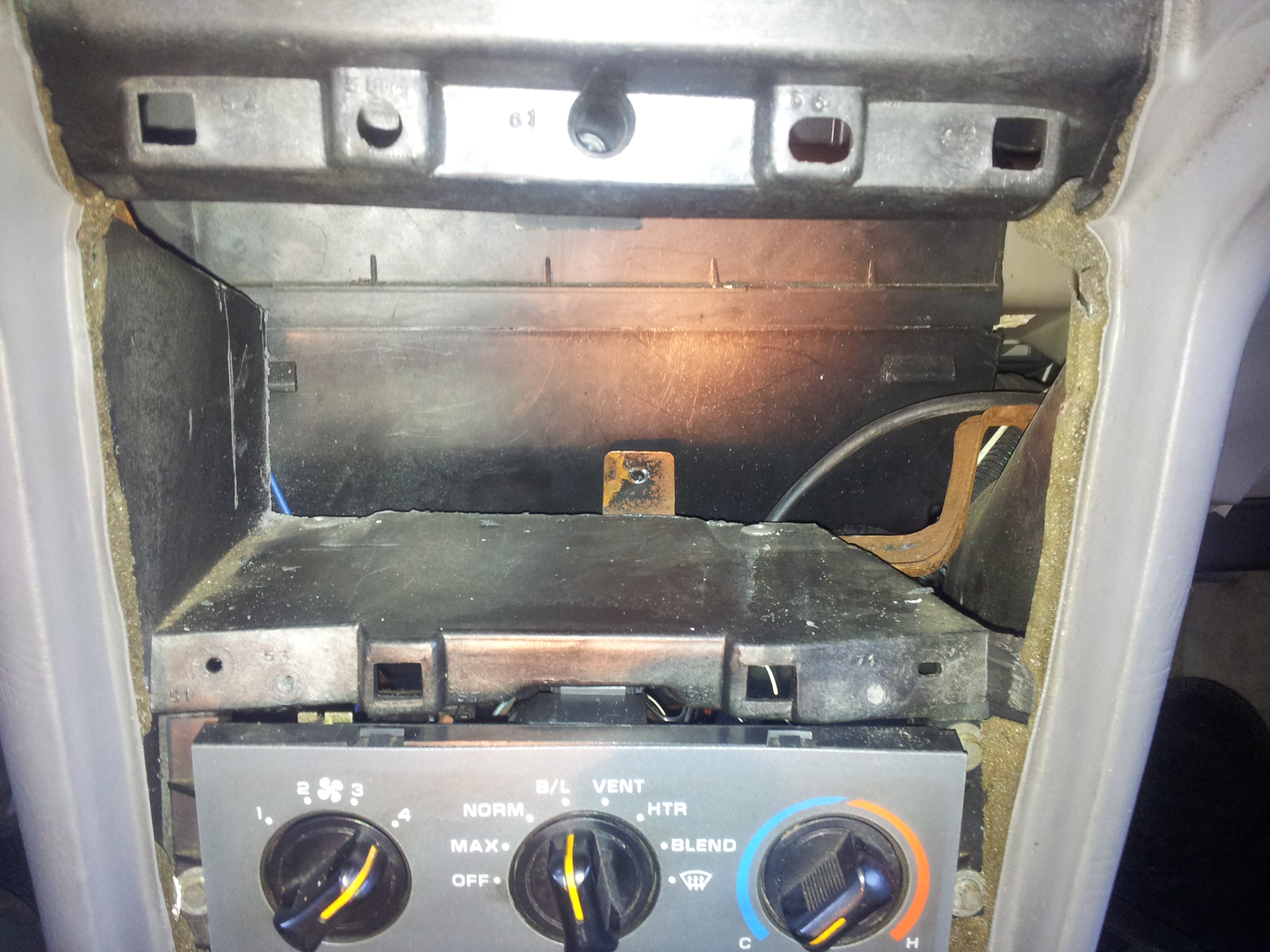

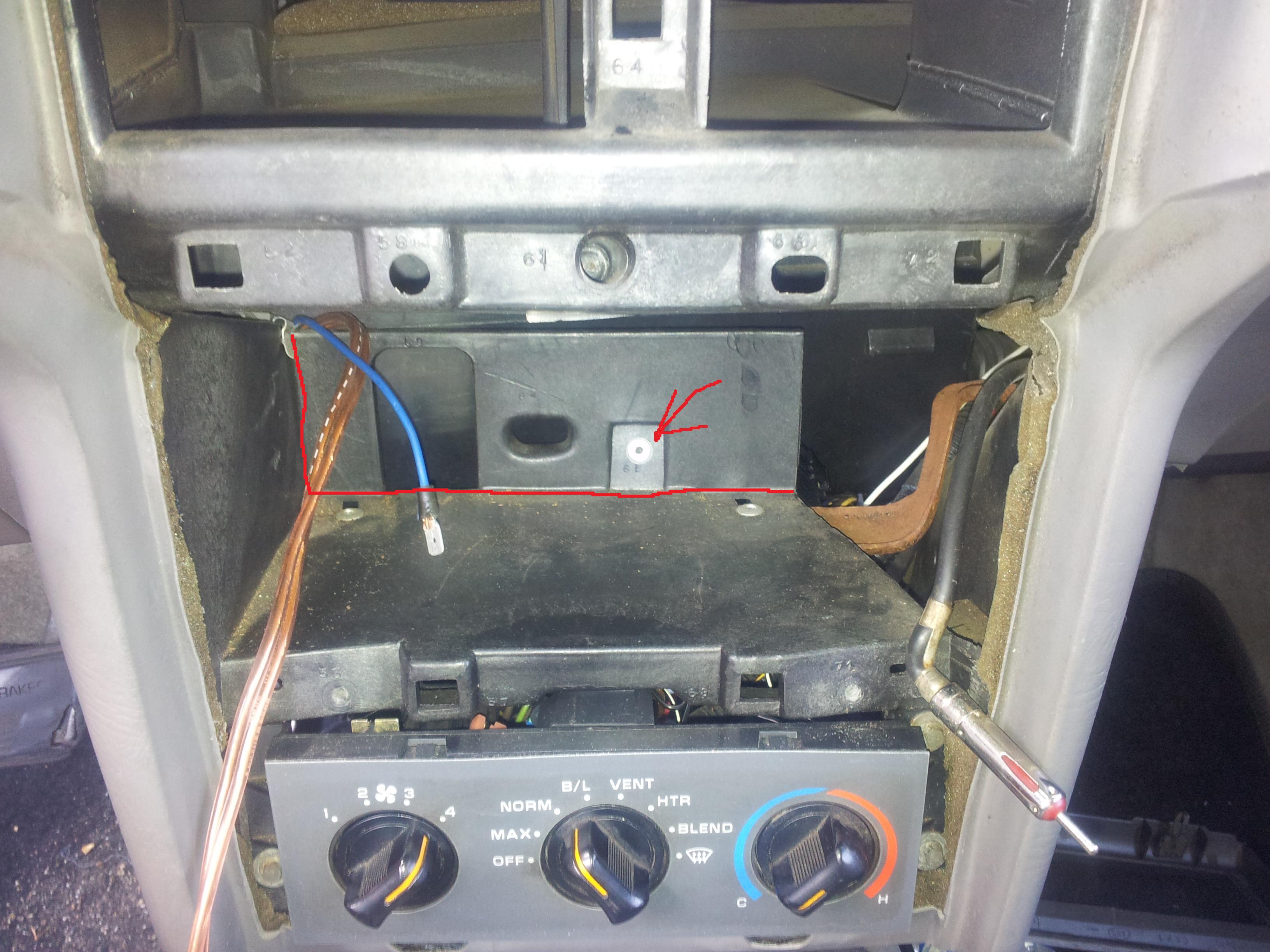

next thing i had to tackle was the depth of the opening. yes i had not done this next step all the years  i have had this beretta. <br />first was to drill the rivet head off at the back of the opening (see red arrow)
once that was accomplished i used my rotary tool with cutting disk to zip along as close to the back edge of the opening as possible and then do the same across the side wall. i was able to get far enough back i did'nt need to worry about the rivets on the bottom of the opening at the back.

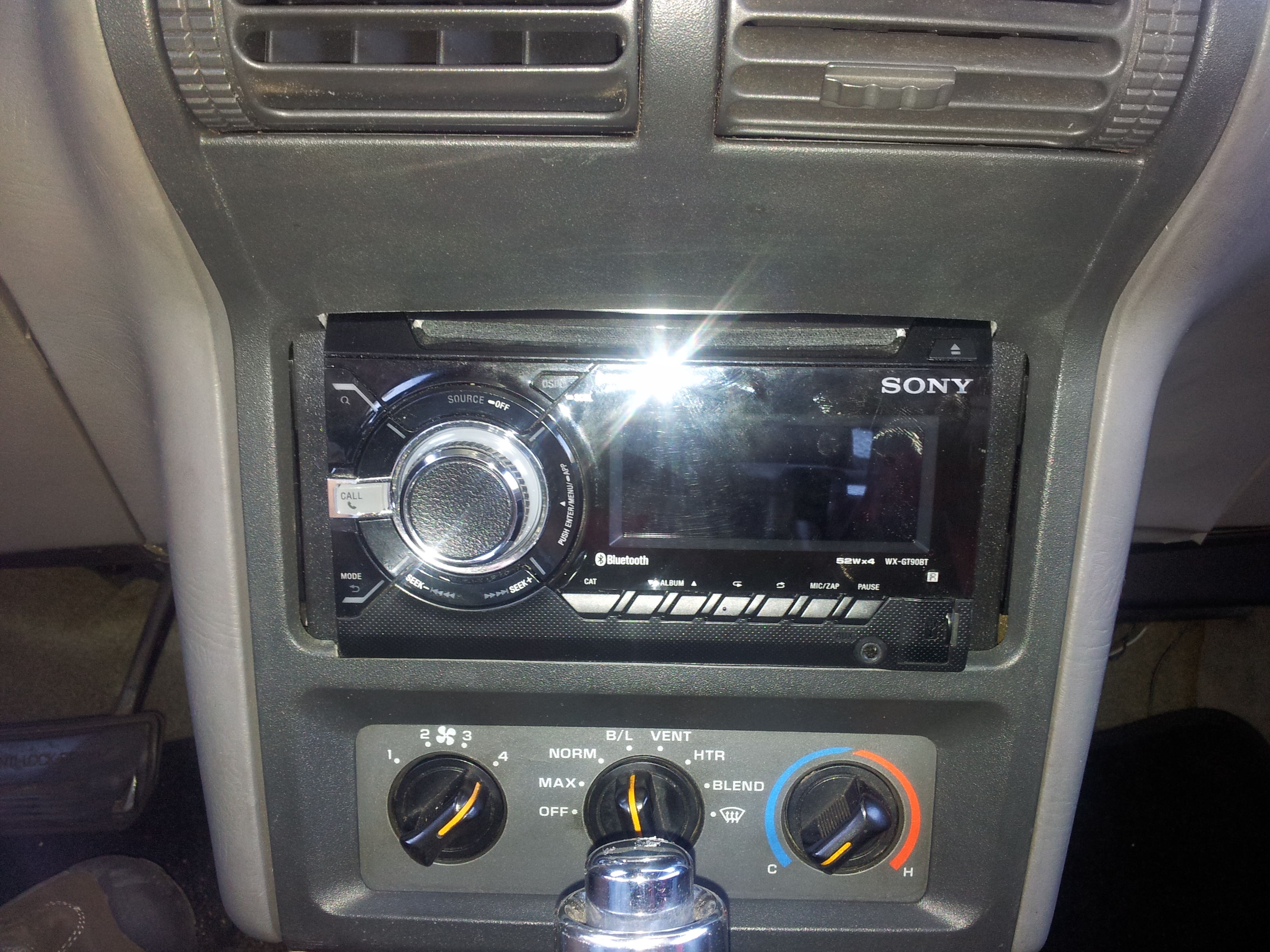

with that being accomplished and my trim plate also finished i was ready to install.
it looks a little cleaner than the last pic. i did go back and clean up the top more. but it fit very nicely and so far works like a charm.
