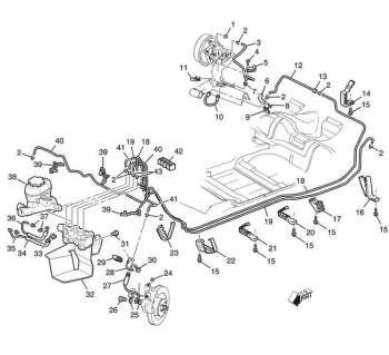

Knowing full well this is a beretta group, I am hoping someone has access to this information. I never imagined it would be this hard to find.
Have a 2003 Cavalier without ABS, in the process of replacing the rear brake lines. As this car has had a number of lines changed, I would like to verify that they are all in the right order before bleeding the system.
Looking for a simple diagram showing where the brake pipes go into the master cylinder, IE the distribution order
like:
RR LR RF LF
I have tried just about every google query I can come up with, and searched the jbody site. Called the dealer, checked with parts, also searched GMs dealership service website.
Would appreciate any help with this!

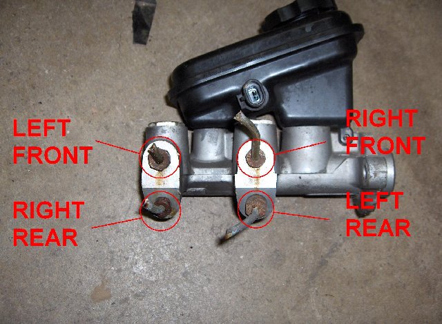

Re: Random Cavalier brake line question
Yes Asylums master isn't correct for this year of car I beleive that's the older one
If you could post it on jbody that would be fantastic !
Here is a picture !
Does this help?

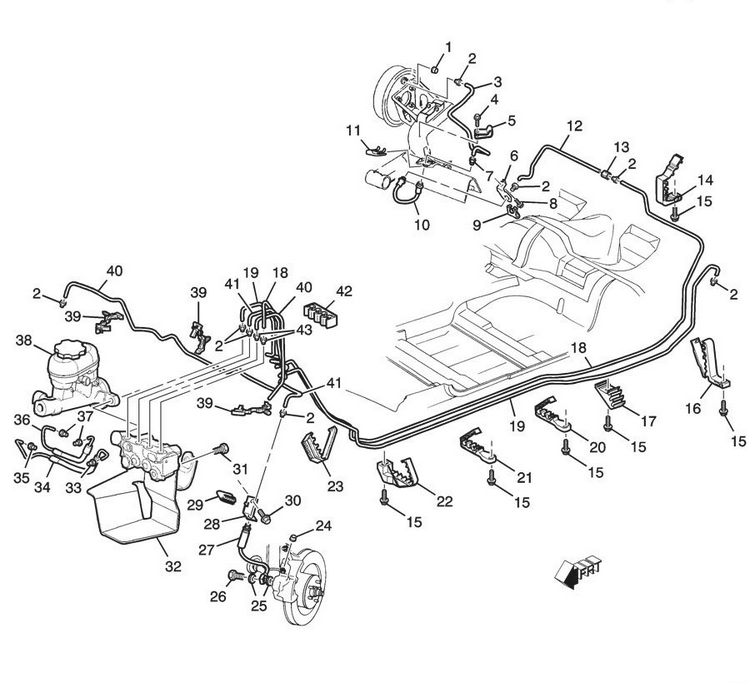

Sorry it doesn't help. I can't really tell where each line is going I got the same parts diagram from the dealership. But thanks for trying, this is been challenging and I never thought it would be.
Starting from passenger going to driver:
19 41 40 18
18 & 19 feed the rears.
18 pass rear
19 drivers rear
40 & 41 front feed the fronts.
41 drivers
40 pass front

1988GTU wrote:Starting from passenger going to driver:
19 41 40 18
18 pass rear
19 drivers rear
41 drivers
40 pass front
That is the best I could find as well.

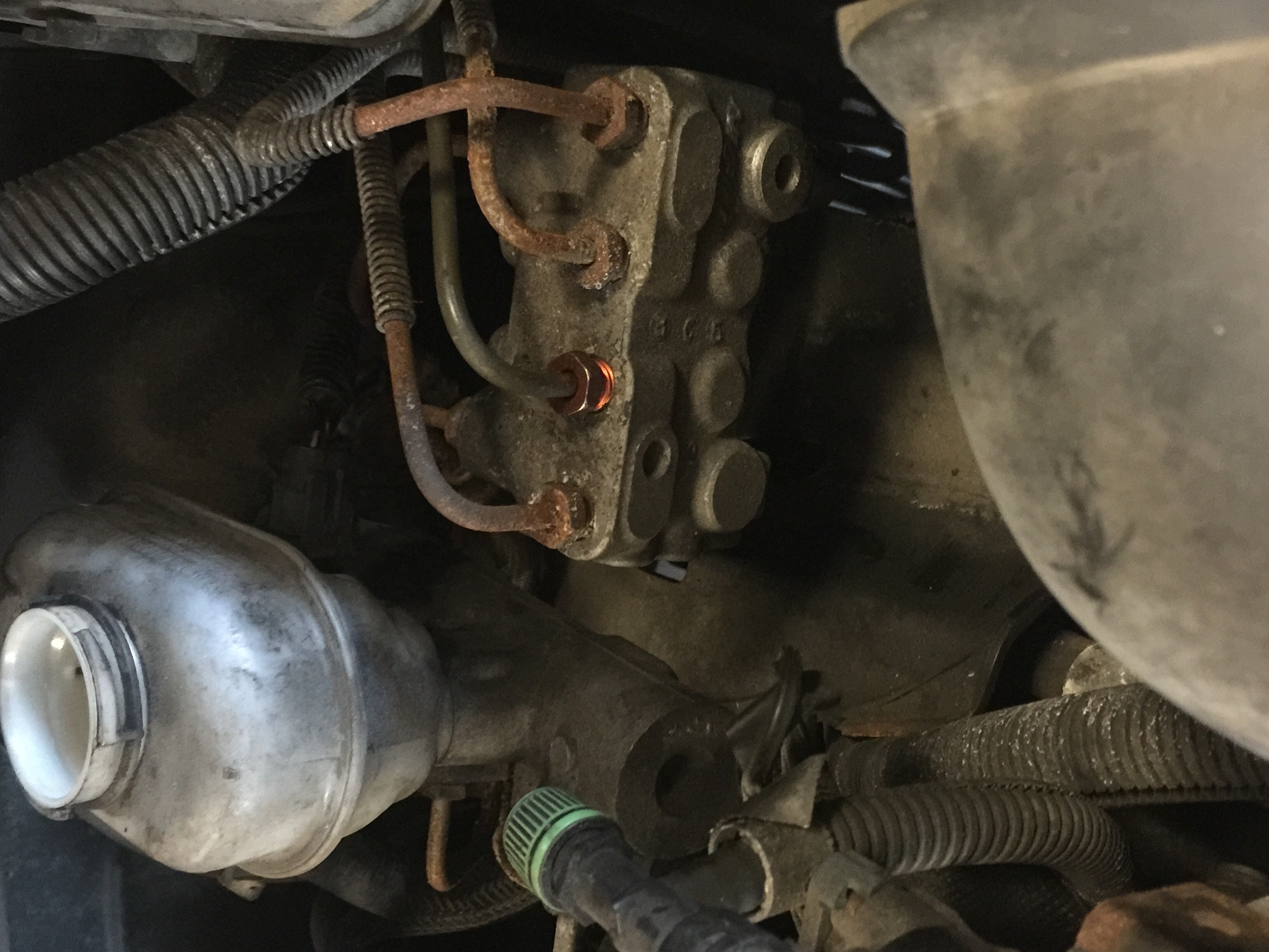

04 2.2 non abs
I will try my best to verify in the morning the lines on this car are toasted it's hard to tell
