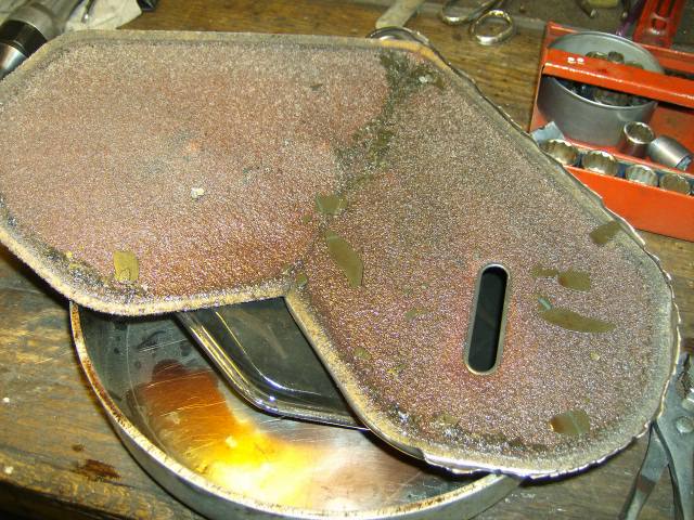

I got a JY trans which was supposed to be good. They are supposed to take out the filter
so I'd have to put in a new one. They left the filter in, so I cut it apart to see how it looked inside.
Those are flakes of what looks like friction discs. So much for getting a good trans from a jy.

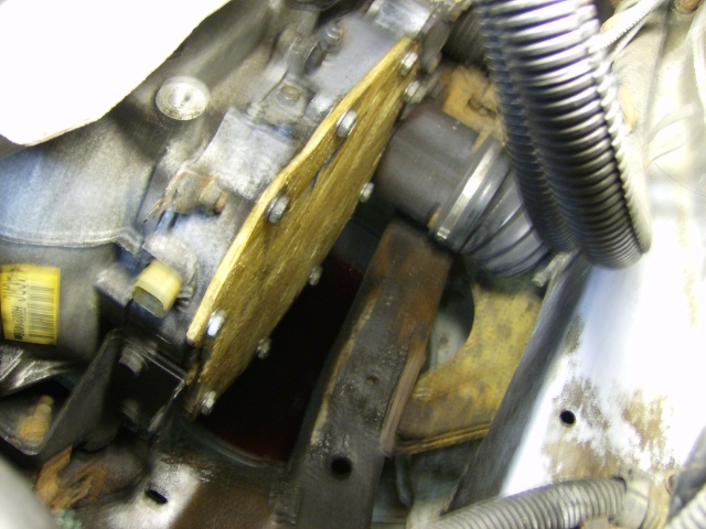

On the Lumina van, the valve body cover stuck out too far.
I removed it and made a cover plate of wood to protect the mating surface.
I think with it removed, I have plenty of room to drop it out the bottom.

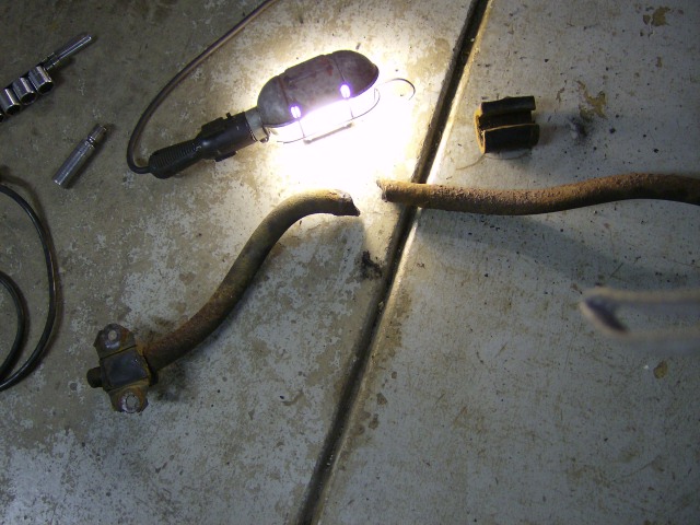

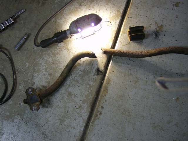

Got the stabilizer bar off, uh oh I wonder if a weld would hold?
I never noticed any excessive sway but then it's a mini van I didn't expect
it to handle very well. When I bought it, the passenger side ball joint had been
replaced and I got the impression somebody hit a pothole so maybe it's been broke
all this time.
Re: Whats the differences in 3t40/125c transaxles???
No you can not weld spring steel, or at least if you do it will break almost instantly at the same spot when torsion is put against the swaybar.
Posts: 668
Post by ifixalot »
Yeah, I agree, after posting that, I read up on the subject and I found a used one on Evilbay and ordered it.
$55 shipped.
