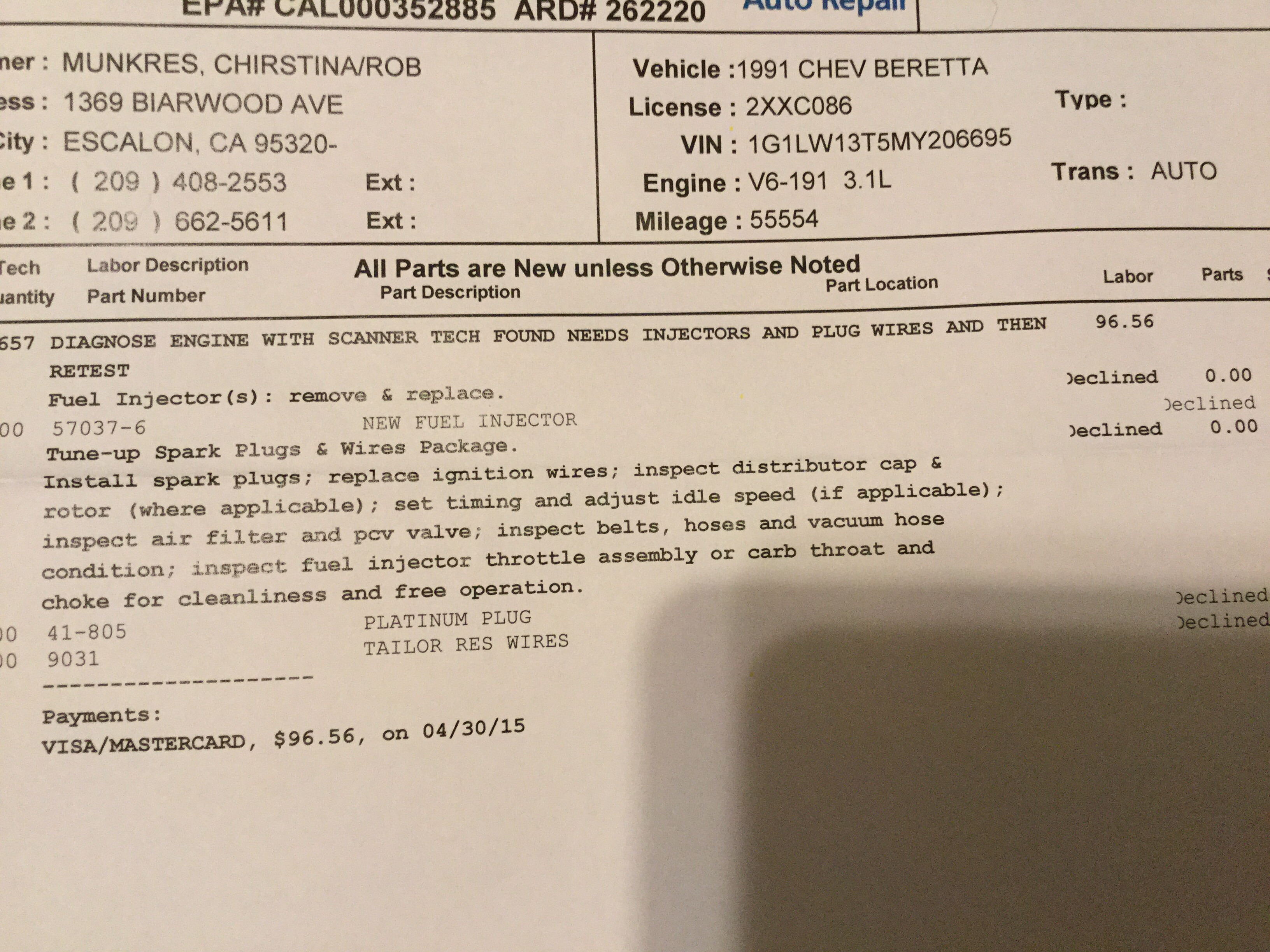

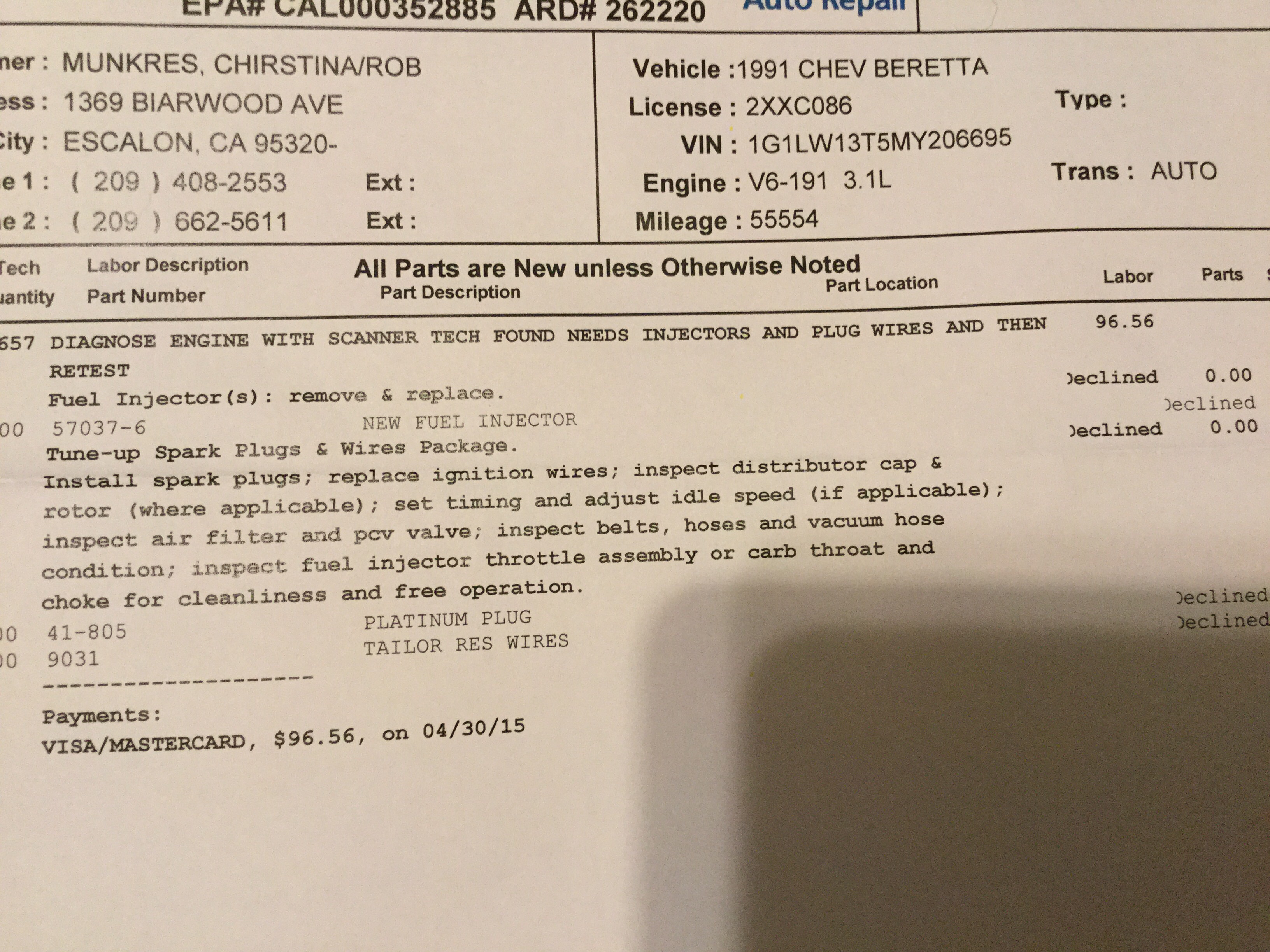

Ok, so my beretta was having problems with power loss on acceleration, rough idle when warm, and wouldn't go past 3000 rpms sometimes. I ended up taking her into Midas for an under the hood inspection and was told 4 of the 6 injectors were bad and should replace all of them. Here's a pic of my actual receipt. Idk what under the hood means to other people but when they told me under the hood inspection I assumed they would actually be inspecting things....
as you can see I stupidly paid them $100 to hook her up to a scanner thing.

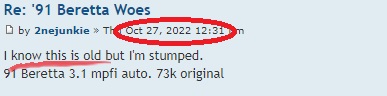

You do know you're responding to a post that's 7 years old, right? ;)
Posts: 1850
Re: '91 Beretta Woes
Styluss wrote:You do know you're responding to a post that's 7 years old, right? ;)
Who, me? :unknown: Look above, "2nejunkie" dredged this up, as it appears he is having similar problems. His post was Oct 27th, 2022, THIS YEAR, unless I slept-in too long?? :lol:
