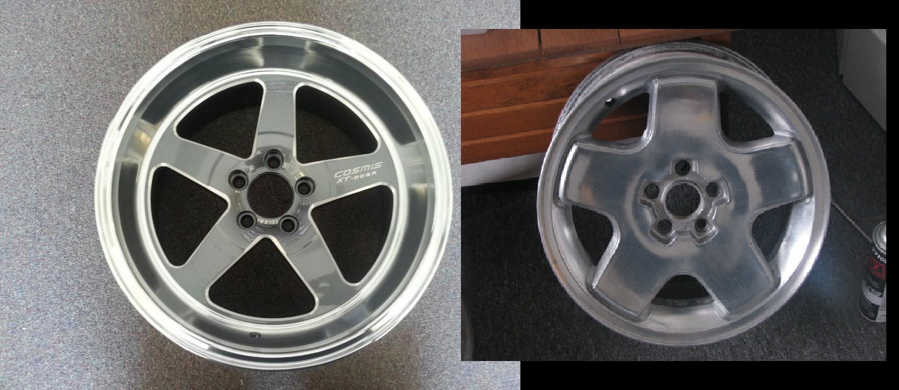

Yup, those are the exact wheels...... sooooooooo pretty! I know they will physically "fit" - and yes, I realize they will probably rub without some fender lip modification. However, what I'm after is avoiding the goofy look of the front wheels sticking out too far past the front fenders. Damnit, I wish this wheel was 8" wide, not 9". It just sucks that all of the modern wheels available are either too large in diameter or too aggressively offset to fit properly.
I'm still eager to see/explore if it is possible to get these to sit a little closer in the wheel well.

Figure as much... i think theyd look phenomenal on our cars if they can be made to fit within the fenders.
[edit] You mean to tell me you see no similarities here between those two wheels? C'mon man... Look at those empty triangles between the spokes. Aside from the dish and some modern touches, I think they share some nice similarities.
