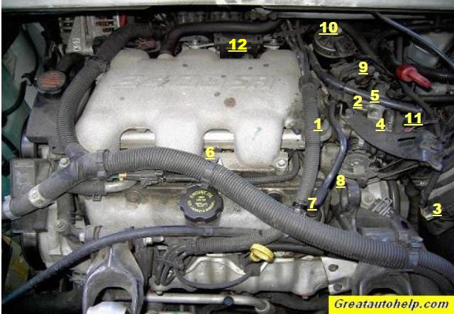

This is a 3400 but most sensors are in roughly the same locations and it gives you an idea on the the FPR and Injectors.
1. Fuel pressure regulator
2. Idle Air Control Motor (IAC)
3. Mass Airflow sensor (MAF)
4. Throttle Body
5. Throttle Position Sensor (TPS)
6. Fuel Injector
7. PCV Valve
8. Coolant Temp sensor (ECT)
9. Evap Purge Solenoid
10. Egr Valve
11. Intake Air Temp Sensor (IAT)
12. MAP sensor
and a crappy youtube howto on replacing injectors on a 3x00 type engine. I'd save that for the last thing tho... very rarely do they stick open. I betting on a cracked O2 sensor, or bad temp sensor.
https://www.youtube.com/watch?v=lpVY3t-o0yY
