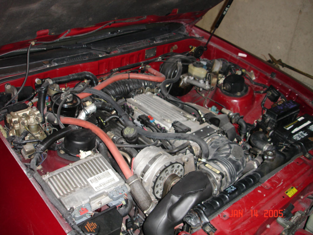

The other car is an MKIII Supra non turbo. 5 speed manual with a "sport package" which includes an 8" 4.30 rear end with 4 pinion 1.5 way lsd, TEMS Toyota Electronically Modulated Suspension and most importantly head light squirters.
A friend gave it to me because he lost interest in it. I actually got to drive it about 15 years ago when he bought it. Its sat along time now though and the motor might even be locked up.
I would like to do a budget swap on the Supra first and kind of learn on this car. I want to get a T56 and possibly a truck block but I want to make sure im not adding weight. These cars are fat ladies to begin with. An ls1 would cost more but could save me money in the long run as the intake manifold and oil pan would clear everything from the get go. I could do a trans adapter plate but the W58 annoys me. They don't have a first gear syncro and they wont hold a lot of power Im told. Eventually Ill pull the motor and trans and sell them off. If I could get it running first the 200hp 7M-GE is worth decent money...

I doubt the LS would add much weight to the MK3, in fact it might be LESS weight if you go with an alloy block.
The F-Body LT1 was very similar in weight to the 7M-GTE. This was swapped when having an LS1 would've been a small fortune.
