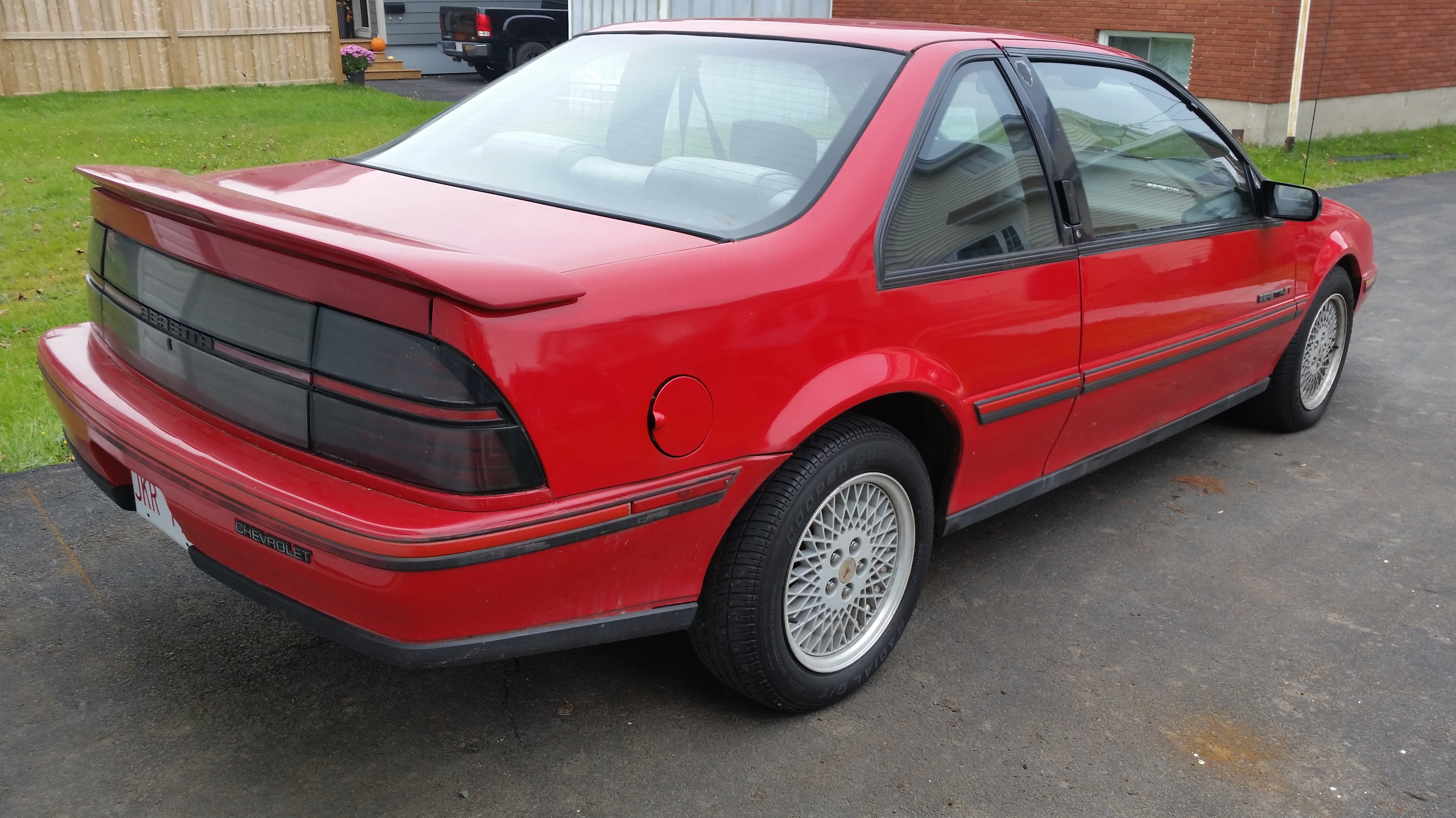

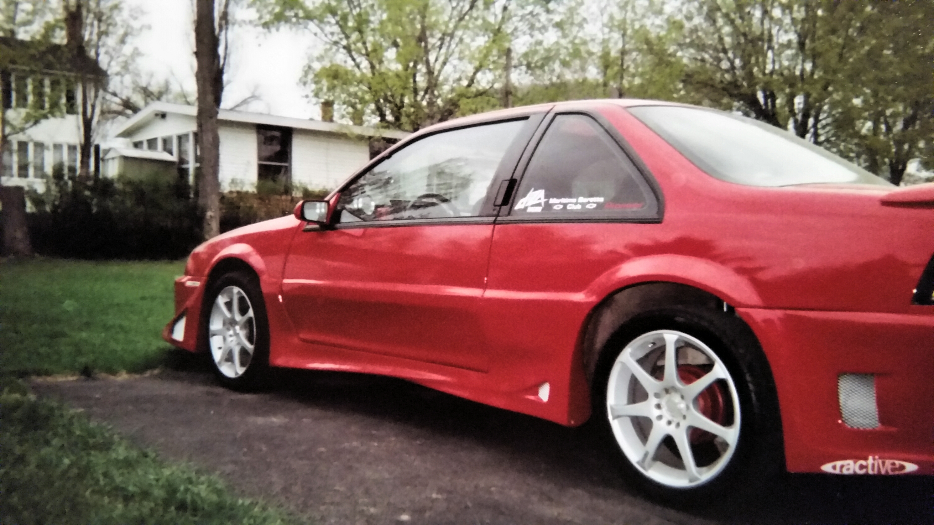

I sold my first beretta over ten years ago and i always told myself i would get another one someday. So a few months ago i picked up a 1990 GT. Not sure if anyone remembers my original beretta it was a 1988 GT with a diza body kit.

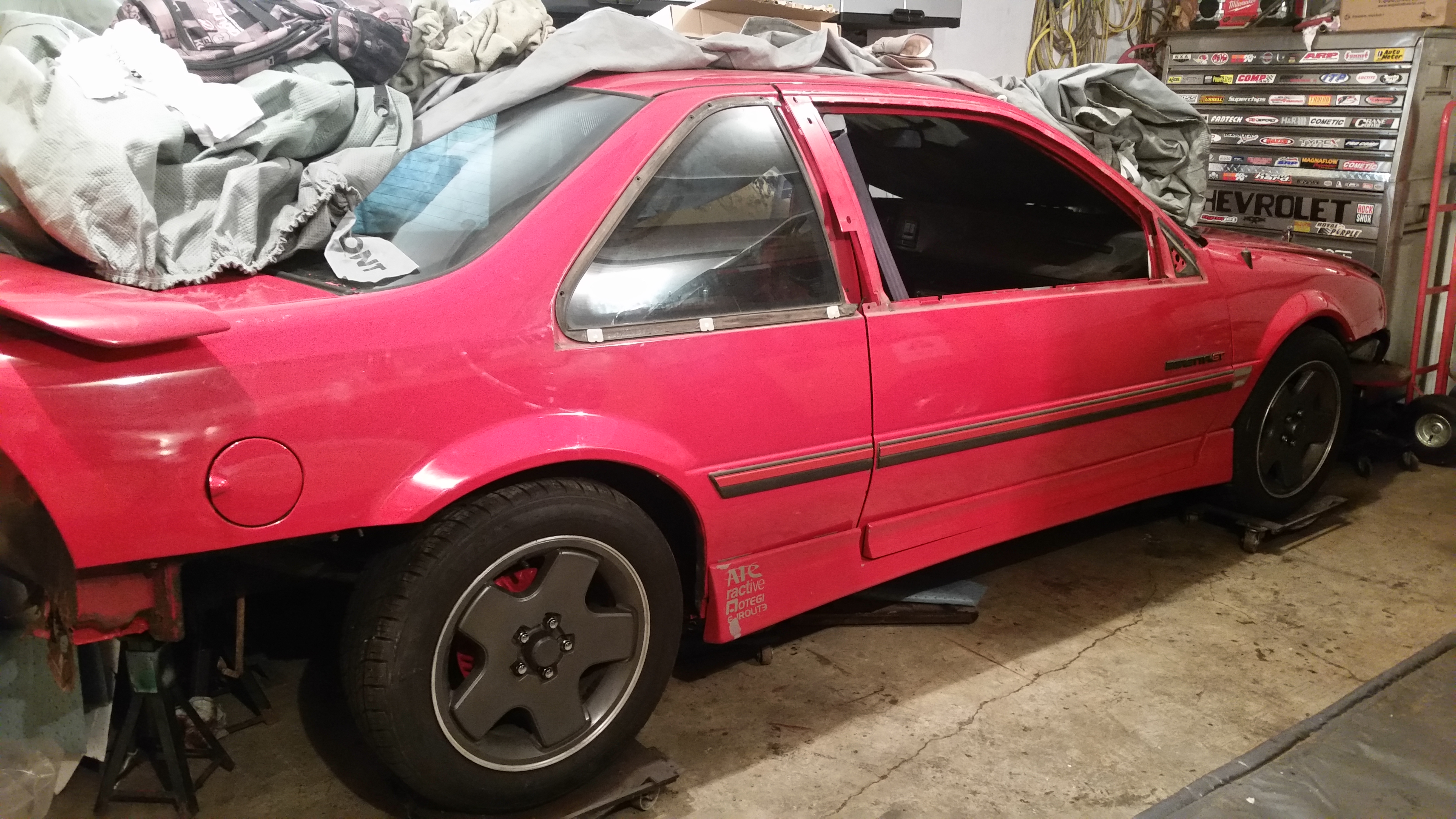

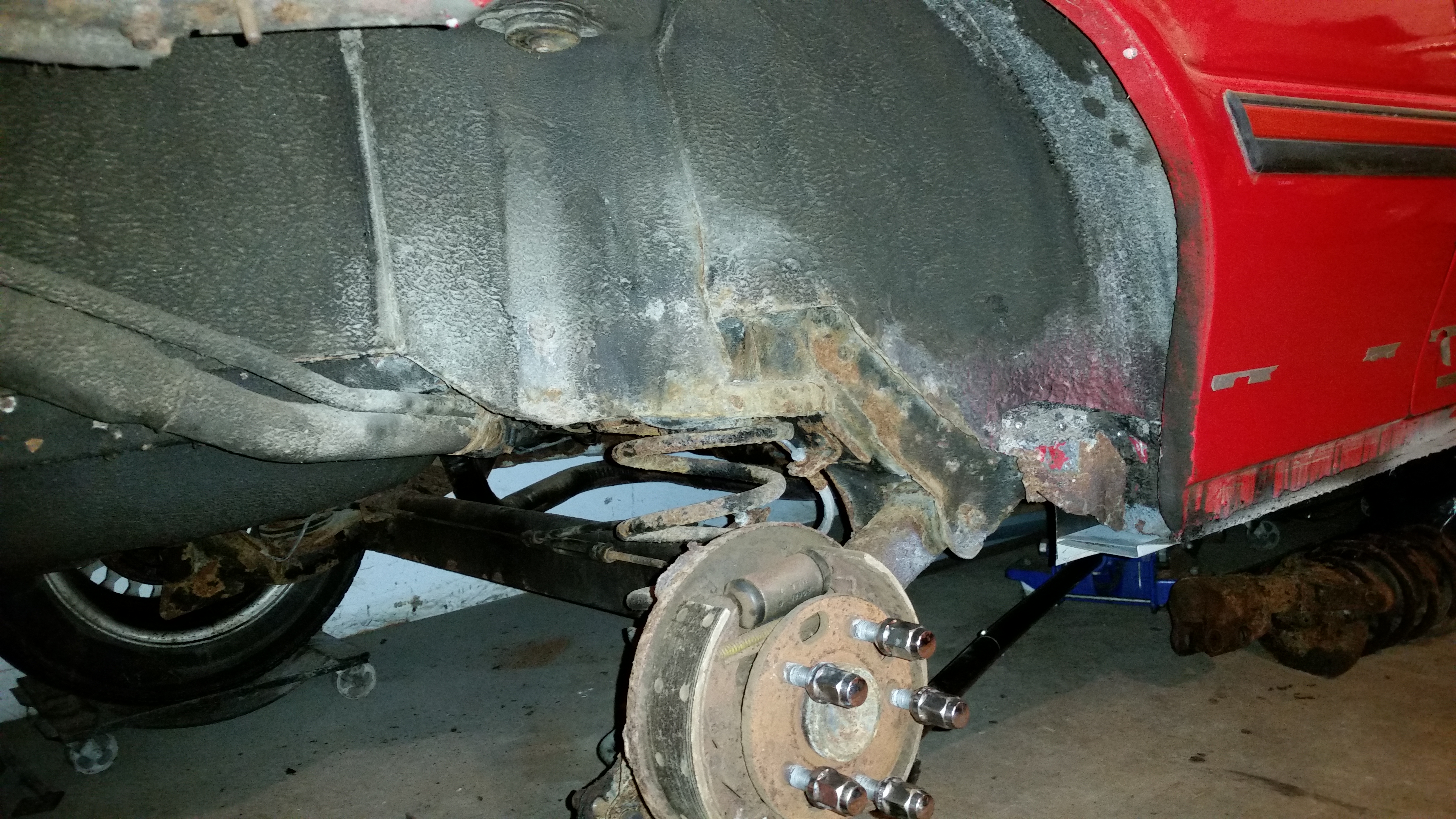

A few pics of were i'm at with the car. Waiting on a few parts to come in before i start to reassemble

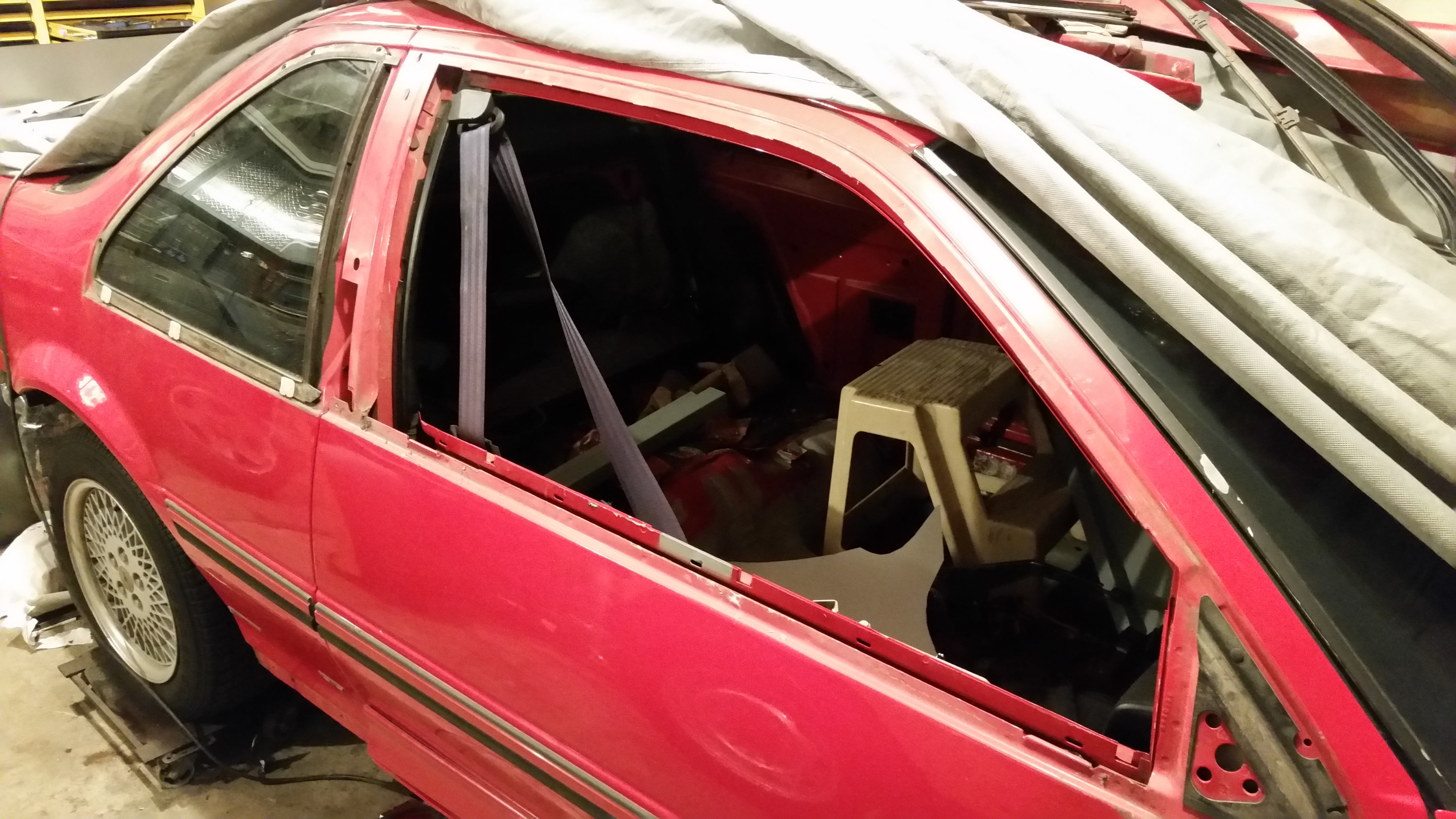

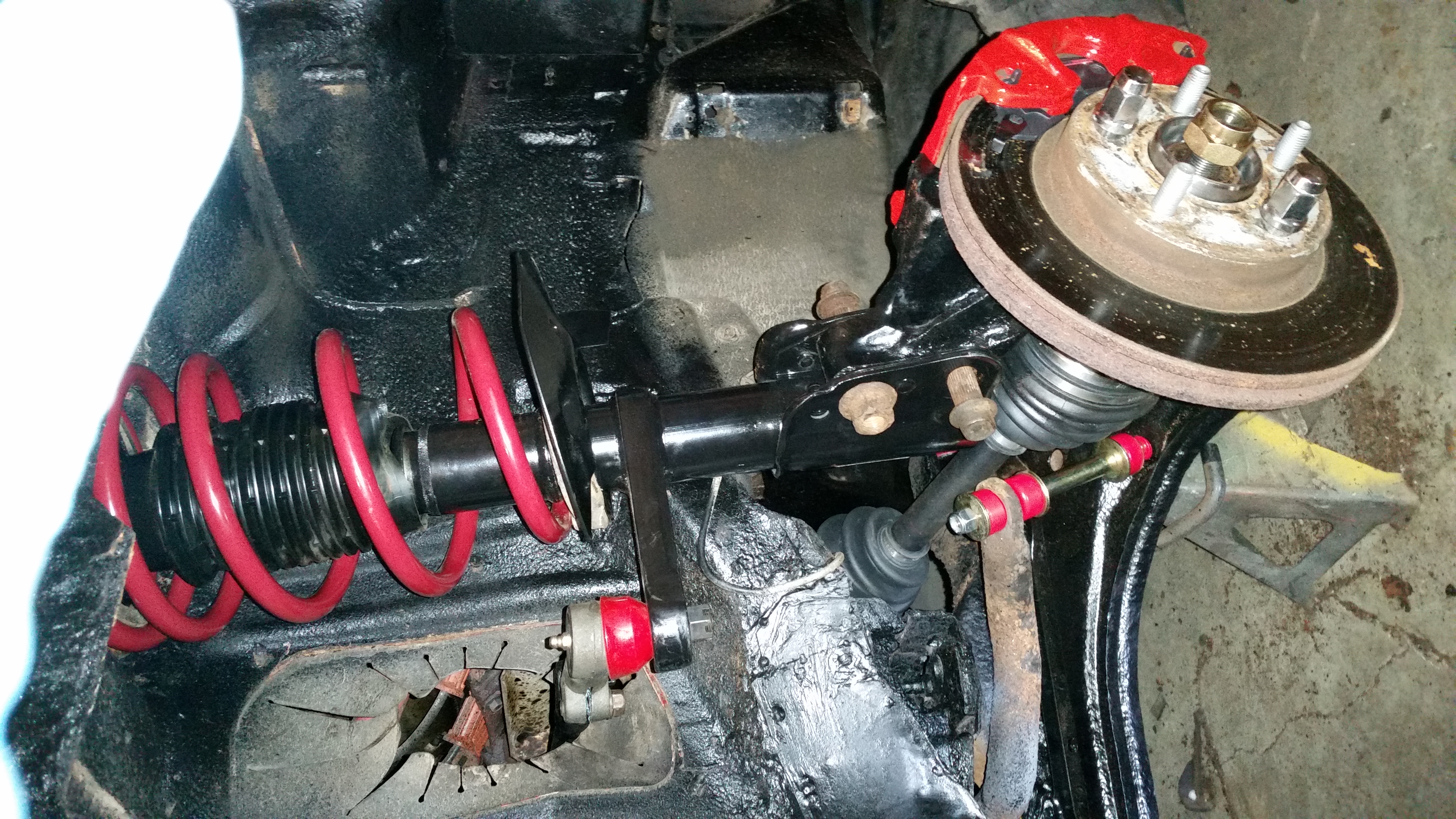

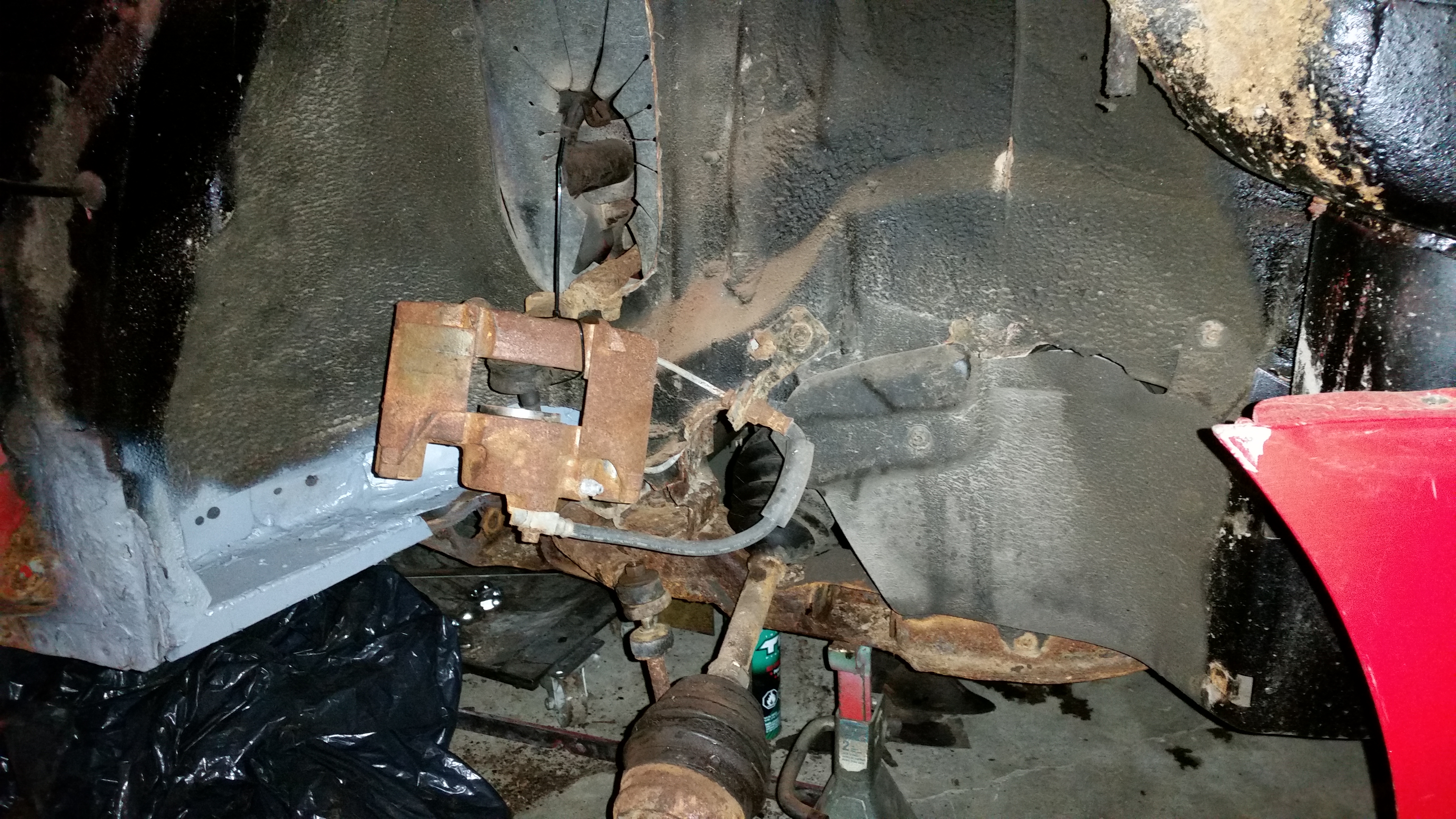

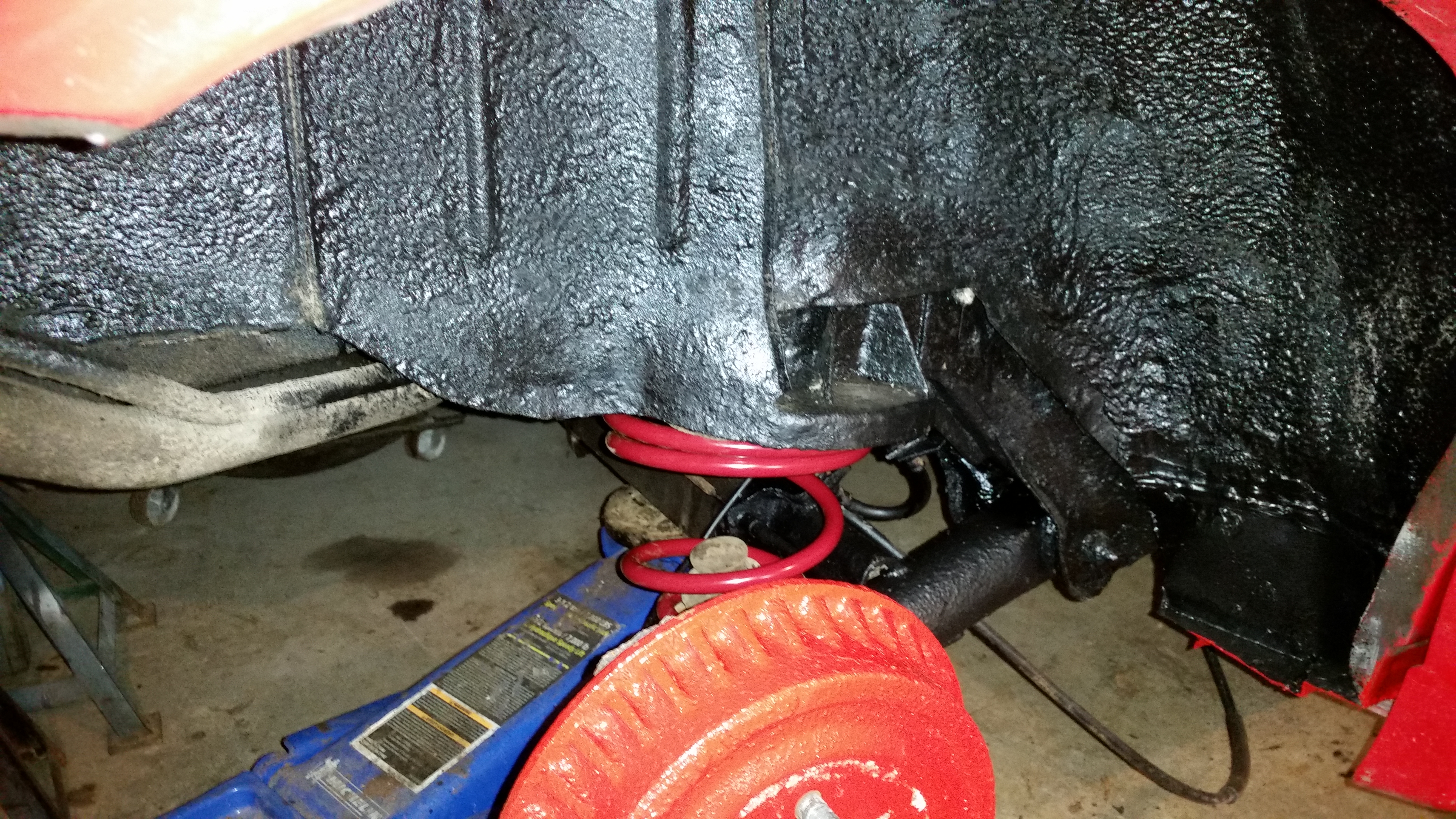

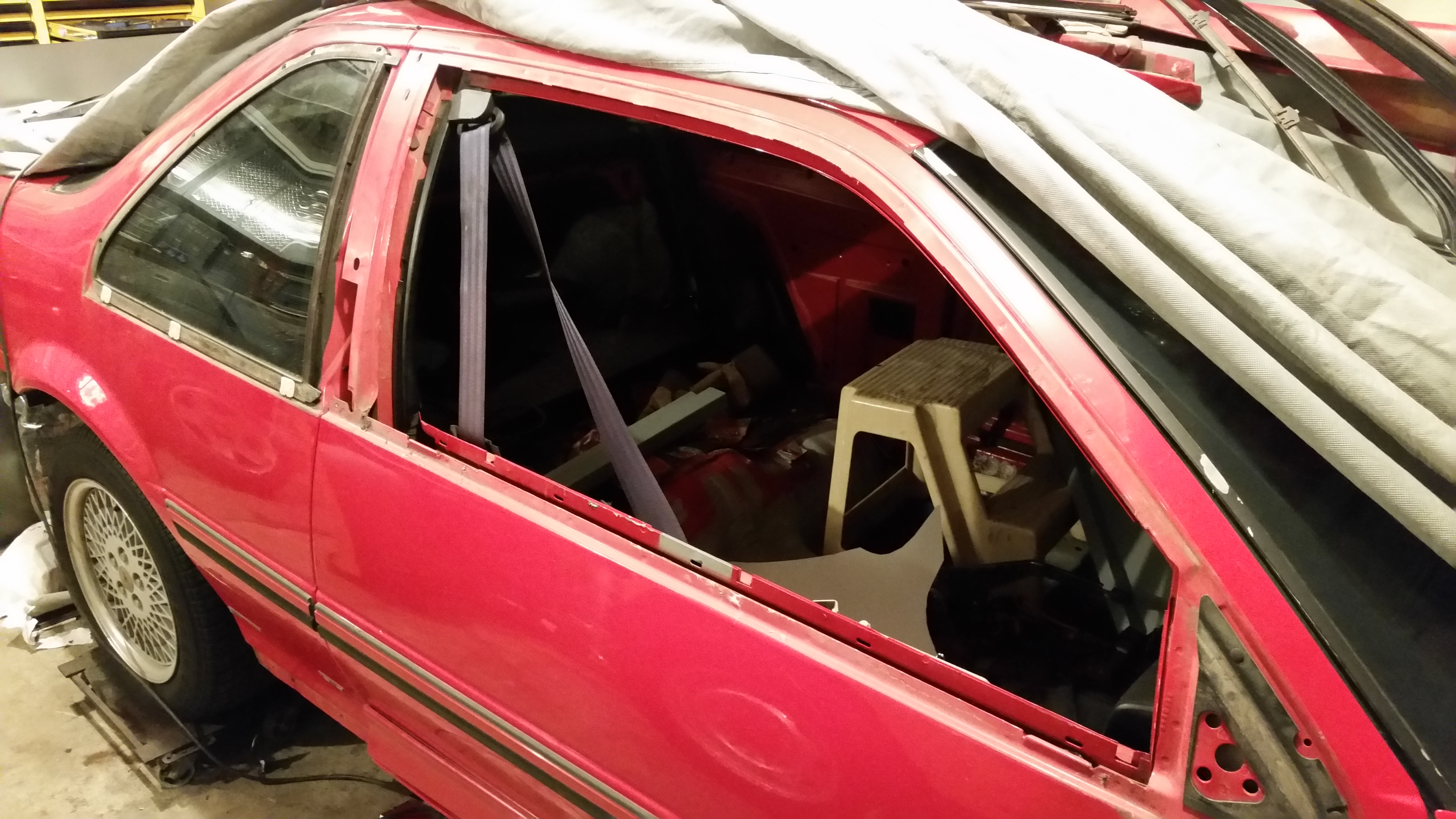

I few progress pics for anyone that wants to follow my build. Passenger side rocker and floor are fixed as well as the suspension. Working on the driver side rocker and floor. I will keep posting pics as i make progress.

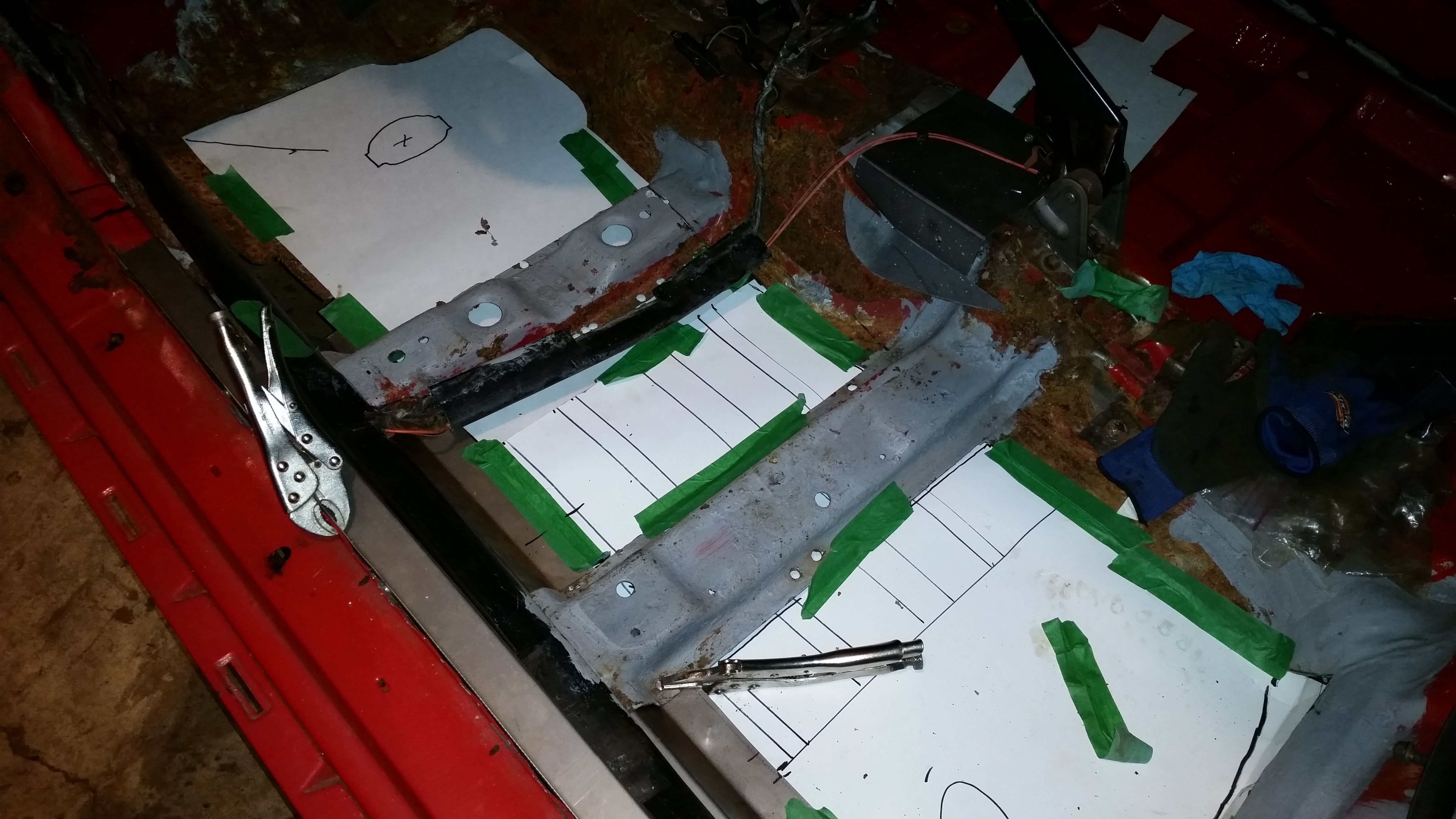

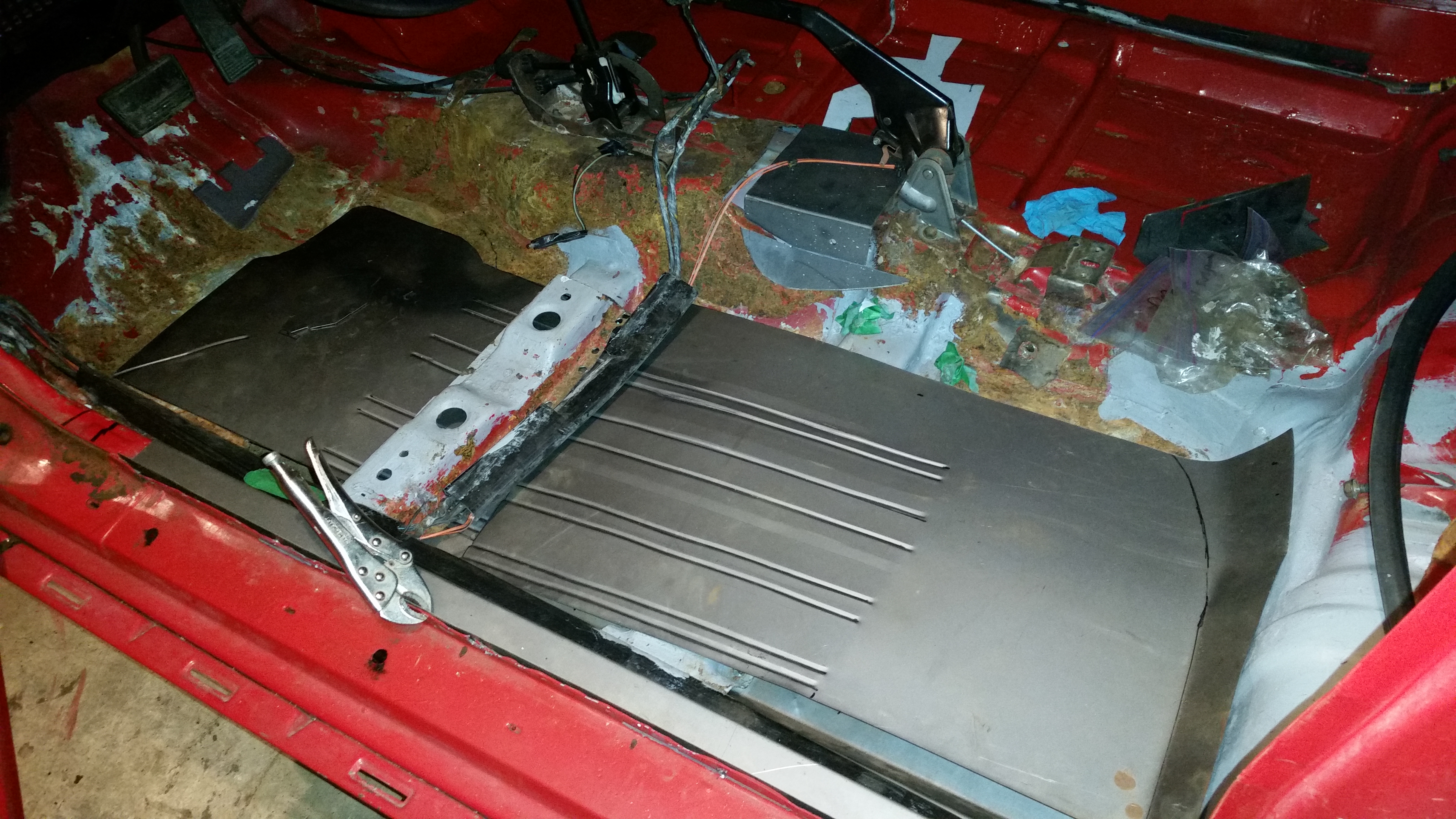

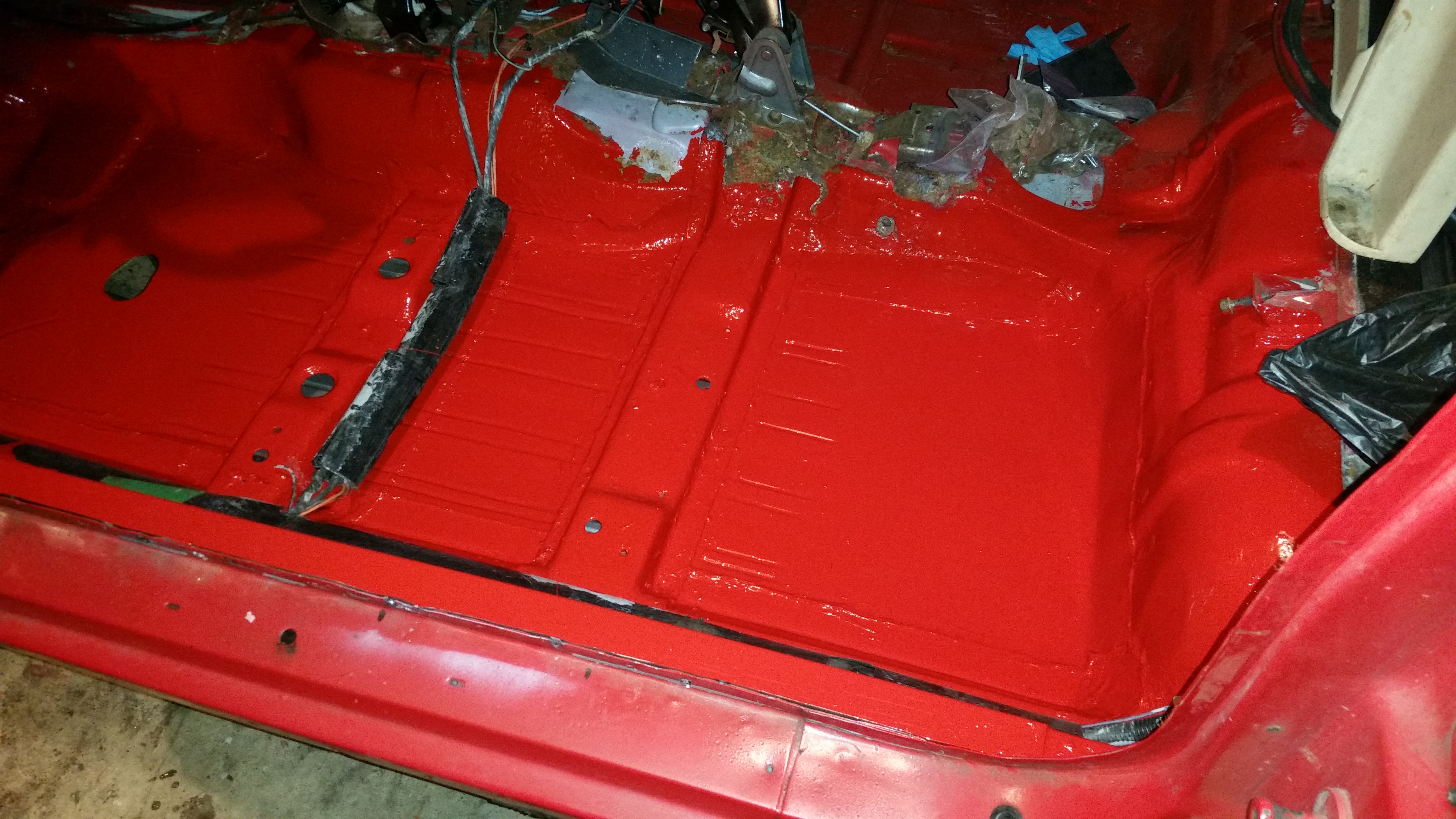

I made them myself. 20 gauge steel and a bead roller.

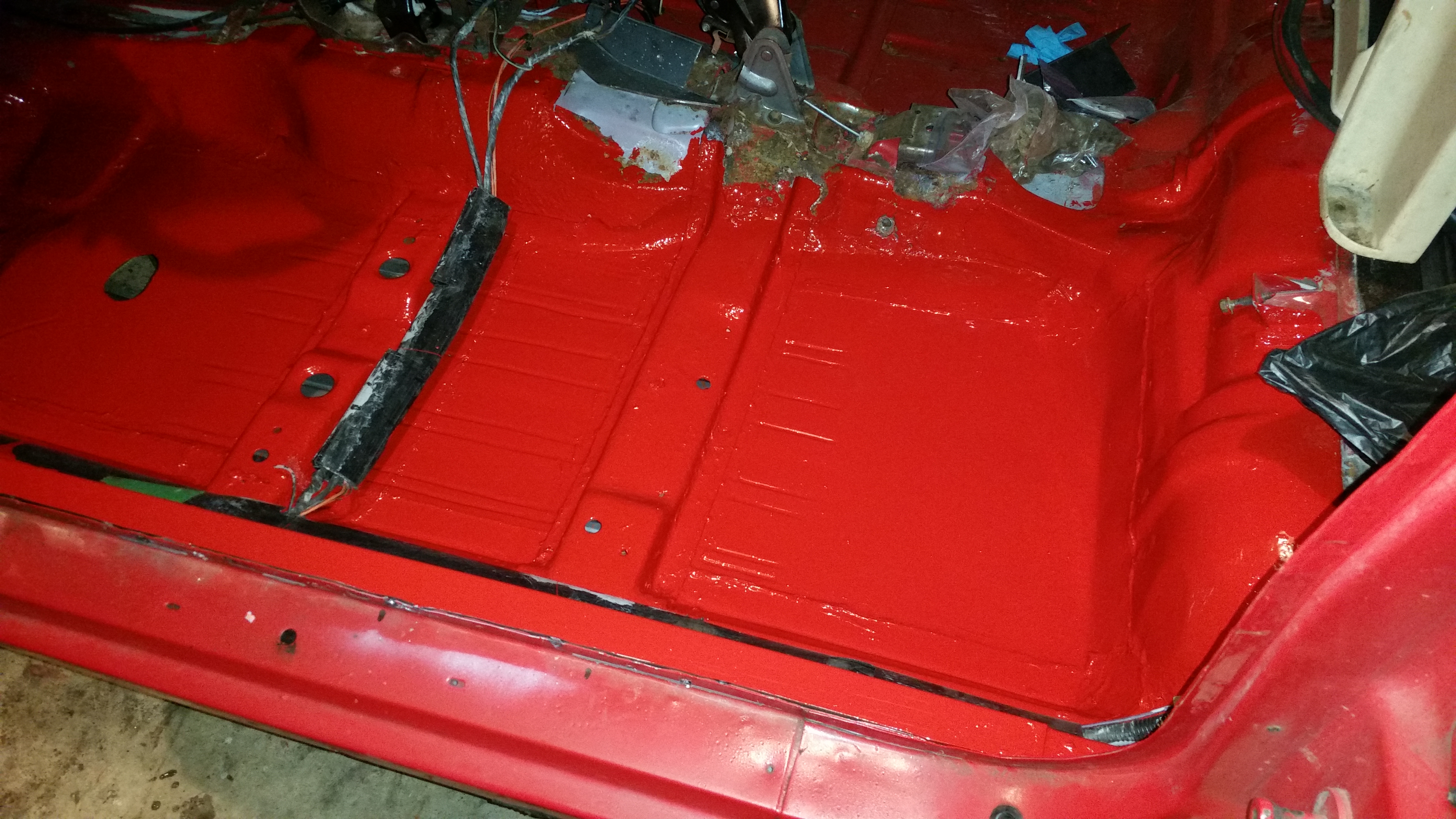

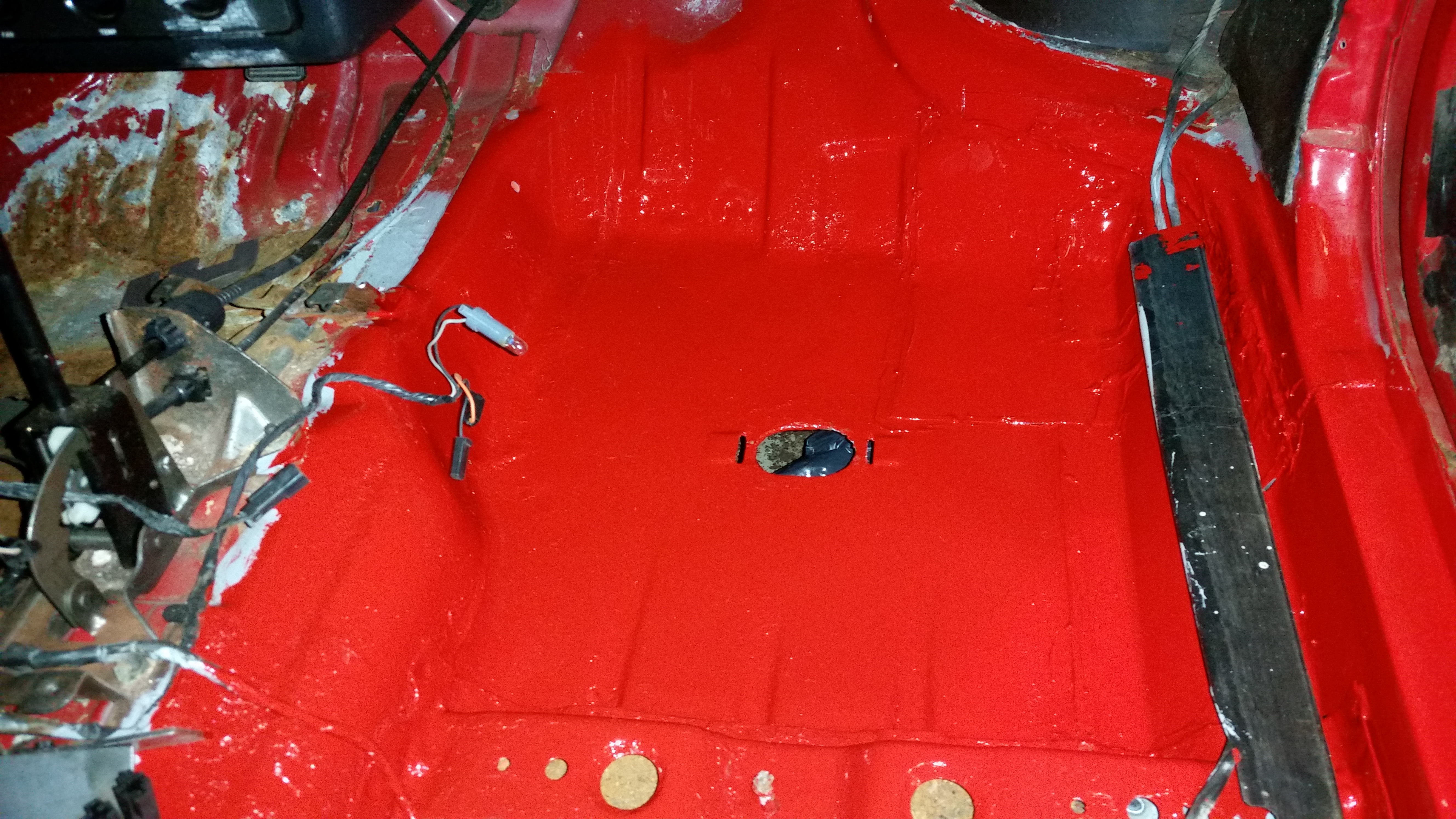

Floor all welded in. Just have to do a little more work on the rocker and this side is done. Than i can put the front end back togethet.

I am very impressed that you created your own floor panels from scratch and welded them in.
It looks like you over lapped the pieces of sheet metal and welded them in.
DId you put seam sealer on both sides?
Re: Back after 10yrs
Yes i over lapped the two pans the rest was butt welded. Were the over lapped i primed them with weld thru primer than seam sealed both sides.

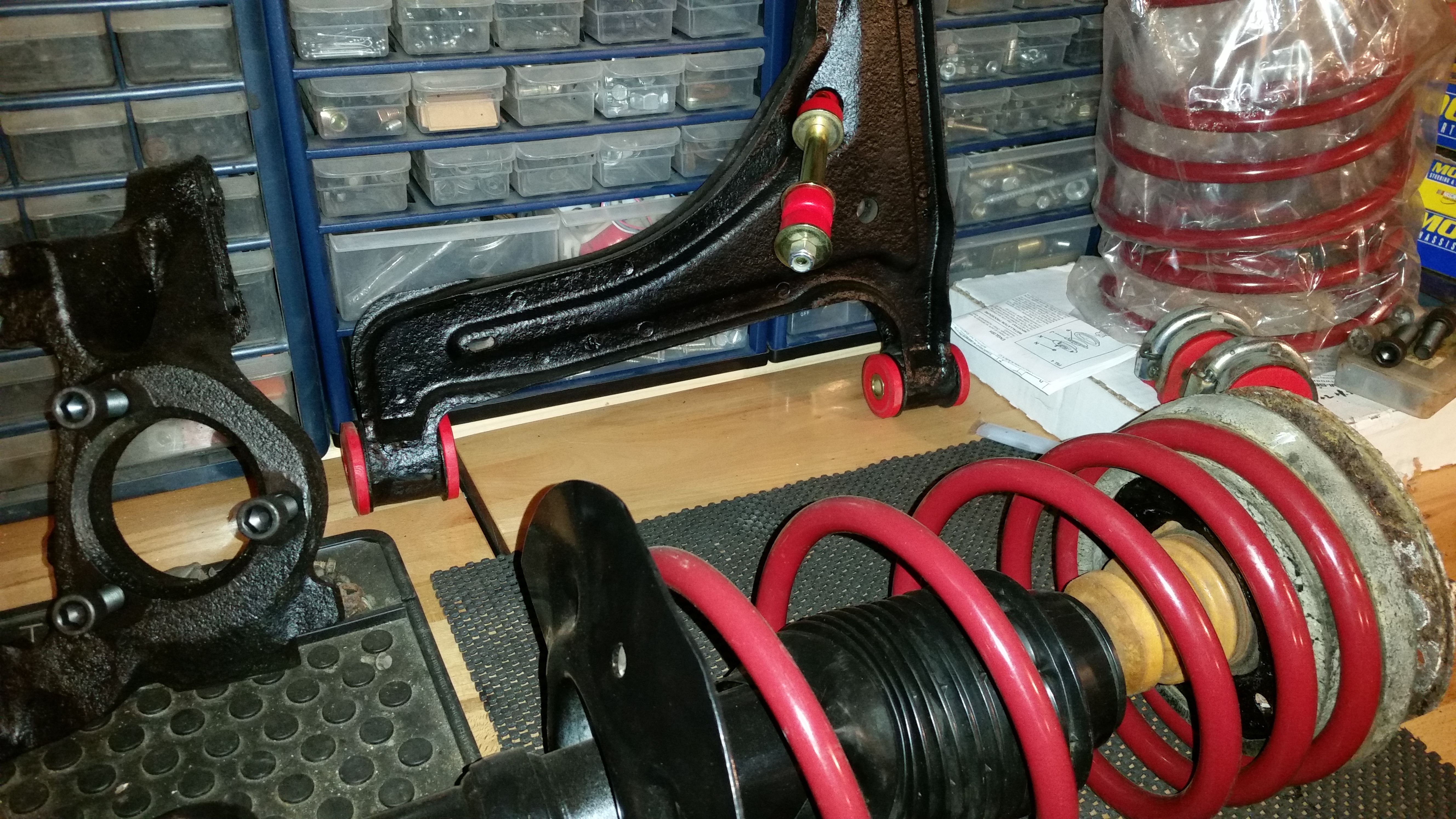

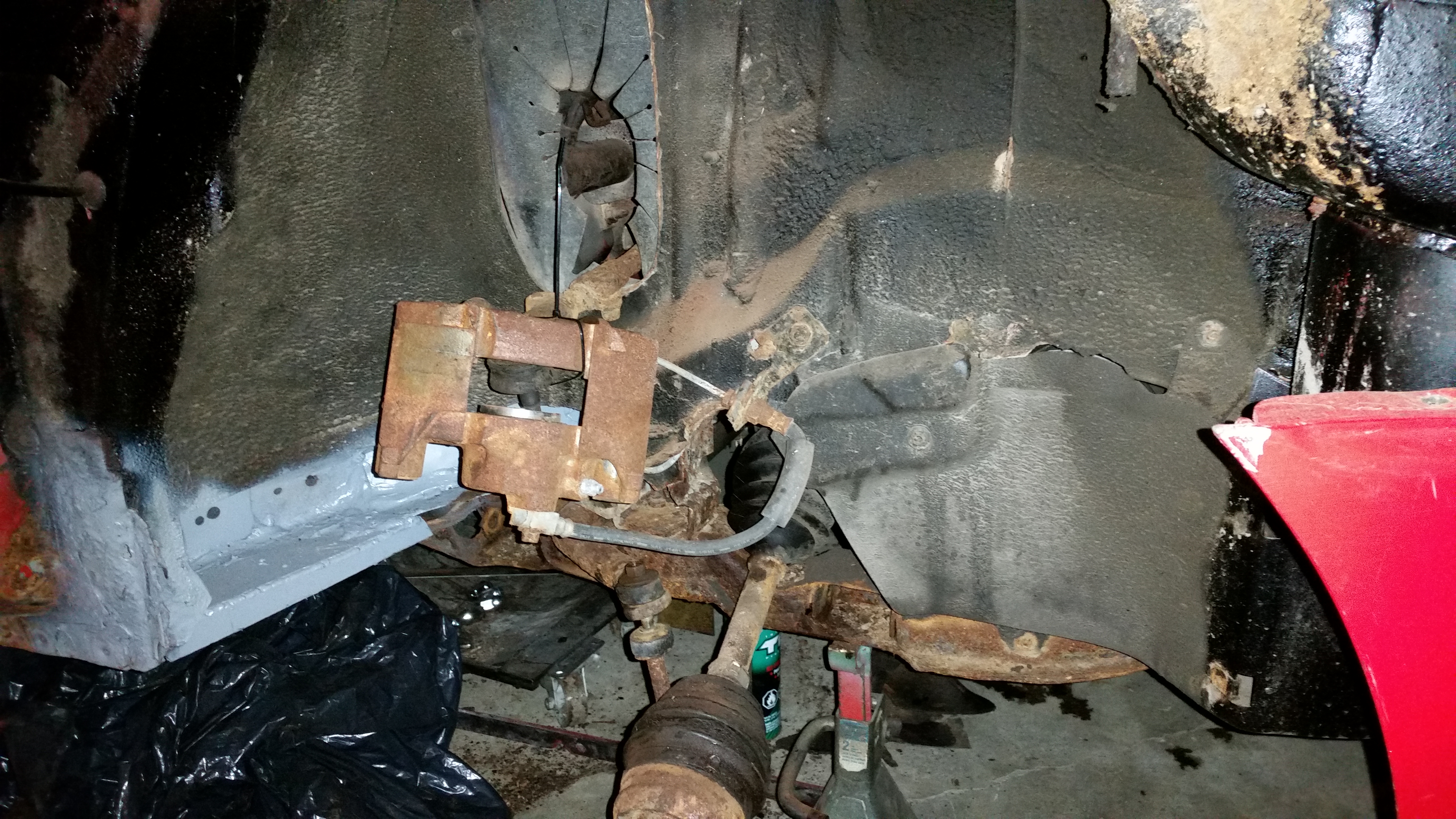

A little update since last post. All the welding is done on the floors and rockers. I finished putting the canuck springs in and put the gtz wheels i got from "the mixer".
