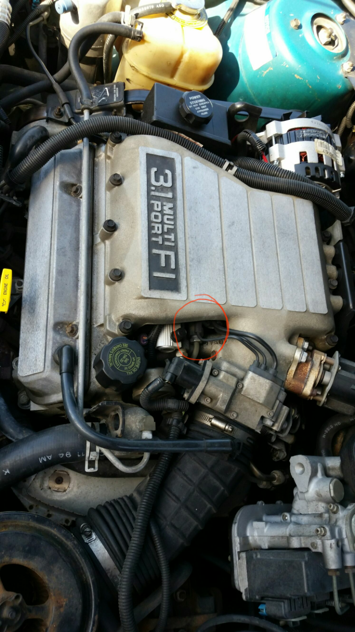

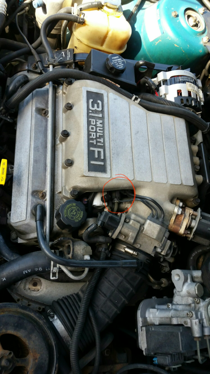

But where is that vacuum line? Been looking for that from the + marked thing near intake but I only can find two fuel lines (metal ones) going to it? And mines 3.1 mpfi.

See the small left most vacuum line?
There is a T fitting if you look close just under the 3.1 intake.
Carefully pop the T fitting off the fuel pressure regulator and see if fuel comes out the regulator vacuum port.

Ah thanks my friend, now i got it.
Gonna take look to it, im experiencing very hard starts, only time it dont hard start if i immidiately start after i turned off the engine. So i guess fuel is draining (leaking) from somewhere... Before hard start thingy I gotta sort that misfire out..

Other thingy, managed to locate that vac line you talked about (vac lines are ok btw) and pulled it off when car was sitting and was doing some rust jobs (almost ready!). I didnt find any fuel from that line, BUT the vac line going to fpr was smelling for fuel... So looking foward to get the car running and see if theres fuel in the vac line while engine runs... But I guess that line shouldnt smell for fuel, right?

Yes there shouldn't be any fuel smell in the vacuum lines.

It needs the line connected to get proper vacuum reading for your MAP sensor as that T fitting goes to your throttle, your MAP and your FPR.
If you smell fuel, there could be an external leak somewhere else on the rails/injectors, or injectors may have leaks and you smell vapor from the intake.
