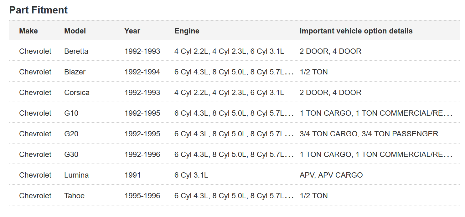

High Beam Part Number for anyone who may need the info:
16506325
Link to GM Parts Info: (Discontinued)
https://www.gmpartsgiant.com/parts/chev ... 06325.html
Image of Vehicle list:
Additional Vehicles that used the same size bezel:
1998 - 2002 Pontiac Trans Am Part Number H4701/H4703
I'm wondering if the 2002 trans am headlight assembly can be used for parts for our euro lights.

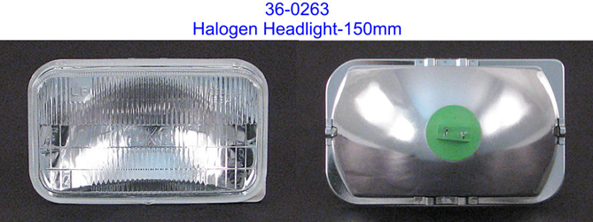

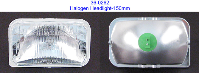

I contacted a website http://www.lmctruck.com/
I found that the H4703 and H4701 match the 36-0263 and 36-0262 numbers. However they look like sealed beams in the photos.
This may be another option if any members are interested.
The ones I found on ebay should be the H7 capsule versions of these. I'm still waiting on shipping to find out how they work.

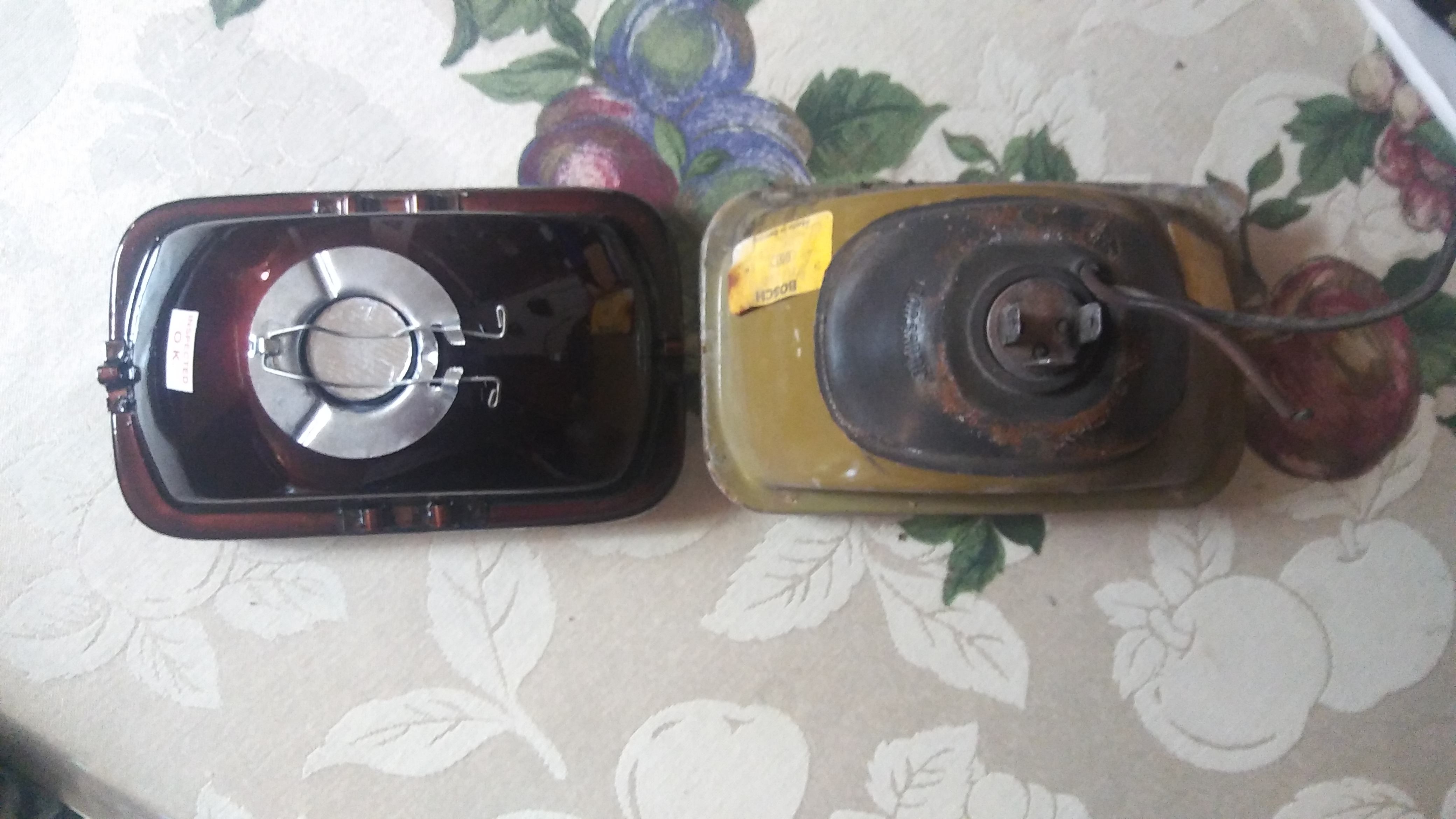

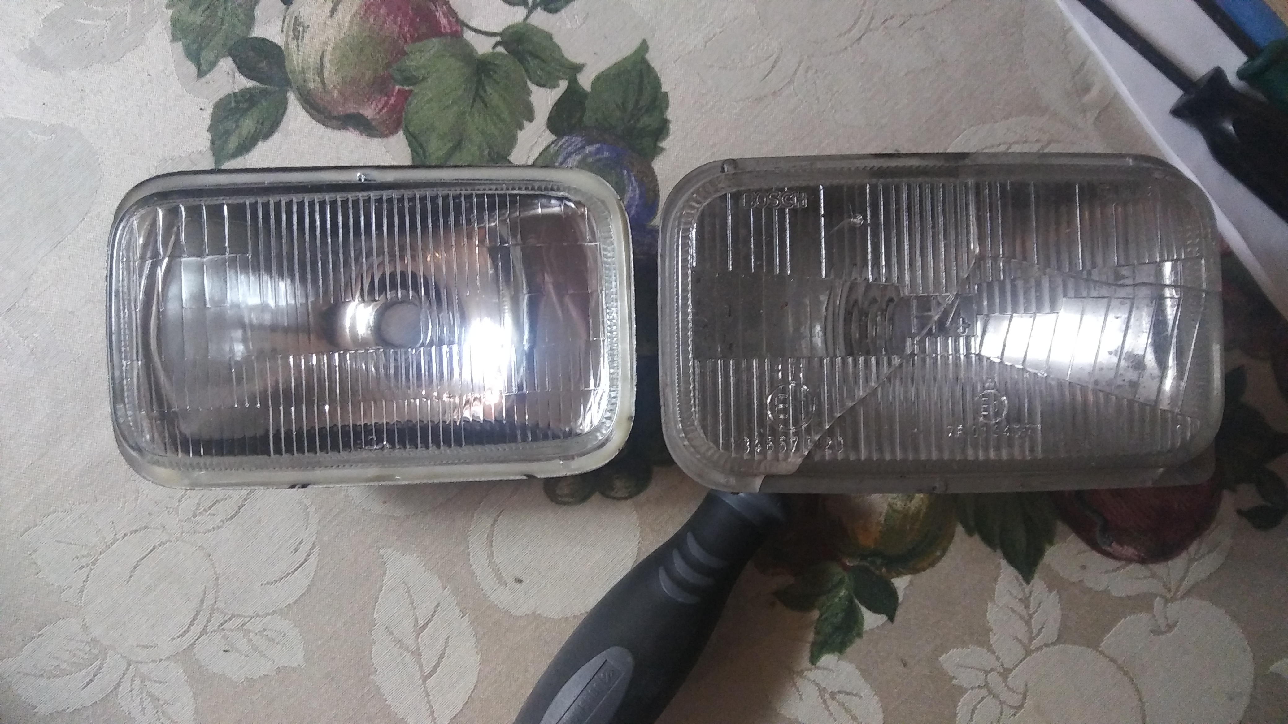

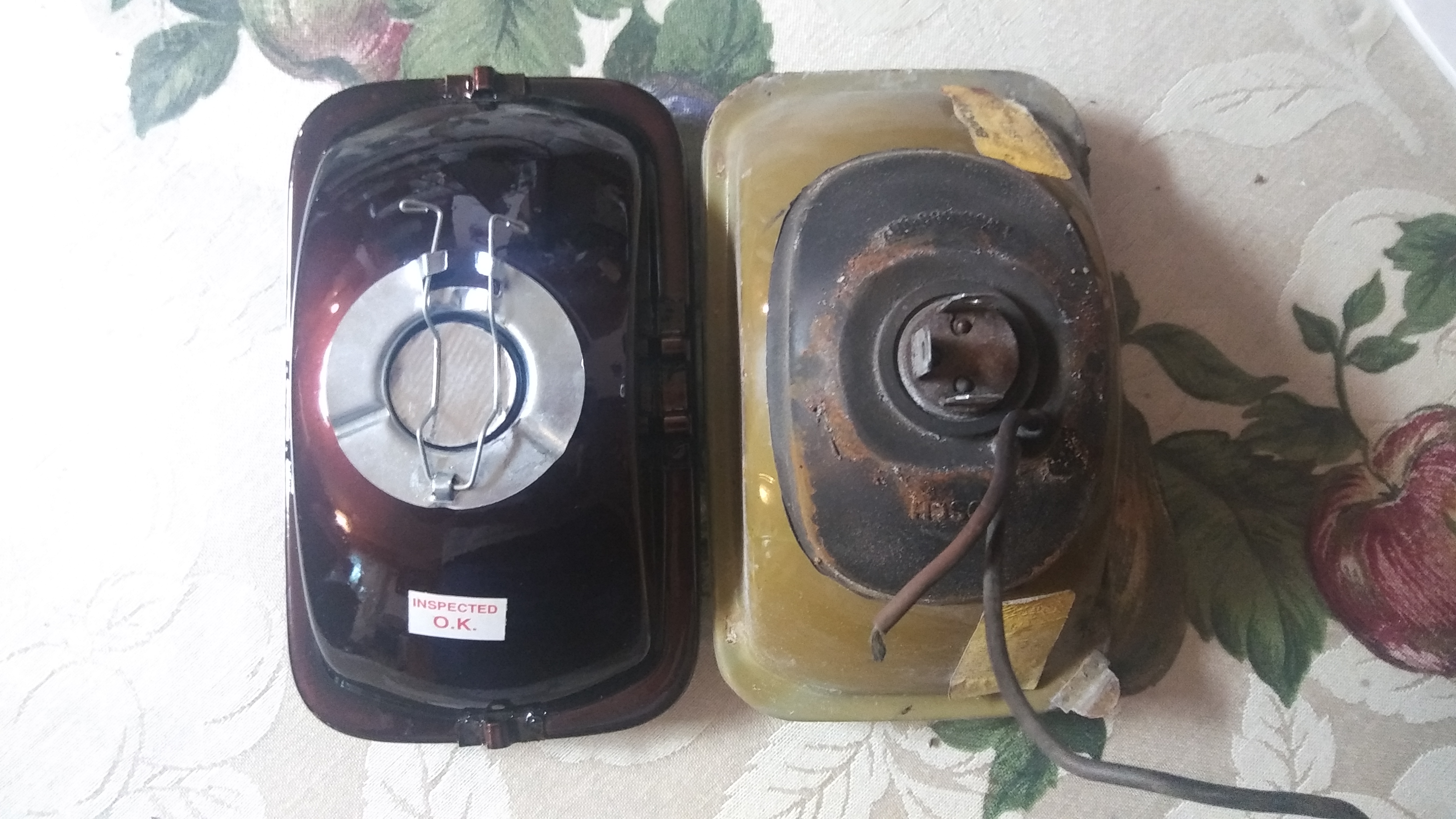

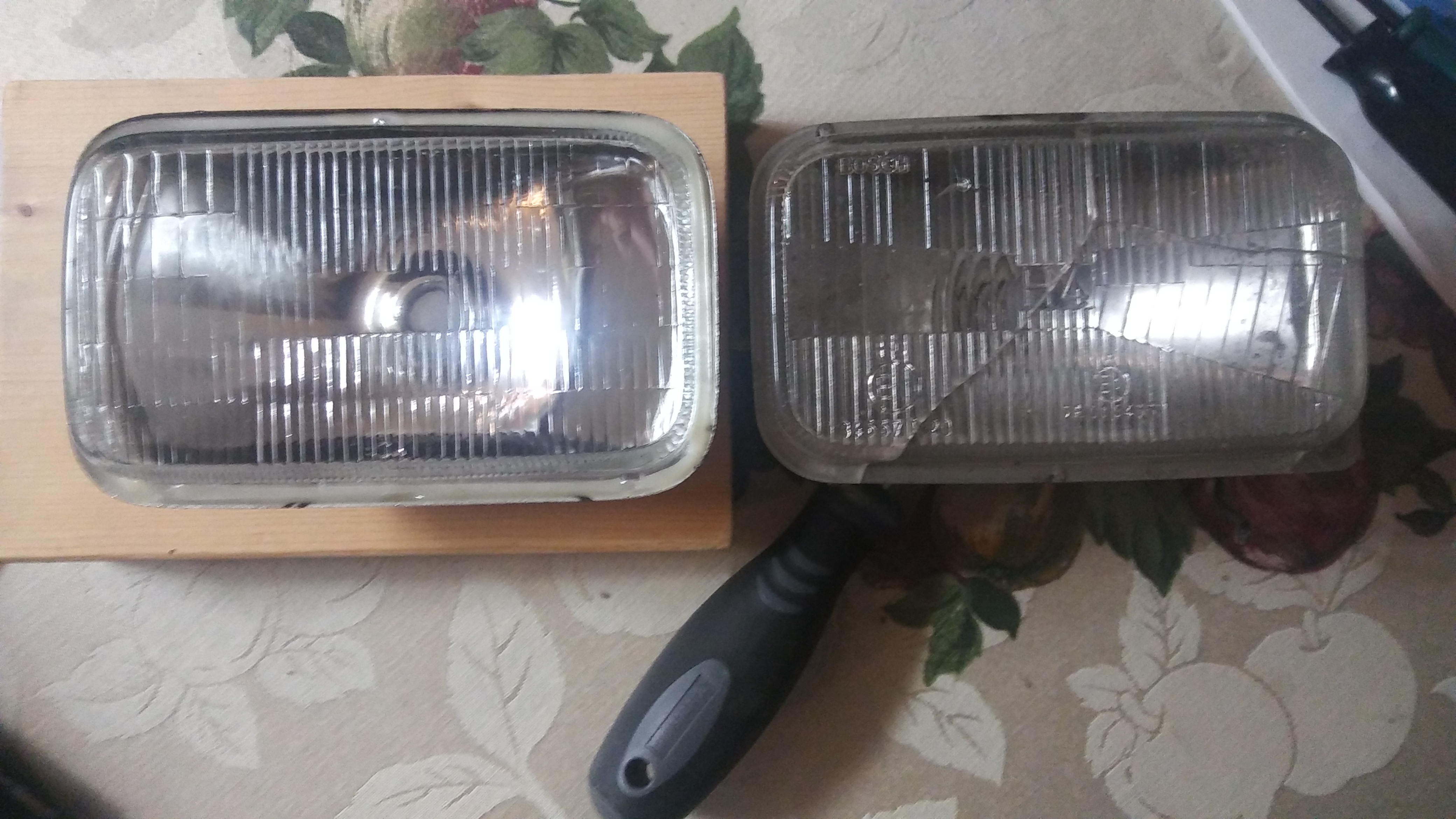

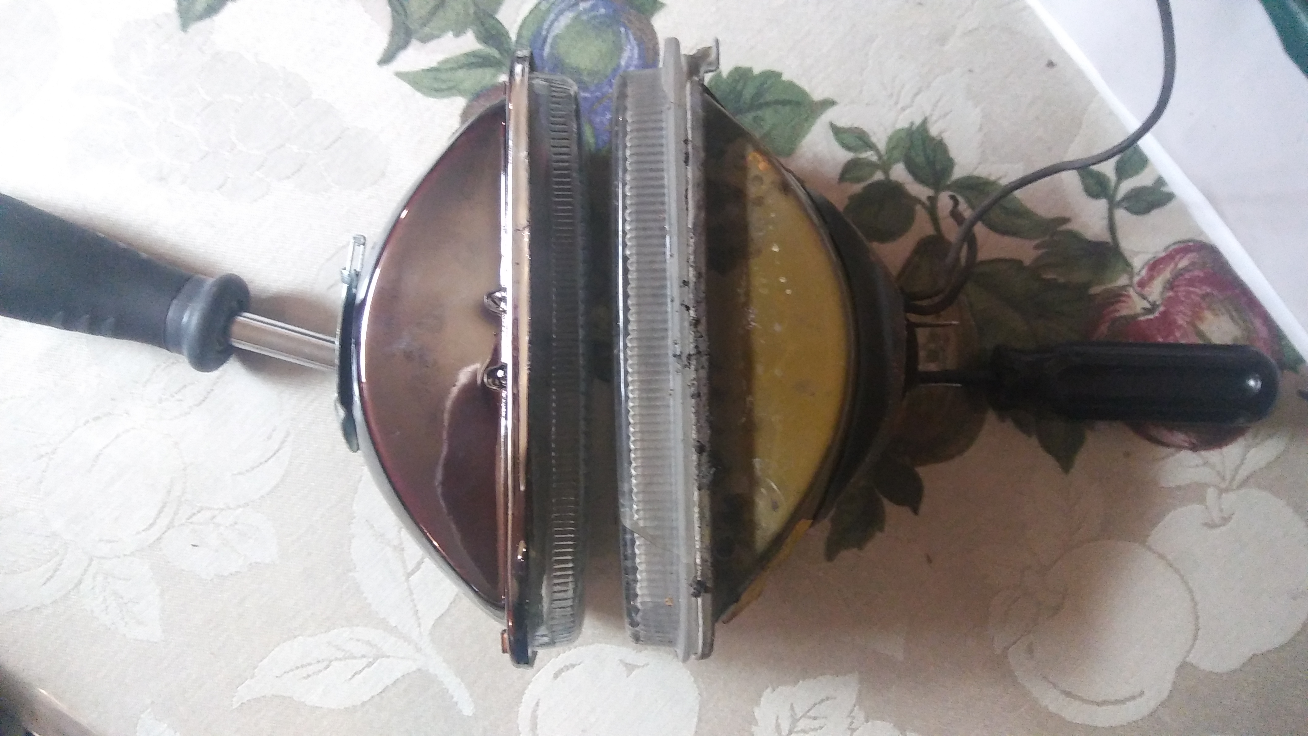

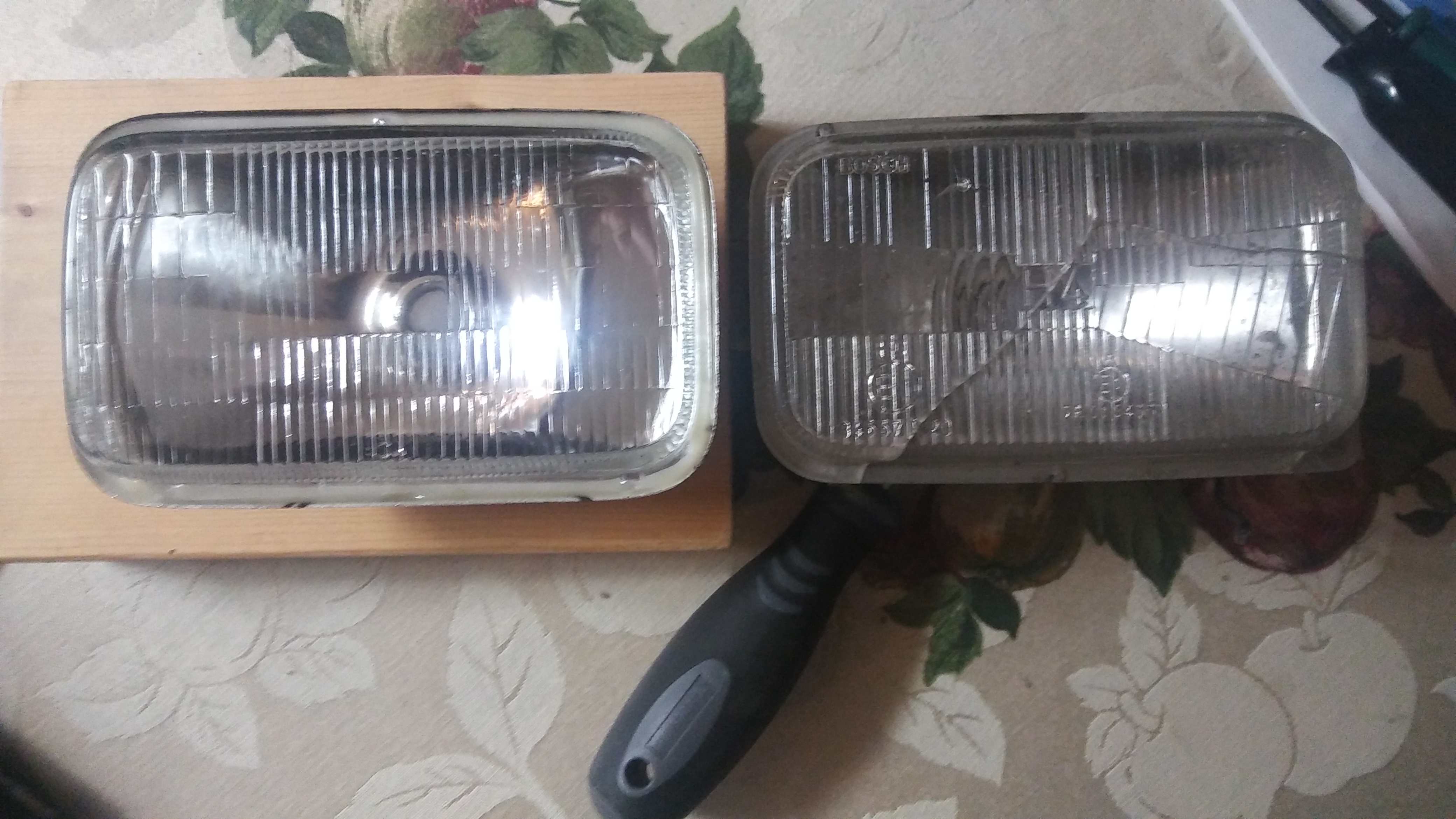

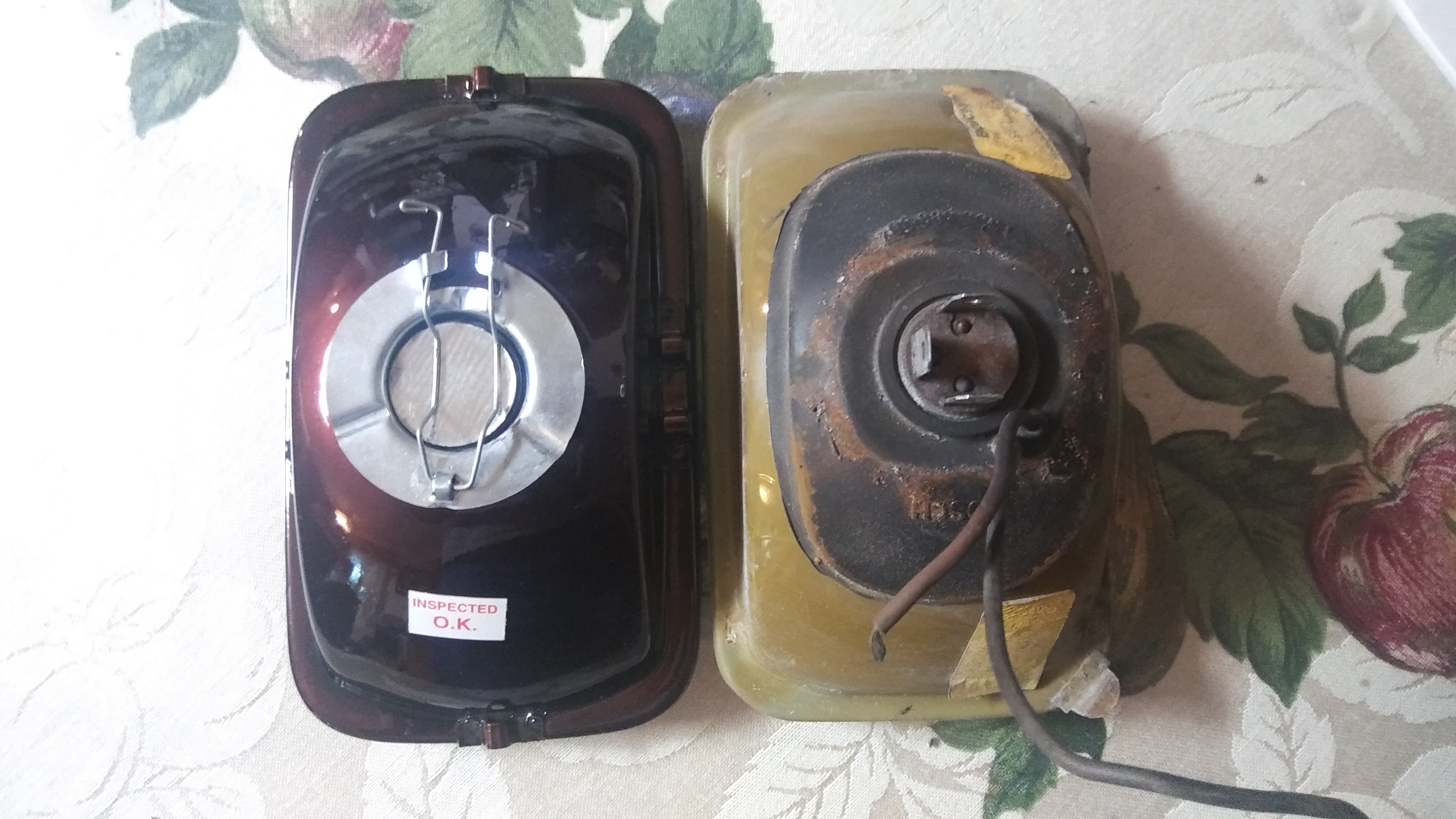

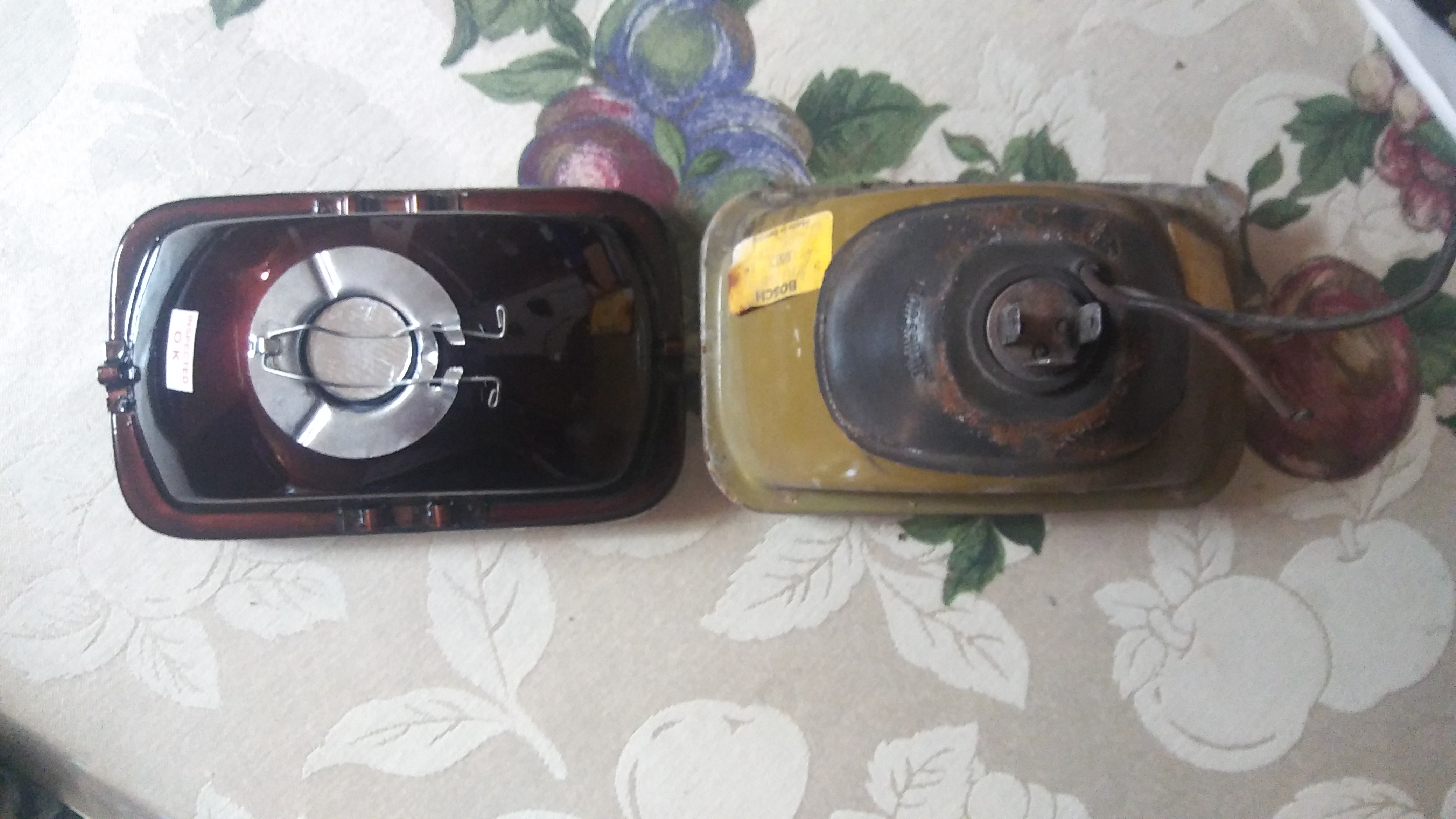

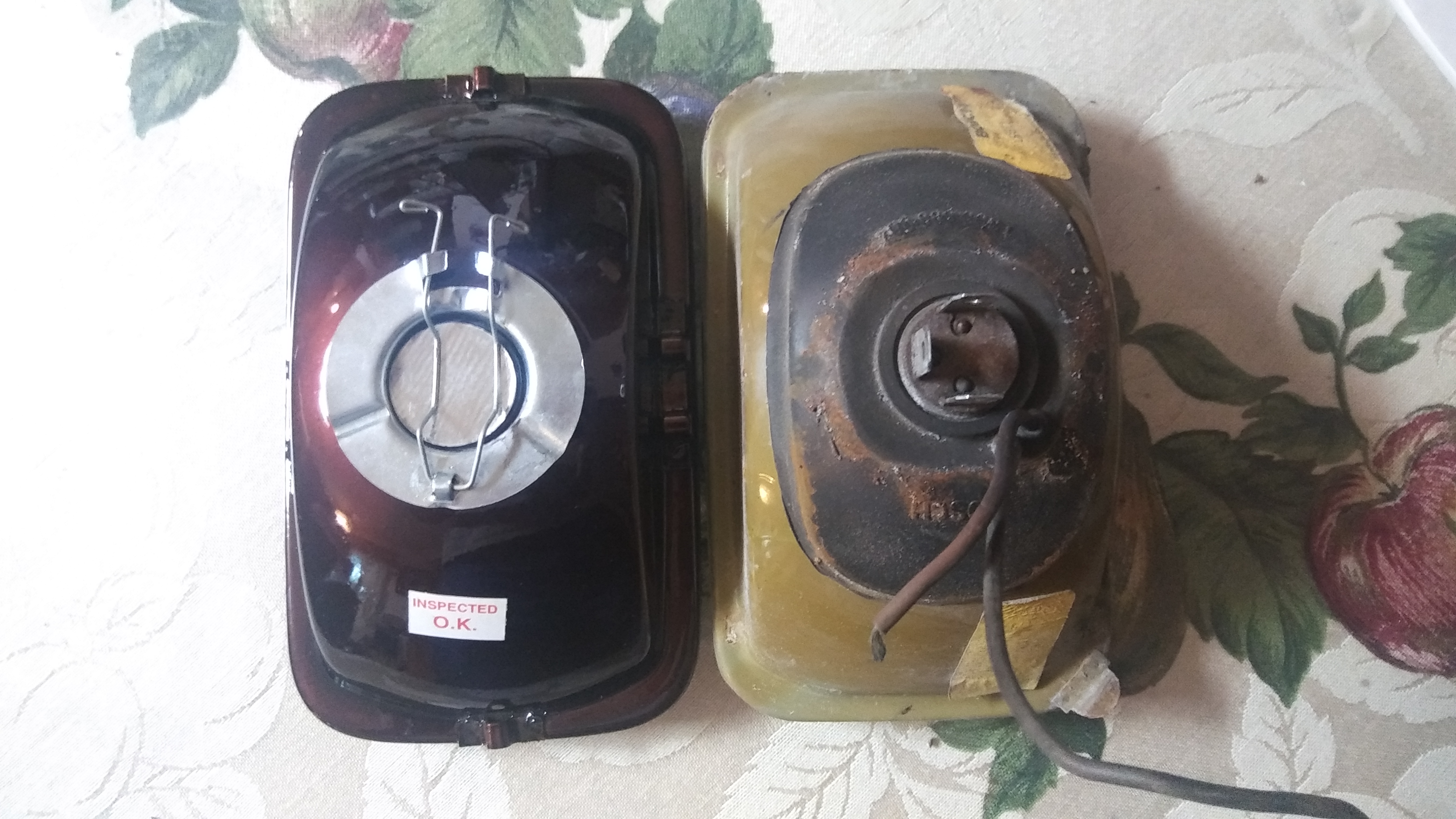

Adding photos for reference.
The H7 capsules work, they arrived today.
The only downfall is the clip on the capsul is bigger than the opening in the back piece. So If I want to change a bulb I have to remove the capsule from the front.
They are glass. And look to be well made.
I took photos of them with the euro light for comparison.
