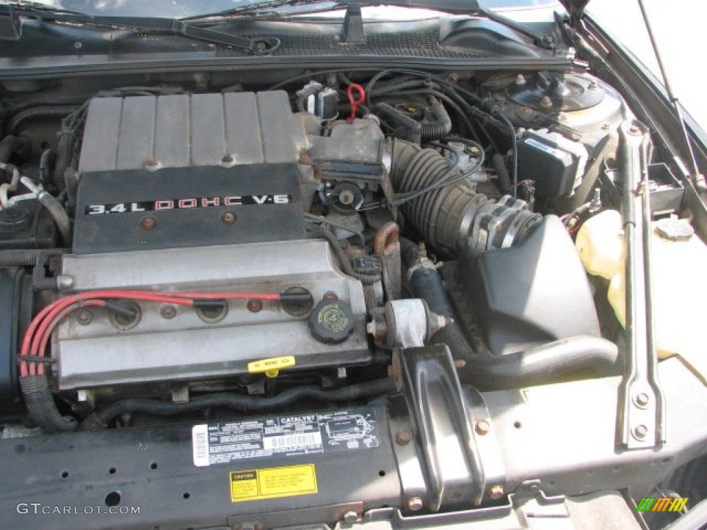

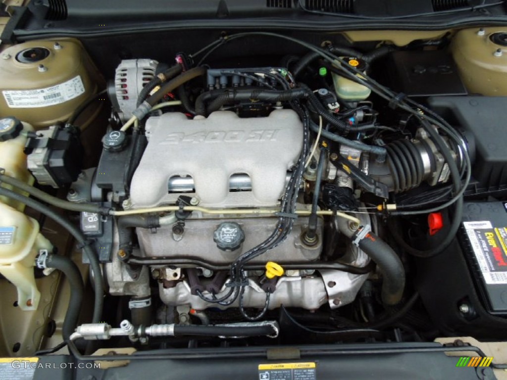

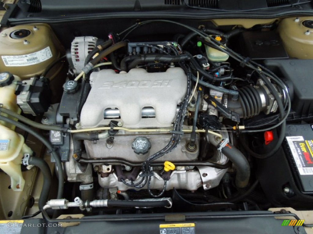

There is the 3.4 DOHC and the 3400 SFI.
The 3400 SFI looks like the 3100 SFI. and the intake is swappable from the 3100 SFI to the 3400 SFI.
Below is a photo of each:
The 3400 SFI: (Code: LA1; Gen 3 v6)
The 3.4 DOHC: (Code: LQ1; Gen 2 v6)
Wiki page has more info:
https://en.wikipedia.org/wiki/General_M ... _V6_engine
The 3100 SFI has 160 hp and 185 lb-ft torque.
The 3400 SFI has 185 hp and 210 lb-ft torque.
I saw in your other thread that you want to achieve 200 or more hp. I may be easier to achieve that and possibly more with the 3400 over the 3100.

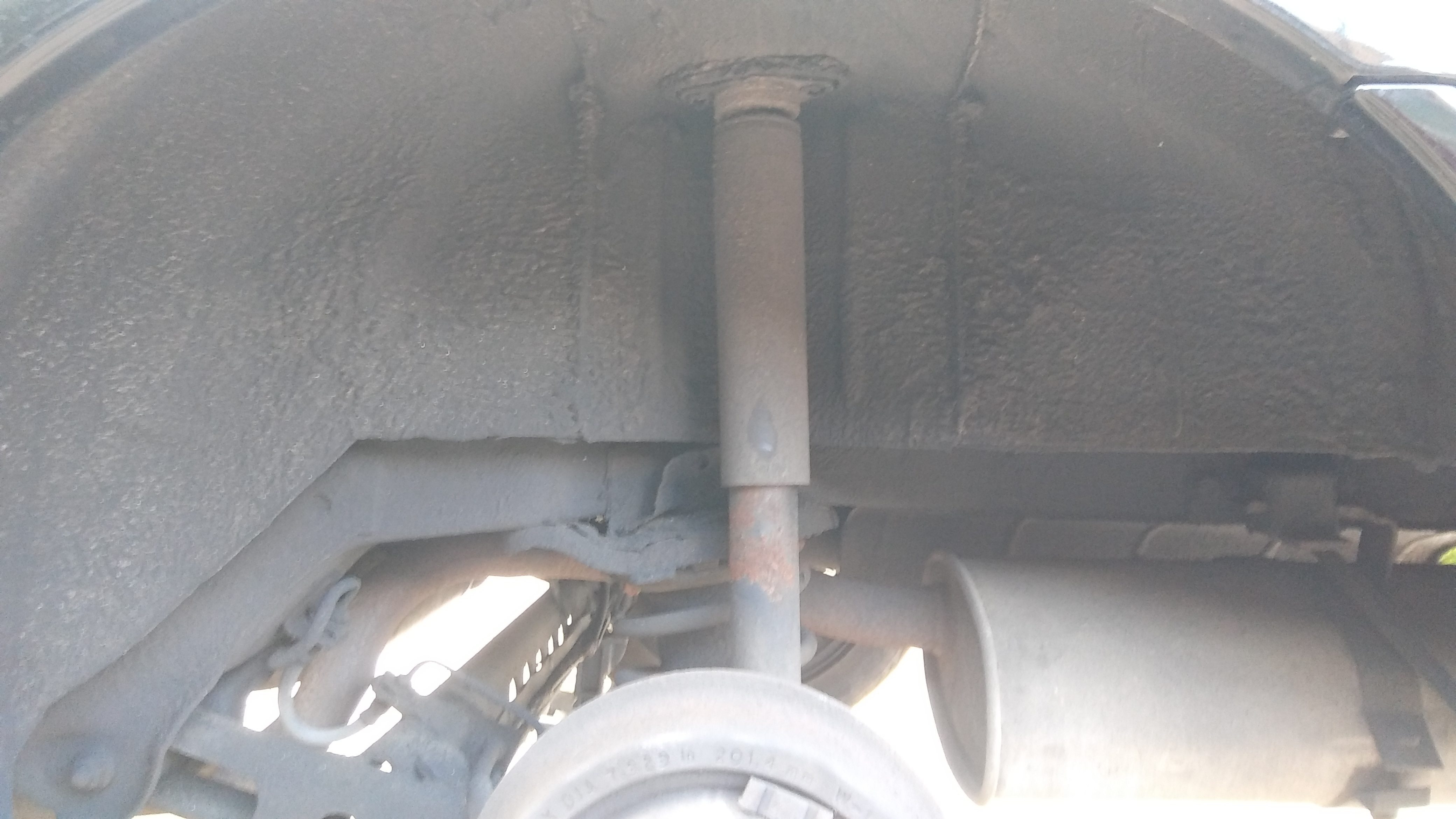

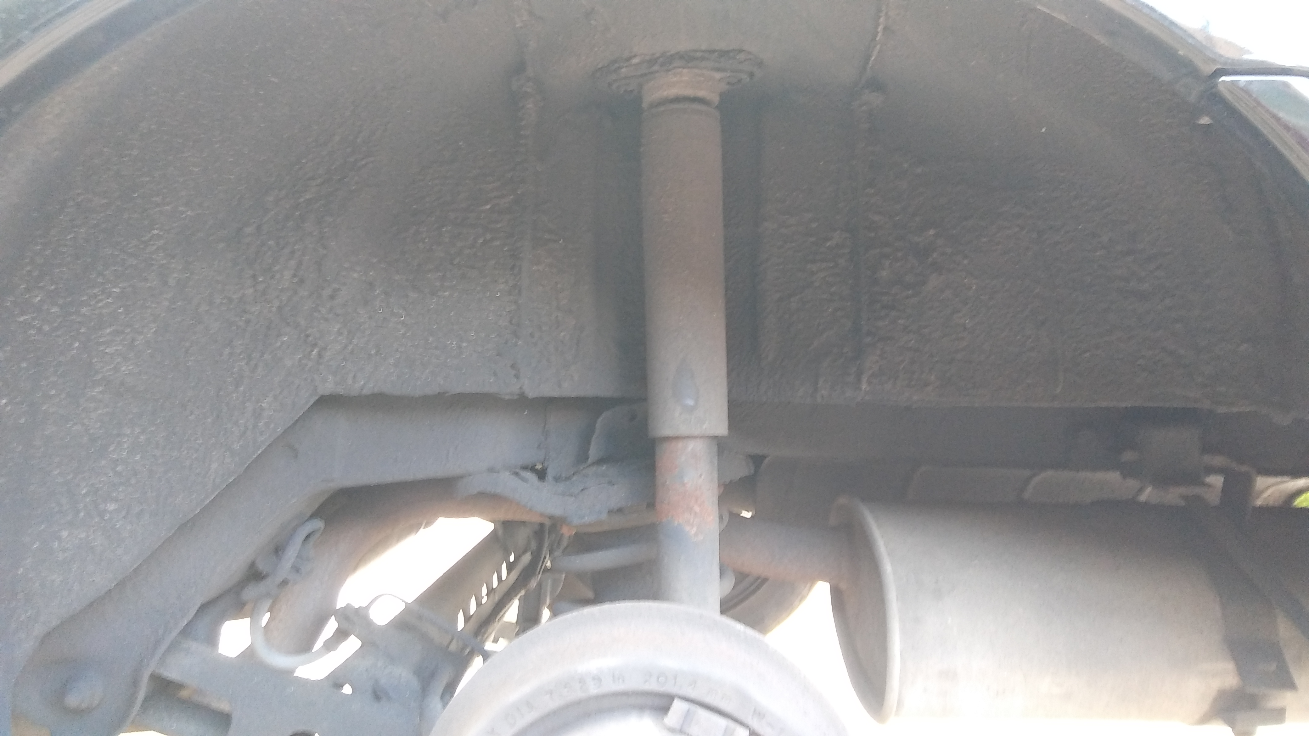

I suggest taking a look at the underneath and making sure it isnt rusting to much before going too far. This way you know you will have a car that you can enjoy for a long time after making it better.
When you open your doors do you see any rust holes in the door james in the bottom front corners on the unibody? Any bubbling under the paint?
Do you see any rust on the rear spring supports?
Here is a photo showing spring supports as an example.
