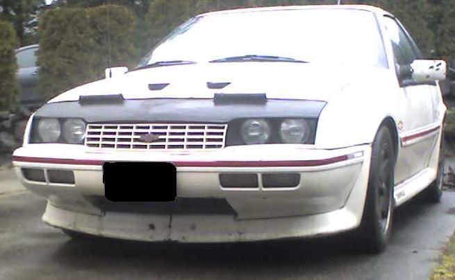

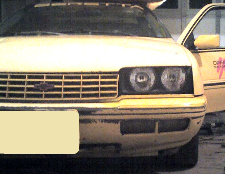

Option 'B' -not a fan of those LED wanna-be halos. I've considered similar units to use the LEDs as turn-signals, but otherwise not so much.
I got another set of the E36 headlights at the salvage yard a few months ago, like I modified for Euro-esque styling on my GTU -I think they will go on my Yellow Indy, but I may put them on the new DOHC Z-26 instead. I was never a fan of the E36 lights installed on the Berettas with the Halo option and the stock outer lens -they made the Beretta look like it was wearing glasses.
I'll be using early fourth-gen Camaro/Grand Prix lights on my V-8 Indy -those are the very low-profile rectangular lights.

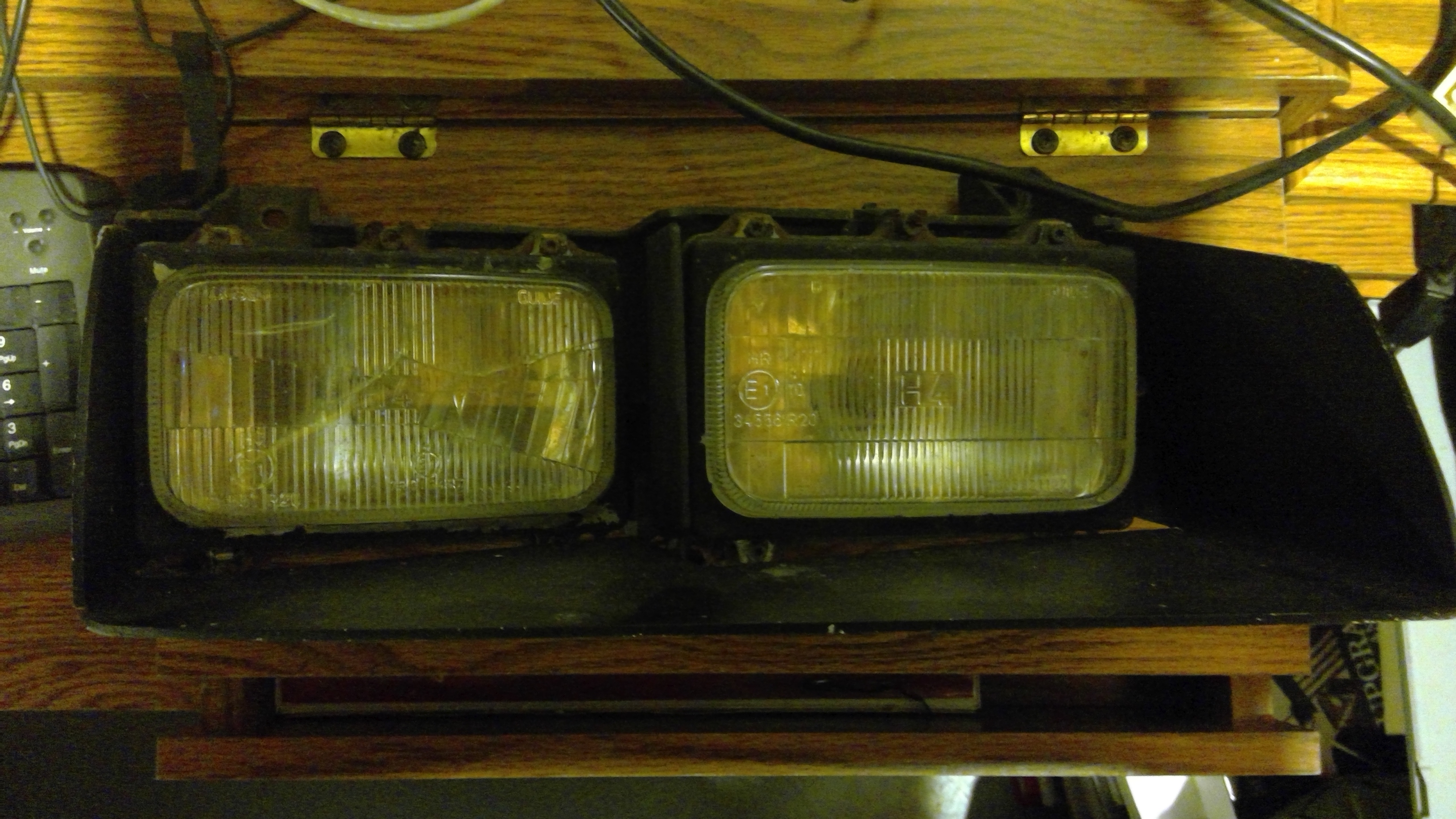

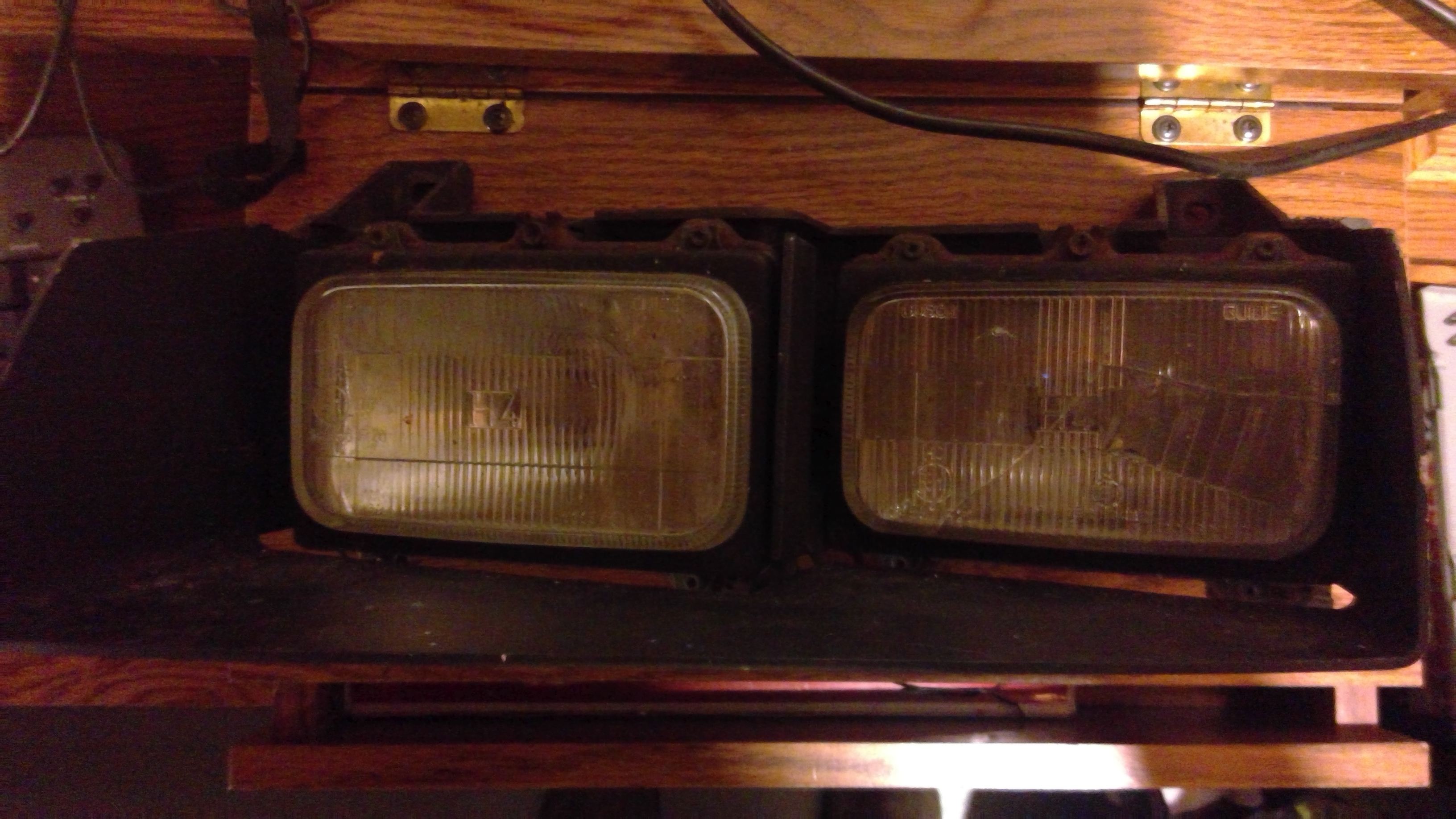

Rexxax3, so what did you do, just remove the outer lens from the OEM bimmer light? I tried that on mine and broke both of them, so I never got another set to try again.

Re: Rebuilding Euro Headlights!
Yep, stock E36s without the outer lens. The inner lenses do have vent slits in them, so something needs to be done to keep moisture out or the bulbs won't last long in the rain. Cutting off the lenses is a PITA if you are trying to save them -next time around I'll just cut them off at the mounting flange and save an hour of careful prying.woody90gtz wrote:Rexxax3, so what did you do, just remove the outer lens from the OEM bimmer light? I tried that on mine and broke both of them, so I never got another set to try again.

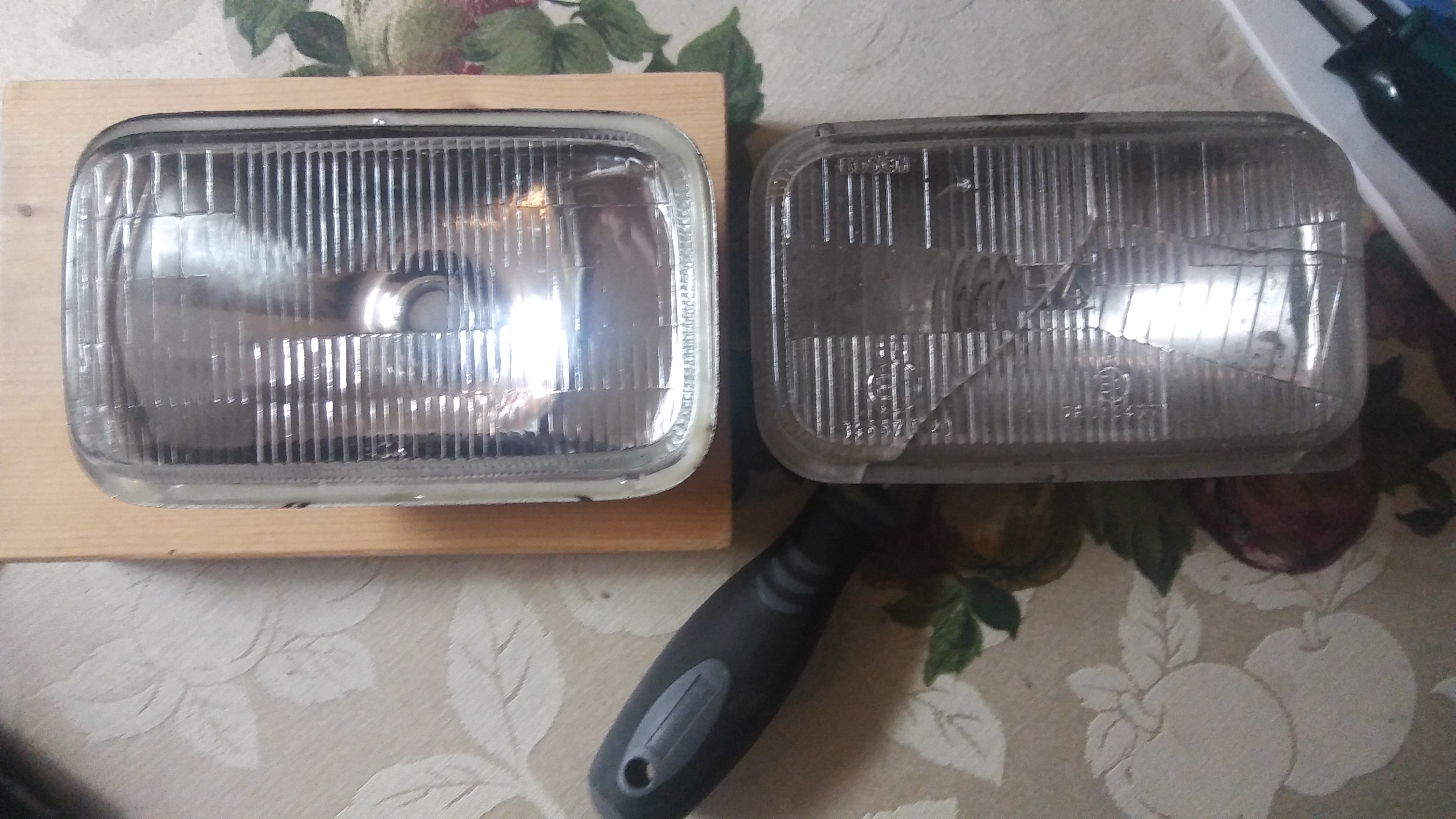

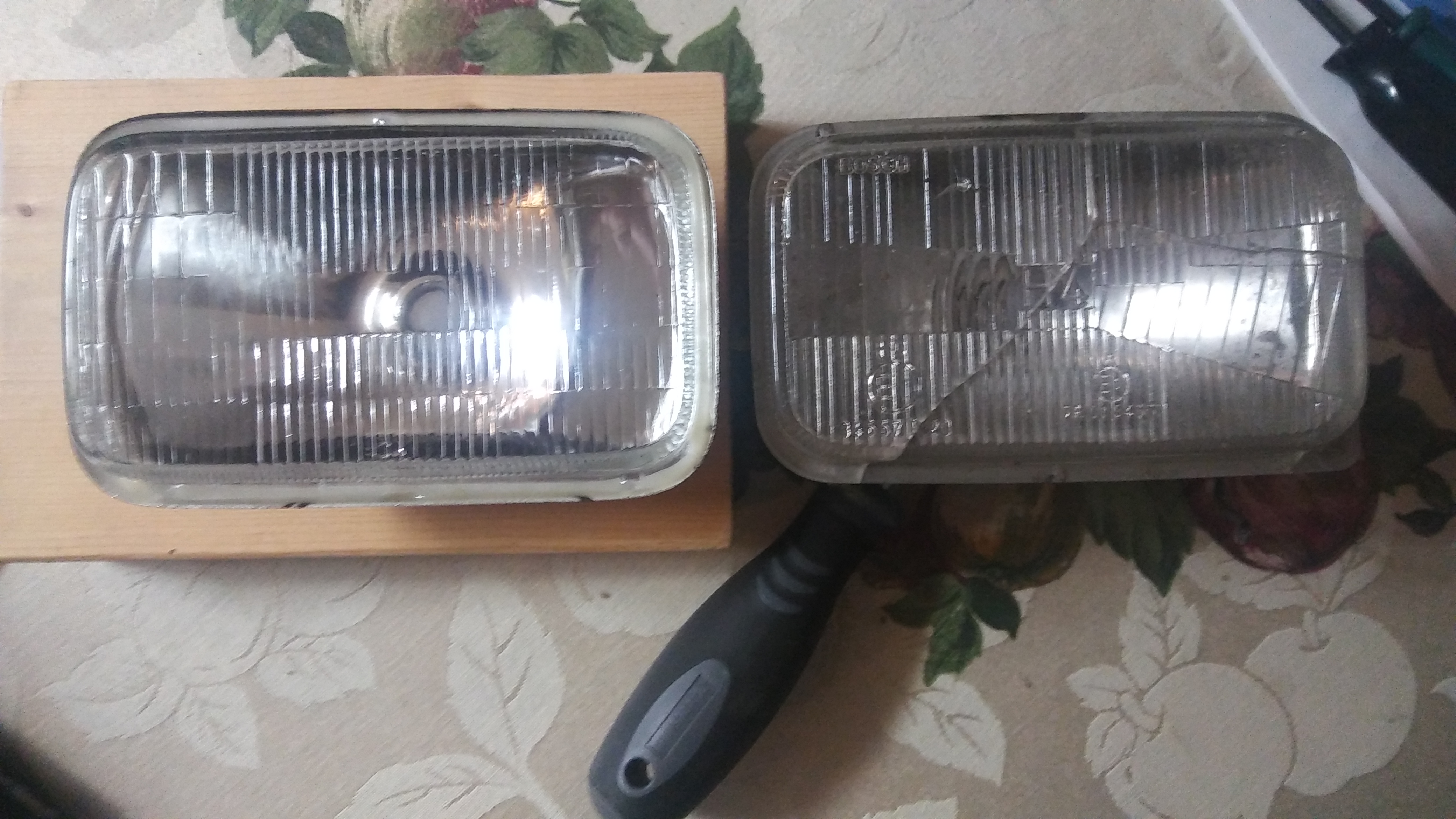

My new Trans am H7 capsules arrived today!
They match great for the euro lights.
Left new, right old for comparison.
I tried to split them and they broke both times. I didn't think of actually cutting. Use a whiz wheel?Rettax3 wrote:Yep, stock E36s without the outer lens. The inner lenses do have vent slits in them, so something needs to be done to keep moisture out or the bulbs won't last long in the rain. Cutting off the lenses is a PITA if you are trying to save them -next time around I'll just cut them off at the mounting flange and save an hour of careful prying.woody90gtz wrote:Rexxax3, so what did you do, just remove the outer lens from the OEM bimmer light? I tried that on mine and broke both of them, so I never got another set to try again.
I know the glass will shatter from prying, I'd use a dremel with a metal disk if it was me, but the vibration might still be hard on the glass.woody90gtz wrote:I tried to split them and they broke both times. I didn't think of actually cutting. Use a whiz wheel?Rettax3 wrote:Yep, stock E36s without the outer lens. The inner lenses do have vent slits in them, so something needs to be done to keep moisture out or the bulbs won't last long in the rain. Cutting off the lenses is a PITA if you are trying to save them -next time around I'll just cut them off at the mounting flange and save an hour of careful prying.woody90gtz wrote:Rexxax3, so what did you do, just remove the outer lens from the OEM bimmer light? I tried that on mine and broke both of them, so I never got another set to try again.

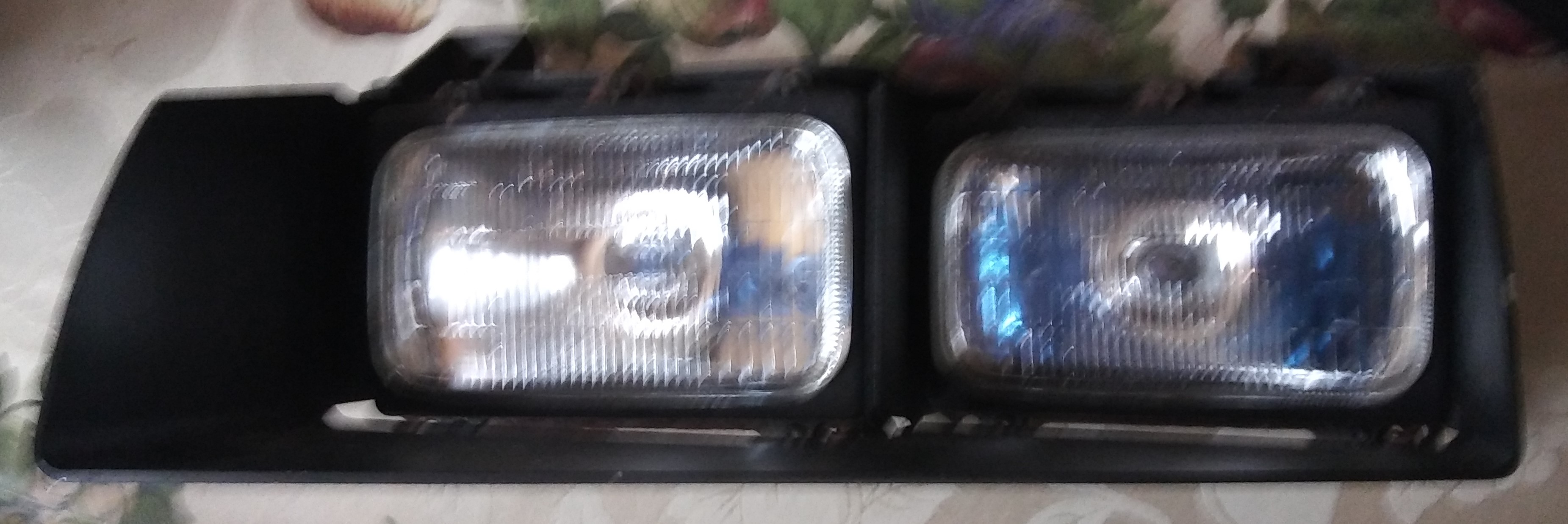

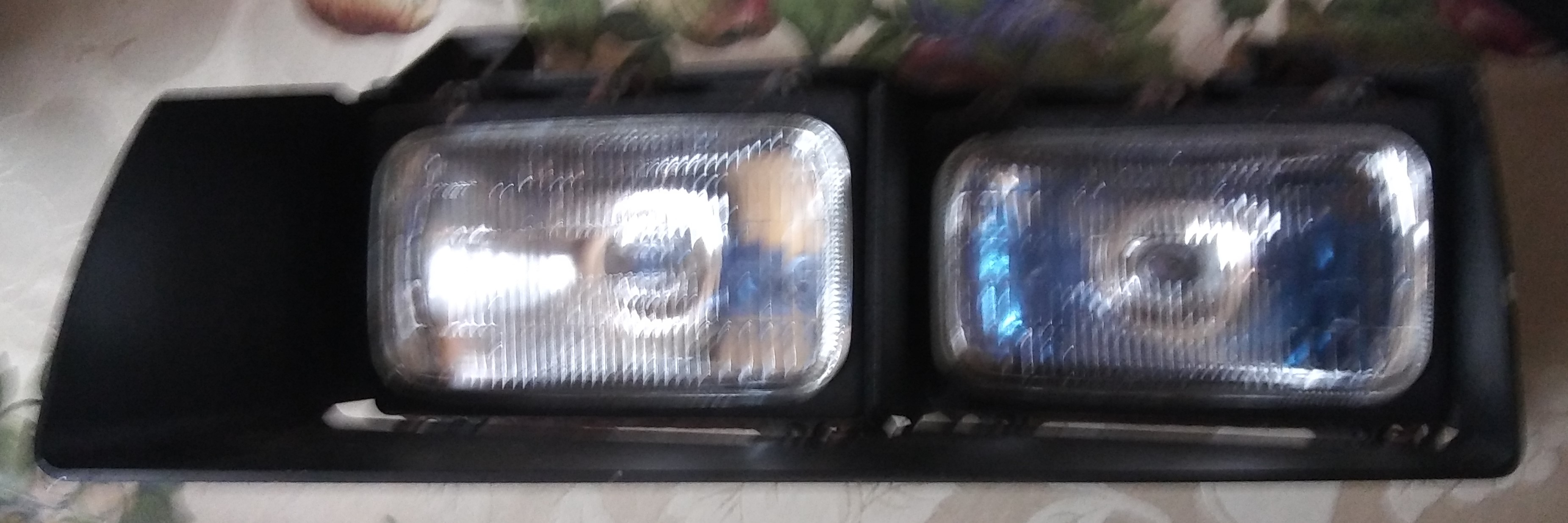

Photo turned out a bit blurry, but one side is done.
These were aluminum lights I got from a Bnet member, they are very good build quality, I'm happy I got them.
This is after I cleaned up the metal and put it all together. Looks Good!
