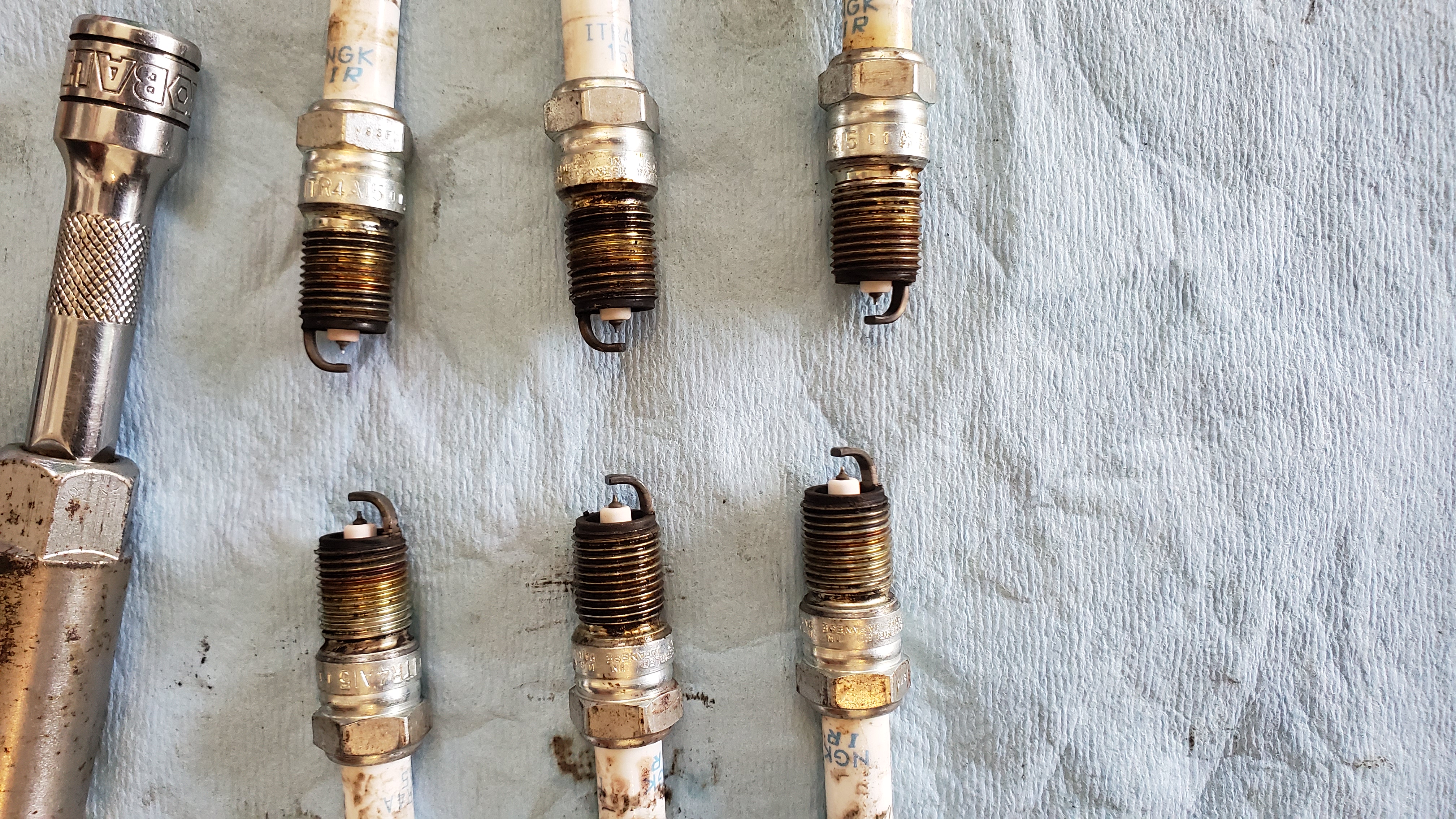

That is the problem Ive been having. Due to suggestions, I took plugs out. Every single one looked fine (see pic) and there was NO gas smell on any of them. What I did notice was a gas smell near the rear of the engine closer to the PS pump

Turns out tho only one needs replacing so like I'm gonna replace that one and see where it gets me. I also did my plugs only 6 months ago and have had no problems since the injector install. I will definetly test the coils though. I planned to do it anyway, just kept forgetting haha.
