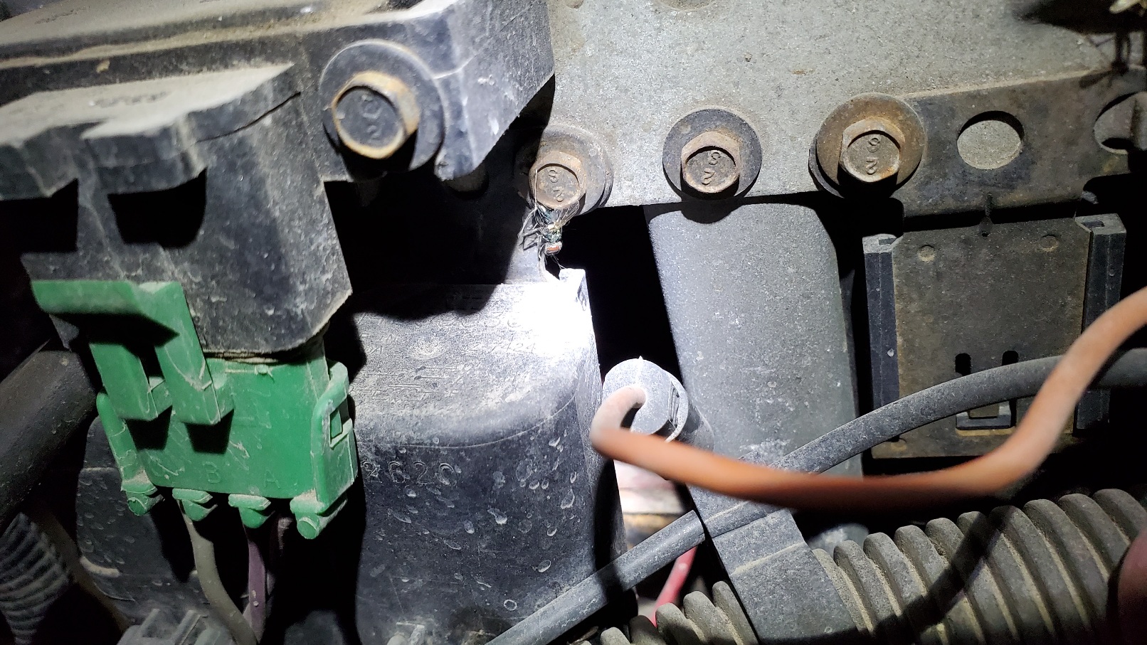

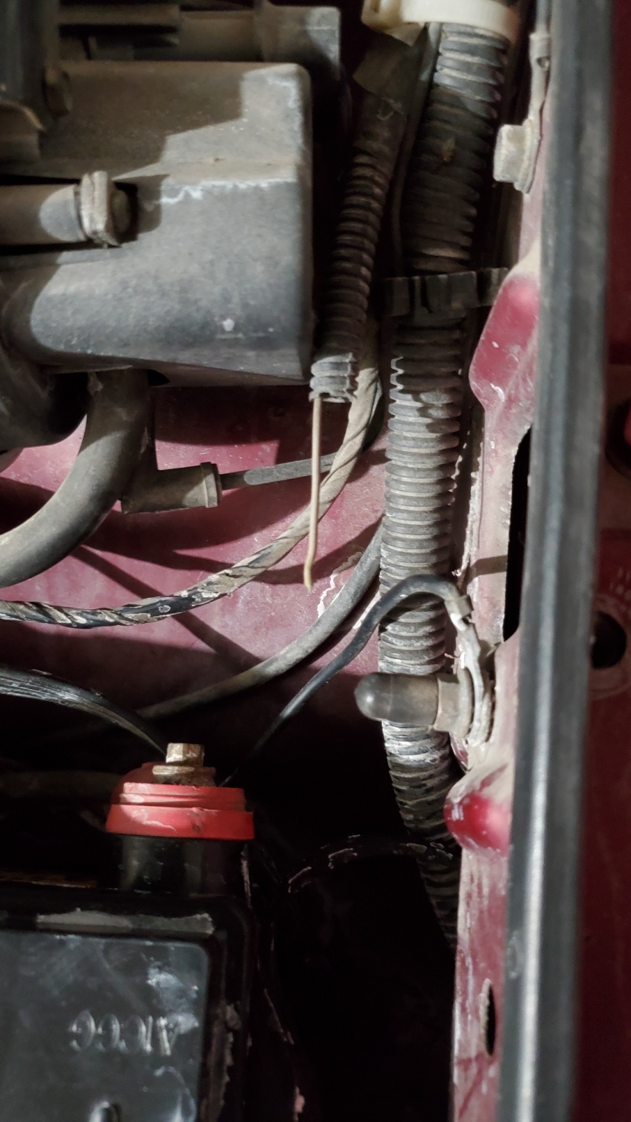

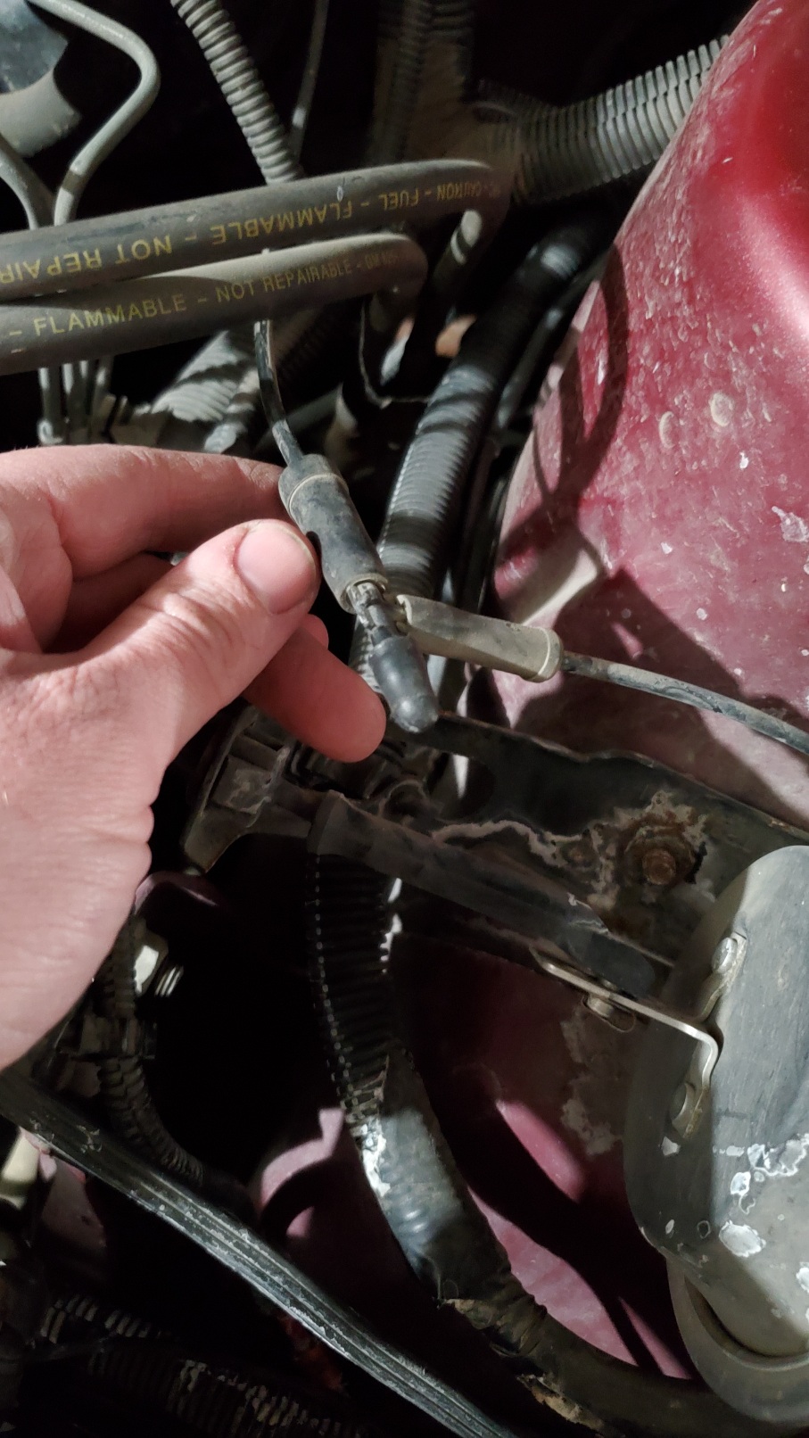

Just picked up a 1990 base model with the 2.2 tbi engine. The cooling fan only seems to turn on when I switch the heater control to AC. Any ideas? I've also found an apparently missing vacuum line and cut wire on the drivers side by the cruise control actuator. Cruise works fine, tho. Not sure if they're supposed to be there or connected to anything. There's also an eyelet with no wire on the firewall relay block.
