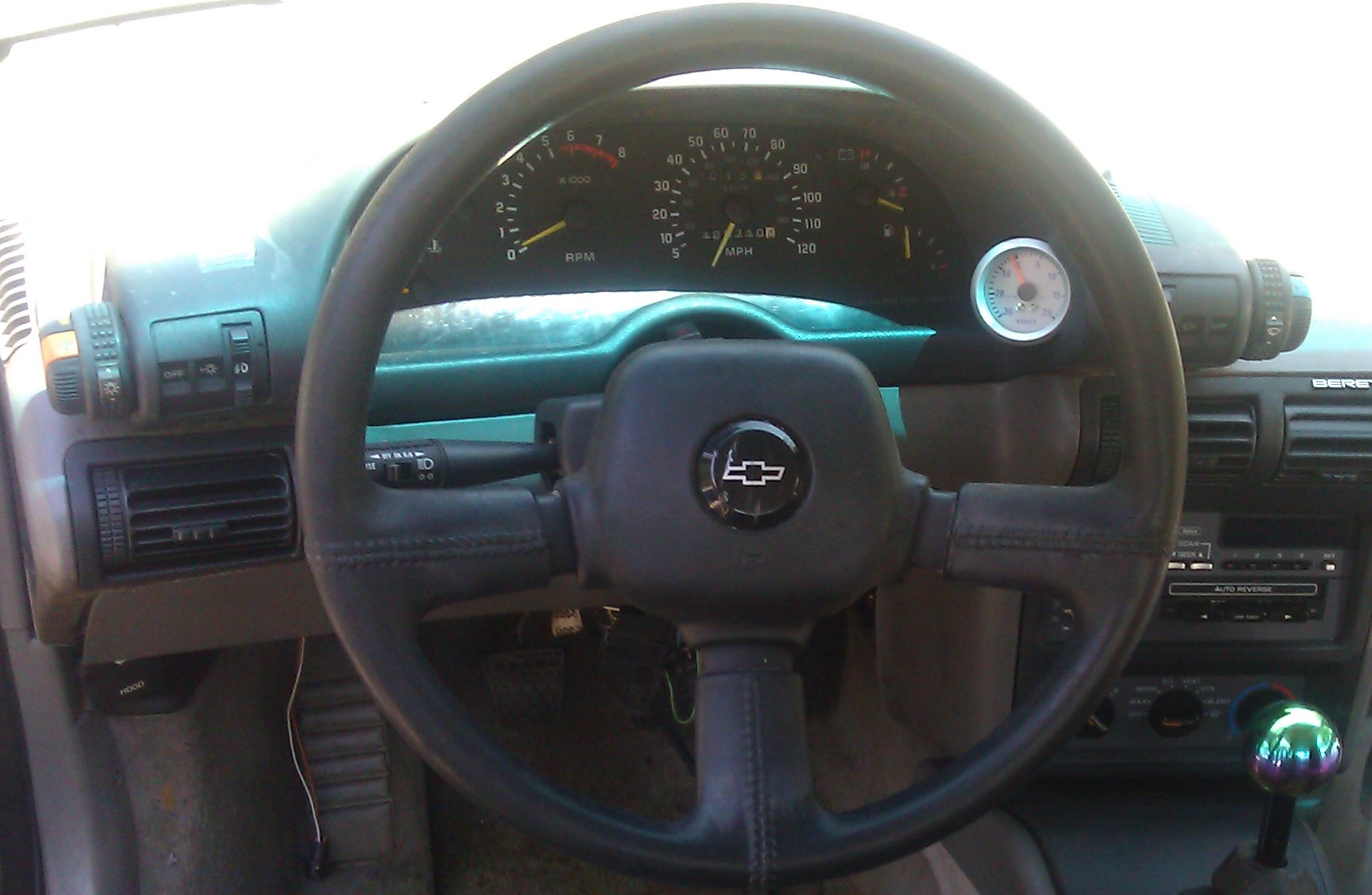

So, when I was 16..I was lucky enough to get my hands on a cherry 94 z26. Loved that car. Both my brother and I had a beretta as our first cars. His was a stunning 1990 gtz w41.
6 months into being the greatest driver alive..as we all think at 16..I find myself..hitting some trees, a guardrail, more trees, rolling the car 3 tines, going down an embankment, facing the opposite way in what's left of a car. That car..saved my life.
Now..I am in my mid 30's..and what do I buy..another red z26. And I bring it back to its home..200 yards from the old Wilmington delaware plant. Now she sits in my driveway and I am nothing more than a 16 year old kid again with deeper pockets, a skill to build the car as I wanted..and 19 years past the times where anyone makes parts.
After spending weeks sniffing around..not much to be had for these cars. Mostly stock replacement parts. I need some info on who still makes suspension upgrades. I'd rather have the thrill of the drive on the bendy bits of the road.
And possibly drop a 3400 in it.
That's enough rambling..just glad to be in a beretta again.

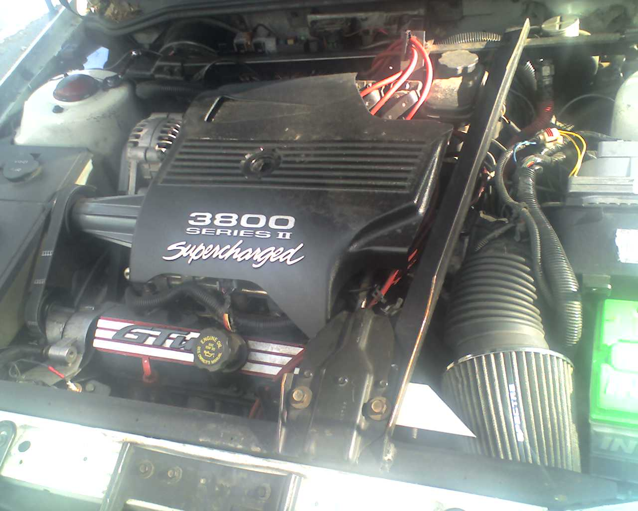

Am I seeing that correct that you have a 3800 swapped beretta??? I've been kicking that idea around.
Re: First car..again

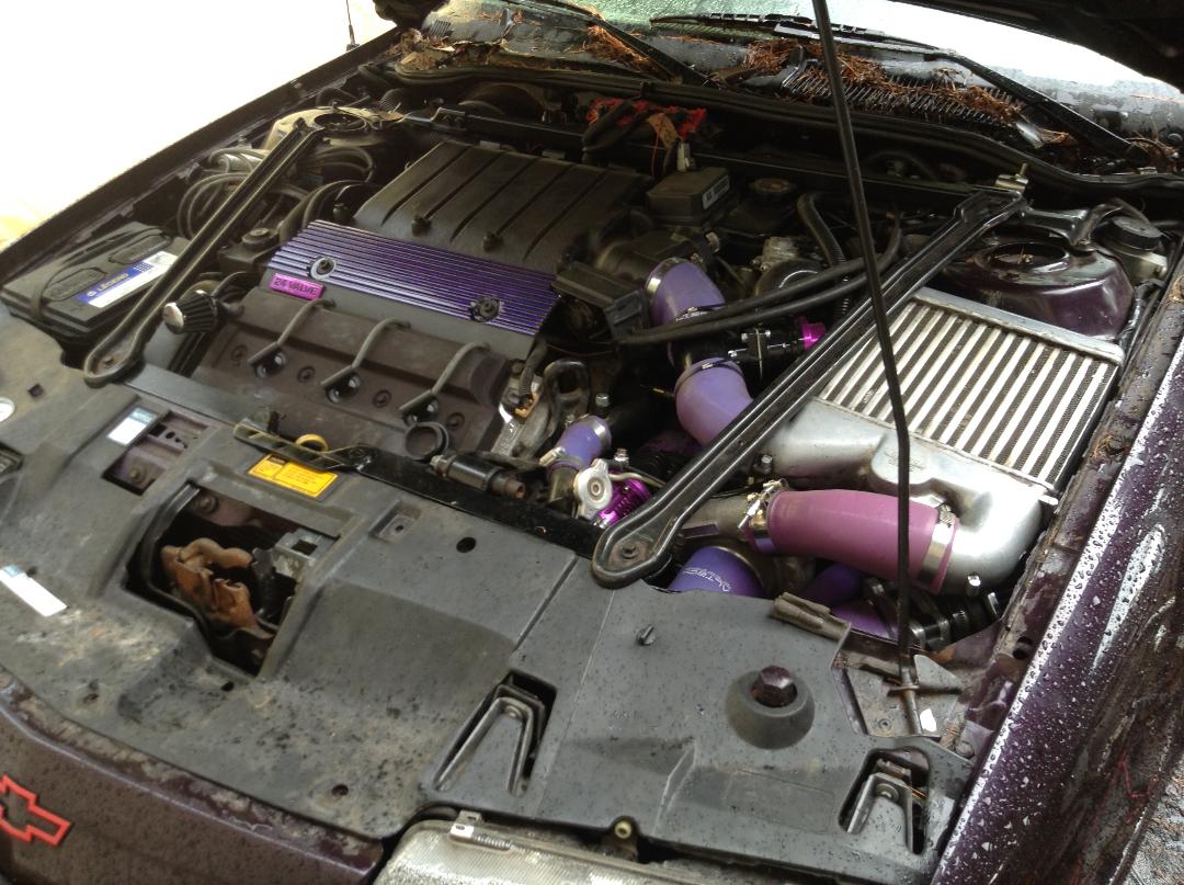

I wasn't the first one, but I might have been the first to say it was easy.
I'll eventually be doing another one, a Series III Super Charged, with a five-speed swap (again) into my Yellow Indy. I have a good formula that works on it for the build. The hard one was the Quad-Cam 3.4 V-6 Turbo...
I built the GTU well over a decade ago. I got some good feedback from the community here, but also had a handful of keyboard wrench-benders criticizing what they never heard or saw in person.
But this has been a good, reliable, very drivable car with very few problems over the years, and hellatiously fast for a car of its' era. The 3800's incredible torque started wearing on the old five-speed I had swapped into it, I bought a brand new 0-mile F40 Six-speed transmission, the '06 had taller highway gears than any other model, so that is what I got. Only one other Beretta has been documented after that here with a six-speed, and they used an '07 transaxle on a 3500 or 3400, chopped-up the firewall for the clutch pedal assembly and some other things. My engine swap can be almost completely removed (one ground-wire cut and a couple of holes drilled into a sub-frame) and the car restored to 100% original if I ever found it worth while to do.
If you have any questions about the swap, let me know. I had the whole thing documented over on Bstuff back in the day (the other Beretta enthusiast site), but when that site died it was all lost. I have SOME of it saved on hard-copy though, and of course the car parked right out front still.

Essentially, I proved it can be done with basic tools required for any engine-pull, plus a hack-saw (I used a Porta-Band), and a hand-drill (I also used a welder, but not strictly necessary). I spent a TON of effort trying to make a 'Hex-aust', six pipes and six mini-mufflers out to dual side-outlets with a pneumatically-controlled butterfly valve at each tip to regulate back-pressure, but couldn't get it quiet enough. The car has my home-built headers, extremely long primary tubes entering true dual collectors under the car past the firewall (such long primary tubes push the peak torque to a slightly lower RPM, but do little more in benefit) where I still had enough room for multiple mufflers before exiting to the sides in front of the rear-wheels (the car is still pretty loud) -this short-run exhaust does a lot to increase HP numbers, and reduces rear-biasing weight, leaving more forward weight distribution to enhance traction on the drive tires. I feel I 'engineered' the car, not just 'built it', but the basic building part was overall very easy.
Some detailed info for you:
I fabricated a brace (visible in the picture) that bolted to the engine's front upper torsion-mount then was welded to a steel angle brace that bolts to the upper radiator support -this is essential, as the 3800 has enough torque to bend that radiator support dramatically if it isn't bolstered -most 3800 swaps they just cut out the support and weld-in a stiffer piece, but I didn't want to chop my GTU up at all. The bolt-on brace works 100%. There is also a drop-leg down to the rear cylinder-head to support the rear of the engine's weight, where I mounted the ignition coils, the support then bolts to an early '90s H-Body (full-size, like Fleetwood, I think) strut-support, so there is basically a capitol "H" framework riding over the engine, bolting to the strut-towers in back, the radiator upper core-support along the front, and supporting the engine at two points front and rear. I modified the SC belt-routing (mine has two accessory belts, not all 3800s did) to free-up the foremost pulley bracket, which then bolts to a small steel plate which in turn bolts to the car's front upper engine mount point, which will NOT exist on your newer '94 Beretta... Most 3800 Series II engines had a lower mount under the crank-pulley, there is a cradle bolted to the engine, I ground mine down a little to clear the shorter Beretta CV axle on the passenger-side, the rubber mount part got ditched but the cradle attached to the engine is bolted to a piece of 1.5"x2" angle, maybe 8 inches long, which in turn bolts to the passenger-side sub-frame (two holes there). The 3800 S-IIs had a few different oil-filter mounting pads available, you might have to search scrap-yards to find one that works. The filter itself is easily accessed through the passenger-side wheel-well, easier than the stock V-6... My drivetrain was initially supported by six points to the car's frame (I lost one when I put the 6-speed in), instead of the stock four. For your car, look for a '90s Grand Am with the 3.3, take the passenger-side engine mount (all of it), and you should be bolt-in ready (the 3.3 shares the 3800's block, basically, and the Grand Am's N-Body platform shares the Beretta's L-Body engine-bay and framework forward of the firewall from '92 to ~'96). Fuel lines should plug in for you, might need to be extended though. Wiring was easy for me too, but the Super Charged versions often have a multi-speed fuel pump with a separate module (mounted in the trunk on most donor cars). The module will require the use of the 'correct' fuel pump, and will need a dedicated ground-line to the fuel-sending unit -the earlier digi-dash cars, like my GTU and Yellow Indy have, offer that extra ground wire for the more finicky fuel-gauge, so I just had to cut and splice into one of them -I tapped in under the rear seat on my car, no one would ever find that small modification. I used the 3800's PCM, jumpered the transmission range sensor wires to make it think the car was in 'drive' mode, and just piggy-backed the PCM's harness in the engine-bay. Everything plugged into the Beretta harness, so far as power was concerned. I never got the car's digital tach working, but have ideas for when/if it is important enough for me, but I have an array of white-faced add-on gauges in the car, included an analog tach. Depending on which transmission you are planning to use, you might encounter some issues, but nothing too difficult.
If you have your exhaust-work done by a shop, you could have everything else done over a couple of dedicated weekends, I would think, depending on your technical abilities. PM me some time if you ever get lined-up to do this, I would be happy to assist with any technical details beyond what I've already outlined here, including wiring info.
