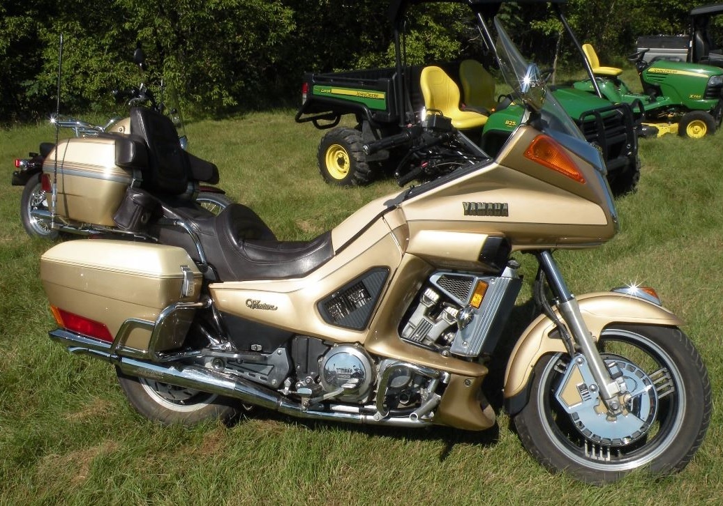

While not my actual Venture, this is a beautiful example of what mine once looked like...

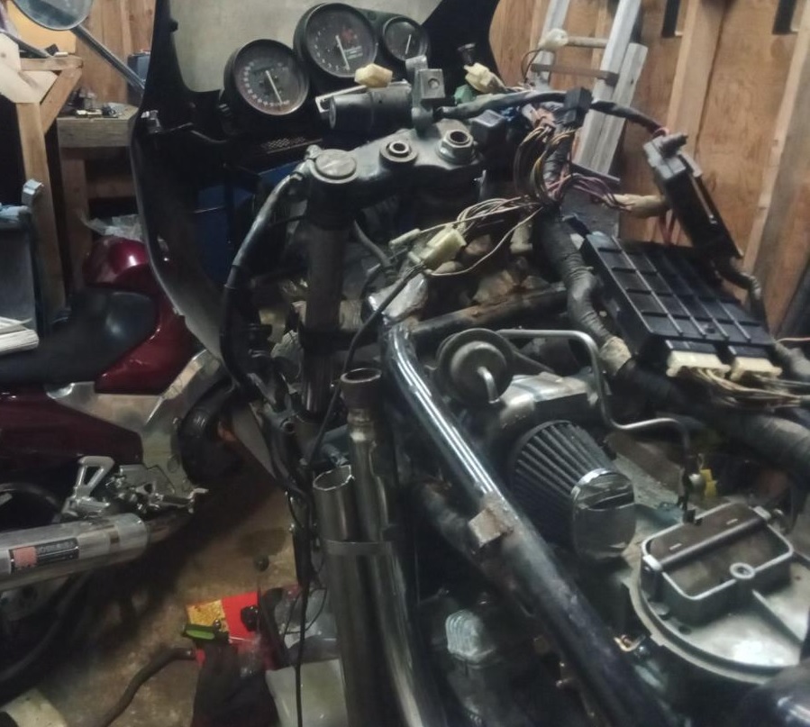

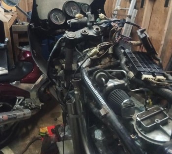

Still in mock-up condition, the turbo and exhaust-system are getting 'sorted-out' here. The frame will need some minor rust treatment, the wiring-harness will be gone through, and the basic mechanical systems will be inspected and overhauled as needed, and that may be the easy part of this...

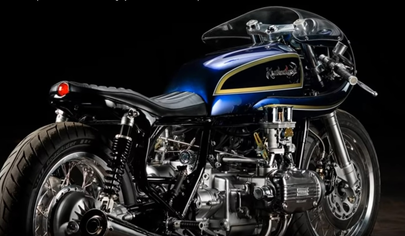

I've been highly inspired by high-end bike-builds like this one:
This is a vintage Honda GL1000 Gold Wing with a Flat-4 engine turned into a Cafe`Racer-style bike. I had to scrap an old 'Wing just like this used to be last year, but this shows what old bikes are capable of becoming.
I do NOT expect to achieve results anywhere near to this level of quality, but I am more interested in the style and the process of the build itself than I am the final performance output or cosmetic detail of this particular machine. To be bluntly honest, I don't think a bike of this age and technology-level with the steering geometry, suspension, and tire-size it can run will ever be up to running with some of the bikes I already have on the street, let alone the modern bikes on the market today. I can put things together and get them to work pretty well, without investing in a lot of money to do it too, but there are certain skills I have yet to master, or even get good at. But I really don't need to blur the world more than I already can, so if I get some decent pull from this bike and get to hear the turbo spooling between shifts and get the BOV to trumpet the potential this could have with real money sunk into it, and still like the way it looks -odd and goofy as it will likely be- I'll probably be happy enough with it for what it is. When someone scoffs at the aesthetic quality of my TIG-welds on the Stainless headers or the paint-quality and sheetmetal fabrication underneath it , I will just smile and ask them what THEY built that day... So far, I have upgraded the ignition system to COP (Coil On Plug), started building a (mostly) stainless steel exhaust system, fabricated a two-into-four intake manifold system to use a simplified blow-through 2-barrel carburetor setup, and done some basic maintenance-work on the engine to get it ready to actually run. I have a mostly complete V-Max 1200 engine I can assemble if this one is bad, but I have already cranked it over and it sounds mechanically healthy, so worst case I will probably pull this 1300 and rebuild it if I have to.

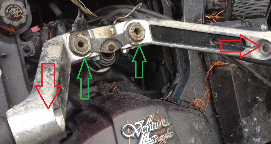

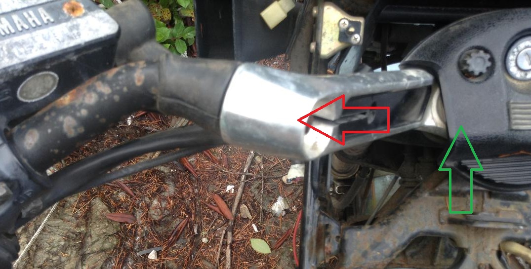

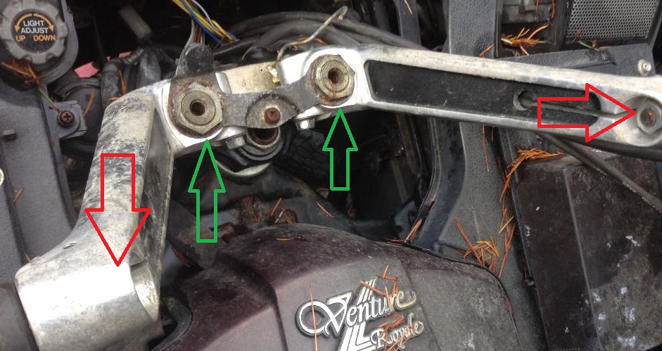

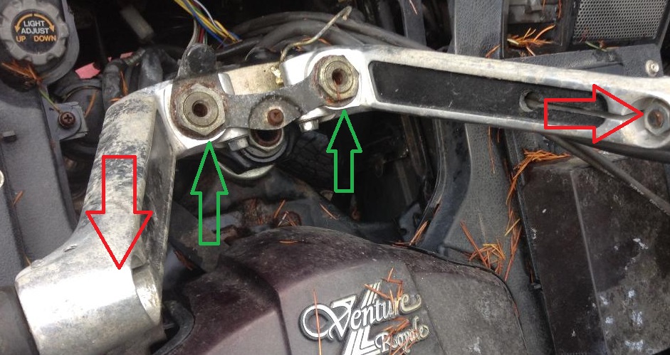

Just got a rotary-table (precision machining fixture -weighs a little over 60 pounds) to use with my metal-shaper (old-school linear carving machine -weighs maybe 170 pounds), so once I build a mounting-table/rail for it to use with the shaper (strong enough and sturdy enough to hold the machining equipment without deflecting during work), I will be ale to cut internal splines with a VERY high degree of accuracy. This will let me fabricate mounting-brackets (billet) from aluminum or steel for the spline-end handlebars and mounts Yamaha used on the Venture, so I will have handlebar adjustment in two planes, allowing for a high degree of customization and adjustment in riding position.
These two pictures are of Mk1 Ventures, but the bars are the same as my Mk2. The bars can be adjusted for height/pitch at the [red] pivots (splined) and rotated forward or backwards at the [green] pivot-points (splined) for a high degree of adjustability. I will basically be removing the aluminum stand-offs and replacing them with billet blocks to lower the bars for the Cafe`-Racer styling and more aggressive riding position.
My Honda VF1000 came from the factory with a single-plane handlebar adjustment, but it was pretty useless as only one or two positions were remotely comfortable. I've raised the bars on that bike a few inches (and lowered the front-end at the same time, which also increased the steering-rake angle, making an already responsive race-bred bike even more responsive). While I am lowering the Yamaha's handlebars SEVERAL inches, I will probably also lower the front of this bike as well.
