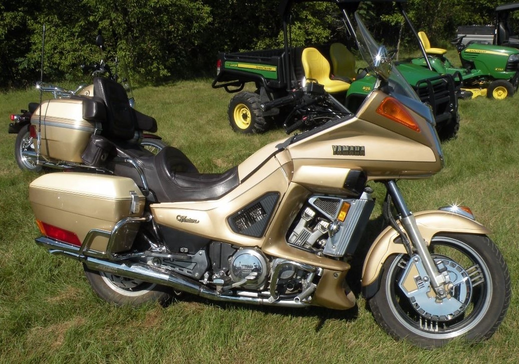

) in case I actually find time to tour again, I ran across a Yamaha Venture 1300 full-dress touring bike that needed more work than it was economically viable to give it... A proverbial money-pit, out-dated and over-weight, complete with tape-deck and trailer-hitch, and luggage big enough to stuff a spare pair of helmets, a wedding-gown, and a three-piece polyester suit into, and still leave room for three trained monkeys, a complete Duran-Duran album collection on cassette, and a picnic-basket... Well, shoot son, sign me up!
(but keep the monkeys!)
So, here it is... A decades-old hard-iron and aluminum chunk sitting beneath heaps of antiquated electronic gizmos interconnected with yards and yards of aged wire, all encircled with as much plastic and plated-chrome as Japan could coat a two-wheeled frame with.
But at the heart of it, beating with 1300cc's (that is 1.3-liters, or roughly 79 c.i.d.) is a ~100 HP quad-cammed 16-valve V-Four that churned out enough torque to move the 780-pound luxury behemoth two-up with a week's worth of luggage up an onramp into dense urban traffic without stressing the engine or causing a twelve-car pileup. The earlier version of this engine, which was 'only' a 1200cc powerplant was also shared with the well-known '80s-era muscle-bike and wheelie-addicted V-Max. While the 'Max had slightly superior cams and valve-sizes, the biggest difference was the lighter-weight of the V-Max and Yamaha's use of "V-Boost", which was simply a set of valve-controlled intake cross-over tubes that let each cylinder pull air through two carburetors at a time, instead of just one. Personally, I felt it was time to just blast the 1300 V-4 with forced-induction and simplify the process...

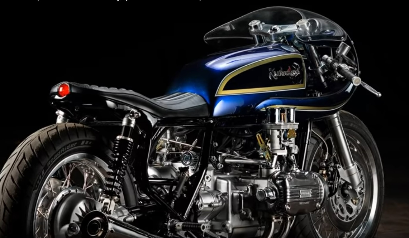

I've been highly inspired by high-end bike-builds like this one: I do NOT expect to achieve results anywhere near to this level of quality, but I am more interested in the style and the process of the build itself than I am the final performance output or cosmetic detail of this particular machine. To be bluntly honest, I don't think a bike of this age and technology-level with the steering geometry, suspension, and tire-size it can run will ever be up to running with some of the bikes I already have on the street, let alone the modern bikes on the market today. I can put things together and get them to work pretty well, without investing in a lot of money to do it too, but there are certain skills I have yet to master, or even get good at. But I really don't need to blur the world more than I already can, so if I get some decent pull from this bike and get to hear the turbo spooling between shifts and get the BOV to trumpet the potential this could have with real money sunk into it, and still like the way it looks -odd and goofy as it will likely be- I'll probably be happy enough with it for what it is. When someone scoffs at the aesthetic quality of my TIG-welds on the Stainless headers or the paint-quality and sheetmetal fabrication underneath it , I will just smile and ask them what THEY built that day... So far, I have upgraded the ignition system to COP (Coil On Plug), started building a (mostly) stainless steel exhaust system, fabricated a two-into-four intake manifold system to use a simplified blow-through 2-barrel carburetor setup, and done some basic maintenance-work on the engine to get it ready to actually run. I have a mostly complete V-Max 1200 engine I can assemble if this one is bad, but I have already cranked it over and it sounds mechanically healthy, so worst case I will probably pull this 1300 and rebuild it if I have to.
