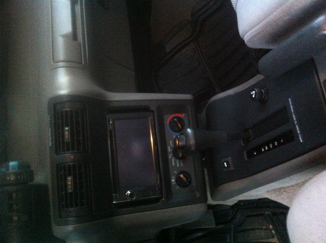

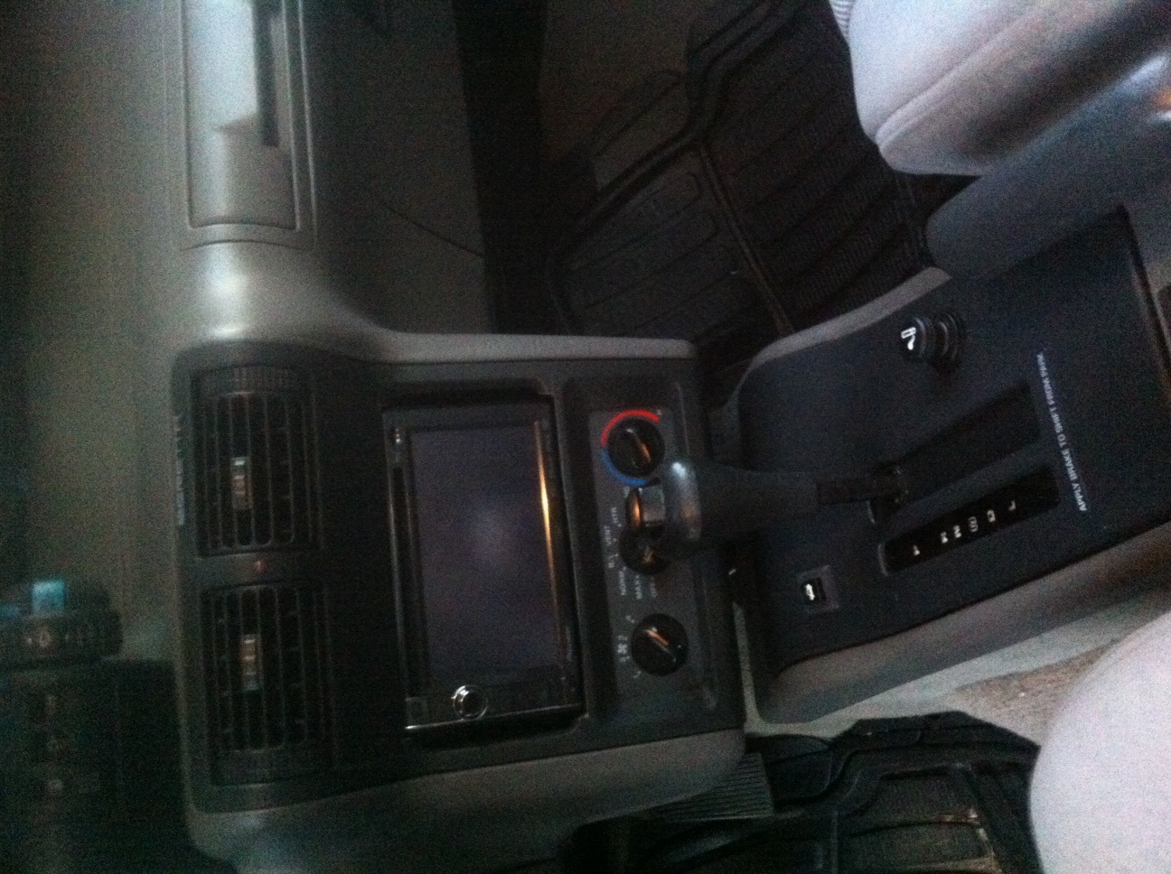

just currently looking at making a faceplate/mount, and some trimming can be done upwards towards the vent. i dont have a double din deck to try, but i dont think it would be too hard. you would have the trim the stock vent/facia plate up towards the vents as well... then depending how picky you are, blend it into the deck area nicely

Re: double din
Post by 96/z26 »
Just need to have a fascia custom made to clean up the bezel
