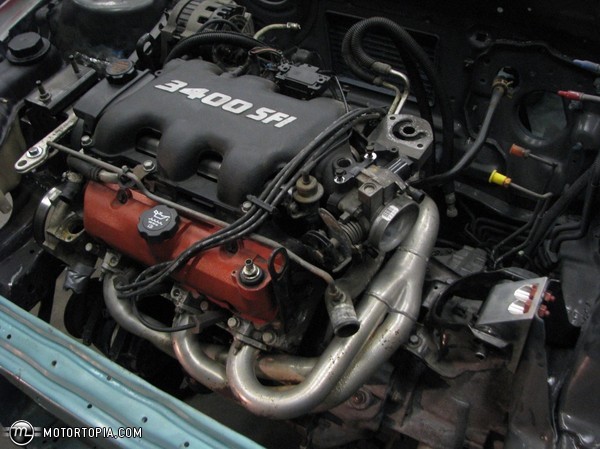

I got the billet upper mount from white88gt on bstuff, but unfortunately they have been discontinued... as well as all the FFP stuff in my pics. Some of it is now available from MRZ Performance though.
Here's a good pic of the upper:
And the lower:

91 and older berettas use a front/back engine mount. Same as gen 2 j bodies
Woody upgraded to the 92+ style, you have to weld the top one in and use a 92+ subframe iirc.

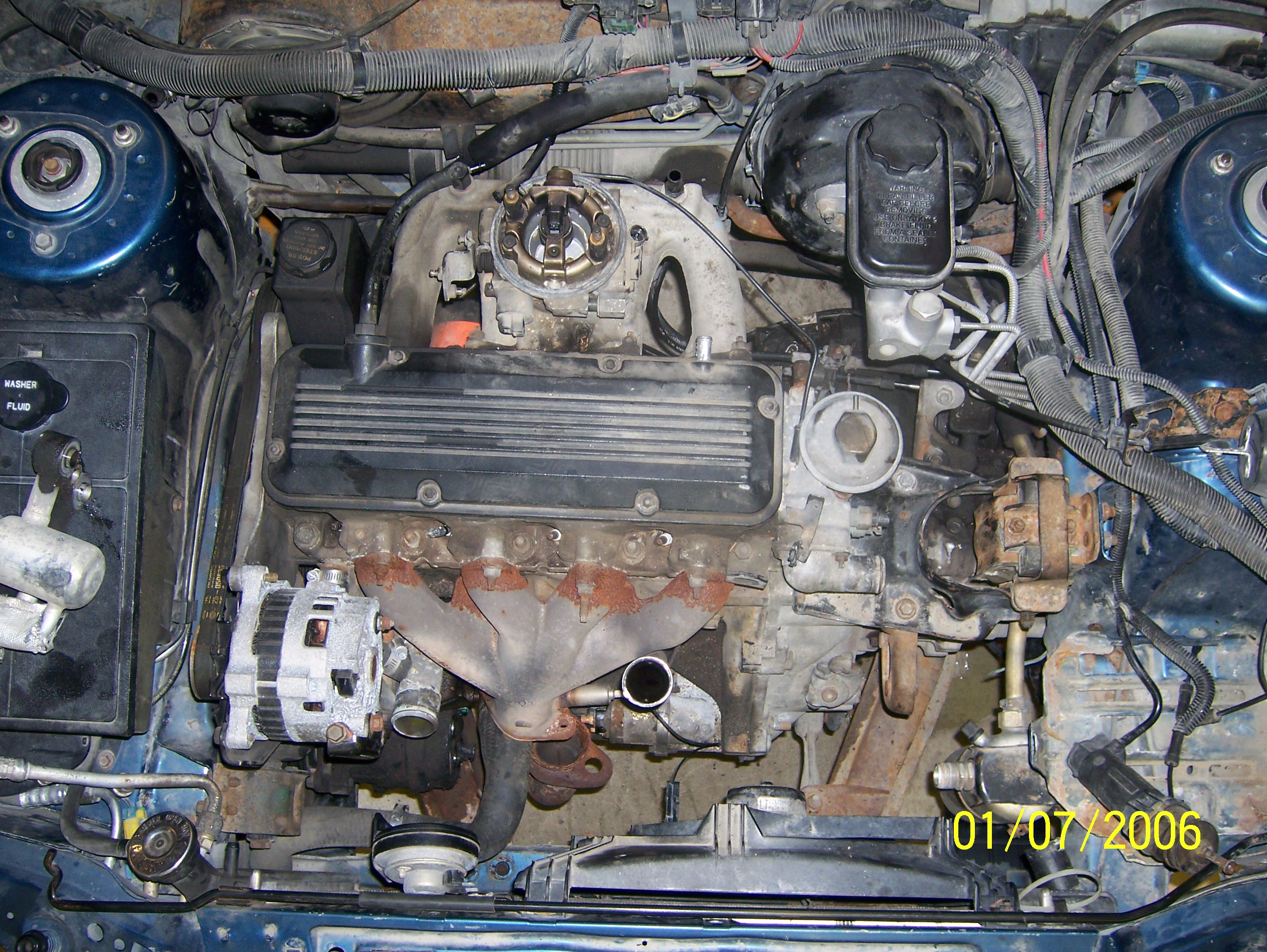

Well I have a 91 that had a 2.2 in it. I thought he didn't have a 92+ tranny setup.
That would be mine.
That would be his.
I am guessing that the front/back mount is on top there.

No, he has the 92+ motor mounts and the pre 92 tranny mounts. His trans mounts are the same as yours, even with the 4 banger.

I have that little bump stop on my trans, but I'd guarantee I'll never need it with the poly dogbones. That drivetrain doesnt move one bit.
And just to verify, Barry is correct. Mine has the factory 91 trans mount and trans dog bone, with the 92+ engine mount welded in and the 92-93 subframe and engine dog bone.
