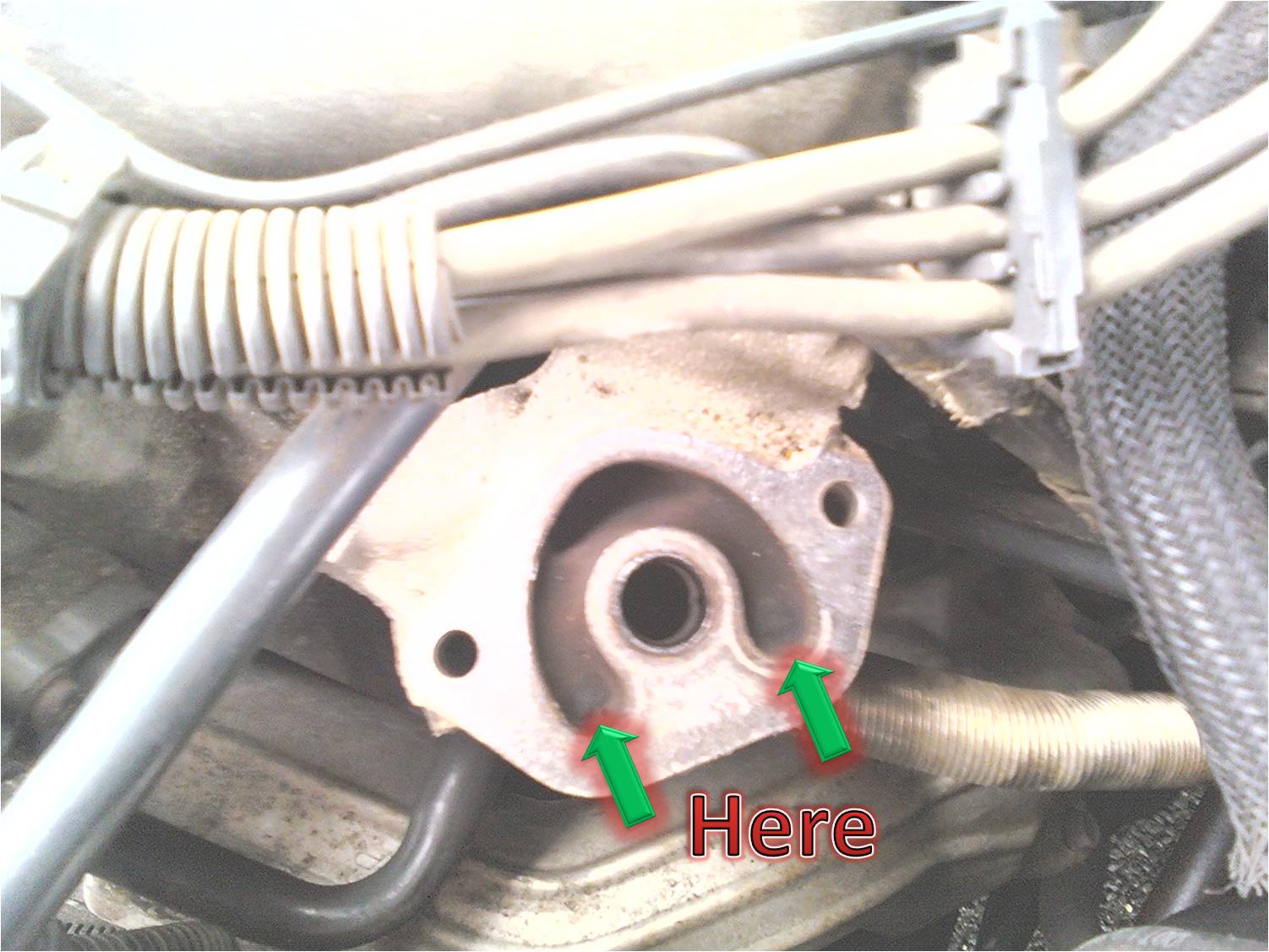

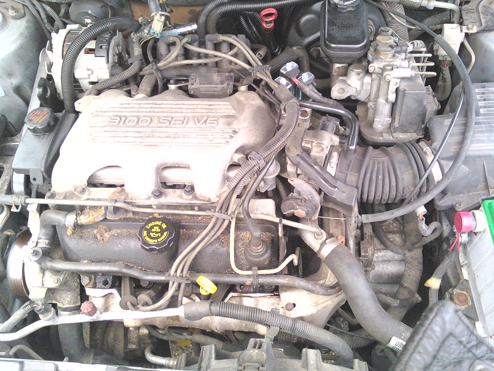

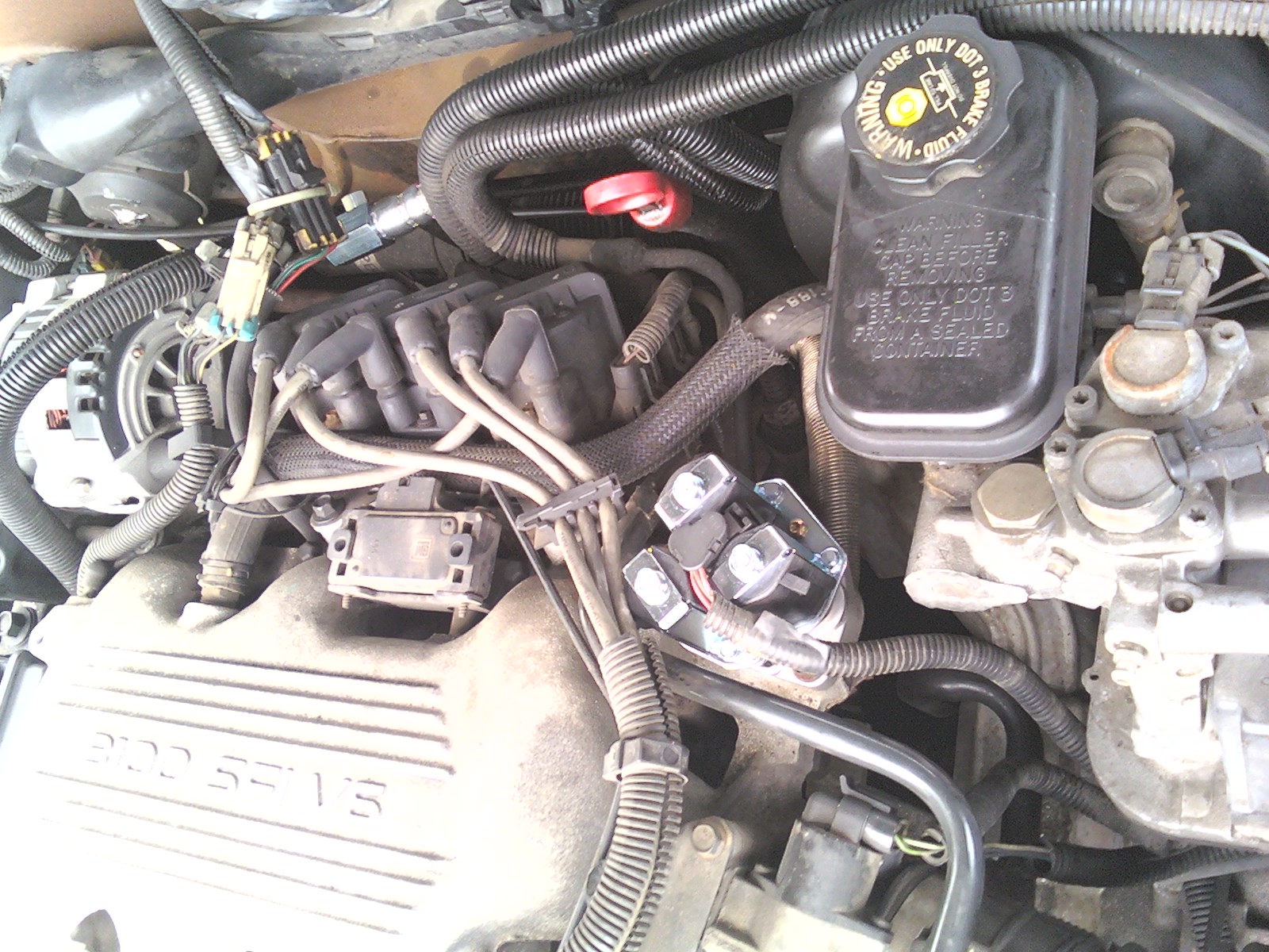

I guess this is one time being bad with names is really biting me in the a$$... so I've attached pics because even though I might have an idea of what some of these things are, like TB=Throttle body, but not sure which O-rings you mean, if you want to draw on it and send back with labels, that would help a lot, like 1)=Throttle Body, 2)=Another Part i need to clean/check.. I know which are the EGR, MAP, wires(of course), ignition coils, few more, but won't be offended if you label something i already know - too much info in this case is so much better than none..
In one of them I took the EGR off again to show you what I was referring to with the carbon cause I didn't know the name (Marked it "Here", the horseshoe shape - what's the hole in the middle?), even though you probably already knew but I wasn't sure which parts were what when you responded.. Didn't really check the hold in the middle, but the horseshoe part was really black, not gooey, just lot of carbon build..

I don't know how to draw anything on your pics. In photo 1, the port is at the top, just above the hole in the middle. In photo 2, the IAC is the black round thing on the TB. The O-ring is on the IAC, you will have to take the IAC off to see it. Oh just in case, the TB is in photo 3, it's the one that the air cleaner housing is connected to by the large black tube(the one that comes from the side of the car). The TB must come off so you can try to clean the EGR port on the inside of the intake. I wouldn't take the EGR off too many times without putting a new gasket on. The TB will need one if you take it off also. I have to stop now and ask something. When was the last time you put plugs and wires on? I see that you have one new coil. If you lose another then the ignition control module is bad(it's under the coils). You have a MAP sensor, but I don't think it will help(put it on anyway).
Re: 95 Beretta 6cyl- intermit rough idle/run/stall
I don't know how you can see that in the pic, but yes, there is one ignition coil that was changed about 2 or 3 years ago, maybe even 4 not sure (show off
) .. at the time, it looked like the same one was replaced before and the other 2 might have still been original (the other two were still labeled with numbers, but the one being replaced had no markings).. it had the same intermit. issue then but it has gotten a bit worse as time goes on..
not sure about plugs and wires.. it's been a couple of years, that much I know.. if memory serves right, I think we did wires and plugs then too, but I could be wrong.. I can pull a plug and check for carbon.. supposed to rain tomorrow, so might have to wait an extra day.. wish i had a torque wrench though, always worry about under- or over-tightening plugs especially - really don't need them to leak, and really, really, really don't need one to break off..

He called it by the numbers being gone.Ctimbers wrote:I don't know how you can see that in the pic, but yes, there is one ignition coil that was changed about 2 or 3 years ago, maybe even 4 not sure (show off)
BUT have you had your ICM tested yet? Its the ignition module below the three coils. If that starts to go haywire you will get a rough intermittent idle.

The middle coil on your car is cleaner than the others, that's how I knew it had been replaced.
