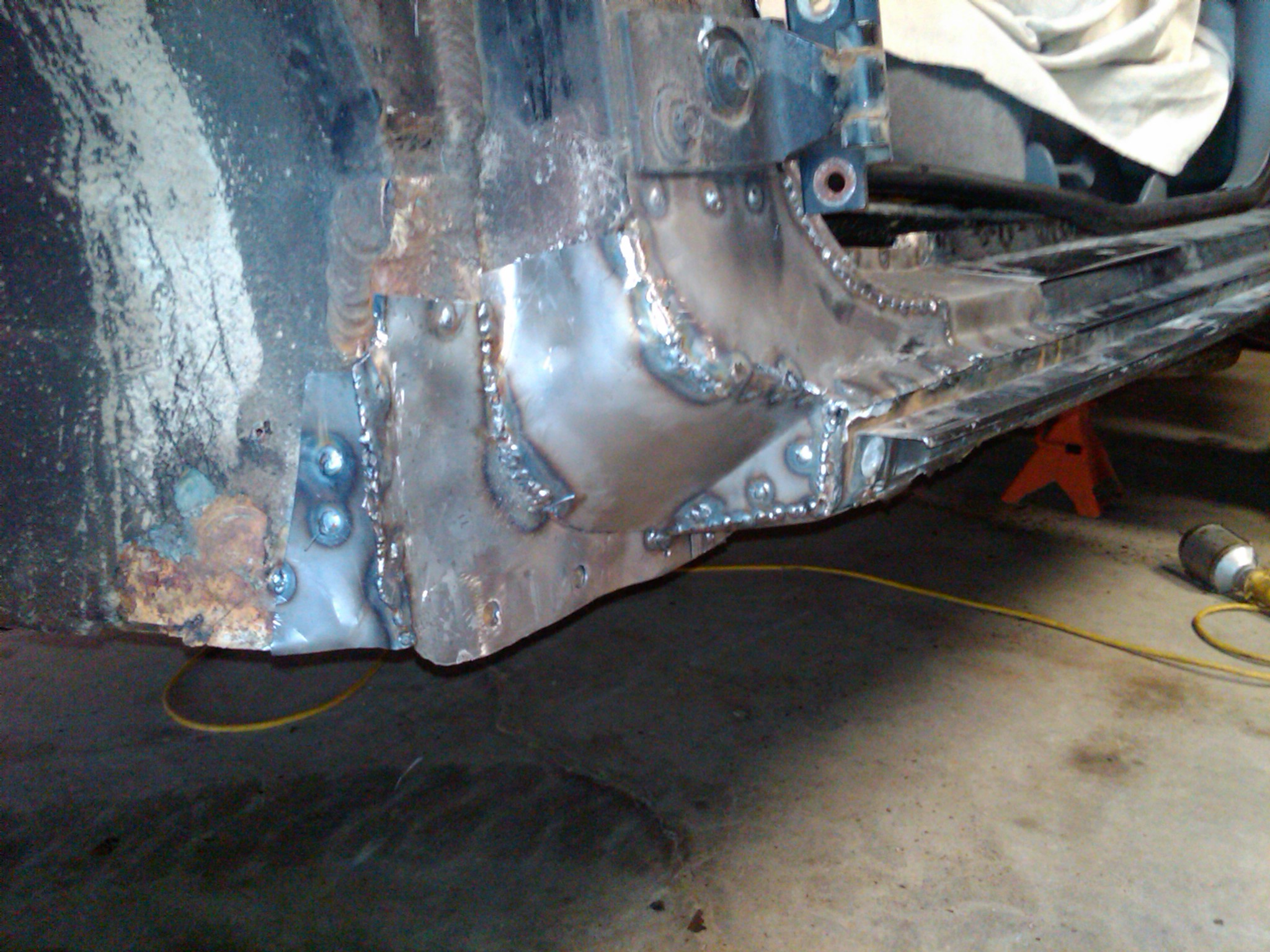

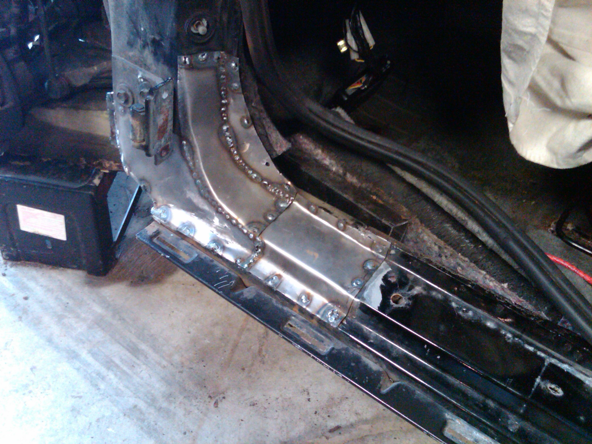

On the GTZ front I have made temp patches to the rockers and hinge pillars while I look for permanent repair parts. Didn't want the car to break in half if I decided to take it out for a cruise around town! I am working with a local GM dealer to see what OE repair panels are still avail. We'll see. If nothing is avail I will have to either find a doner car from the south or west or fab all new parts.

That's some nice patch work there. If you had the time to come up with a few permanent ones you could save alot of cars out there. Most of us get our parts from the junkyard and that's the only place to get console lid(unless someone here has one).

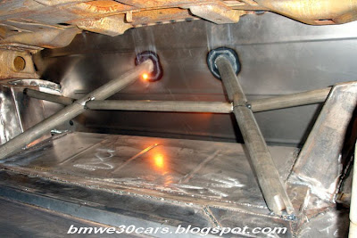

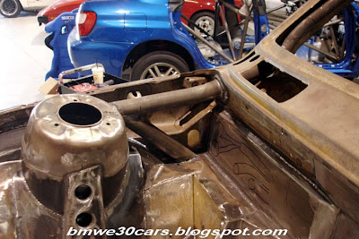

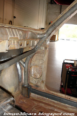

I have some input for this, Well built roll cage is the best option, at least '12 point' like they say it in US? It has to be connected to top of all the suspension supports. Feature that i really rarely see on US built race cars, since those cages are only there to secure the driver, not to improve chassis rigidity... This is the standard way to handle it in Europe tho.Now what is the best way to go about stiffening the chassis?
Some example pictures to explain what i mean:
Pipes supporting the front suspension
Connected to the roll cage.
How rear suspension should be supported
I've been looking into Jegs "jegster" roll cage kits, they do have one 12-point that is made for a Beretta, but since i haven't ever seen installed pictures about it, cannot really tell how good it is and how does it fit. Anyhow since it's really cheap, I have planned to order one for the beginning point of my roll cage project, since it doesn't fill up my or law's requirements here, it's going to need a lot of added pipes & changes to make it work on my application...
Everything else than a cage just makes things worse in the long run, you could fill up the body enclosures with a special foam engineered to that purpose, and / or re-weld the cars body for more rigidity, but both of those will accelerate the rusting process on a street car tremendously, methods mostly used on race only cars. One idea is also to remove the rockers first and then add square tubing inside it, but that doesn't really support the load-points of our cars.
You could also take a look how the convertibles were reinforced the factory way.. There was W-body pictures about this posted @bstuff if i remember right?
And what i Personally think, the chassis rigidity is not the biggest woe on our car when it comes to handling improvements, it's the loose wobbling rear axle, I have some solutions on the line for that too.. off course all this doesn't matter if you only go straight line.
