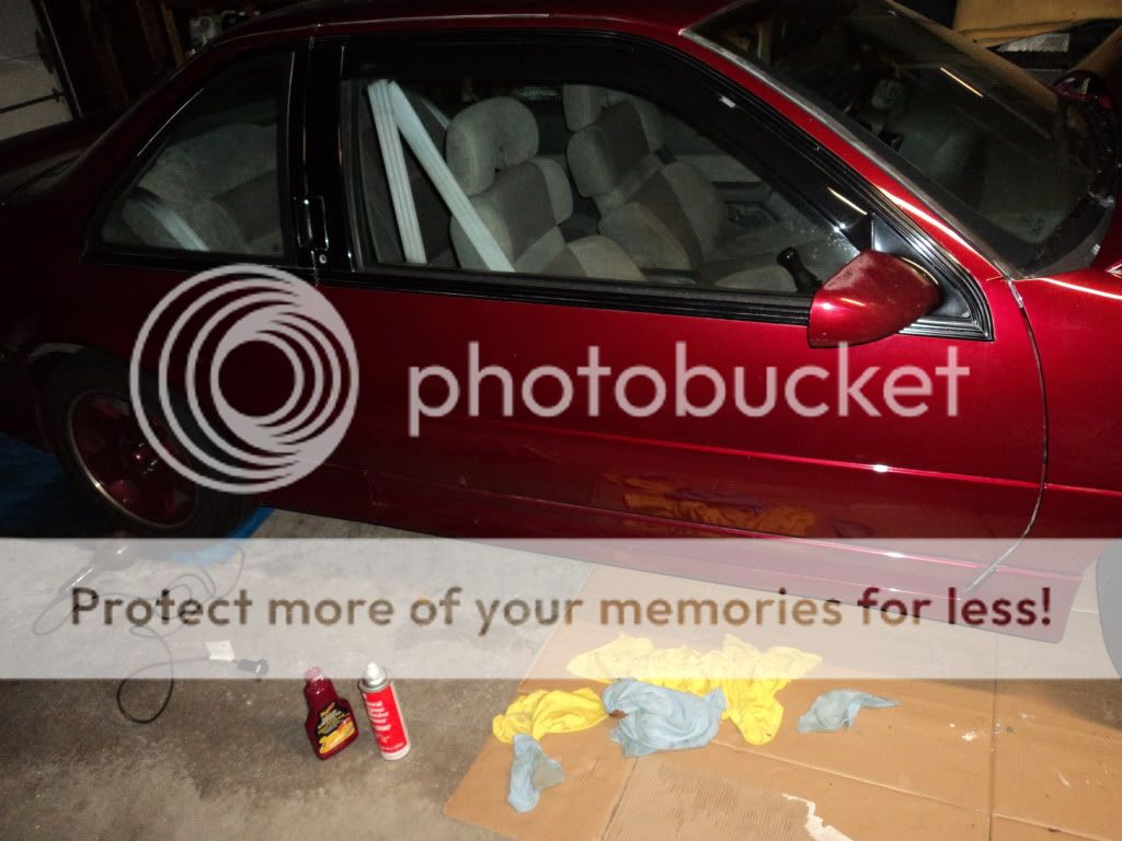

I finally couldn't stand to look at the faded, craptastic side moldings on the zed.
So after grabbing the hair dryer, removing the strips, the tape and getting the meguirs paint cleaner out to remove old wax-tape-crap from the paint, I was left with sexy.

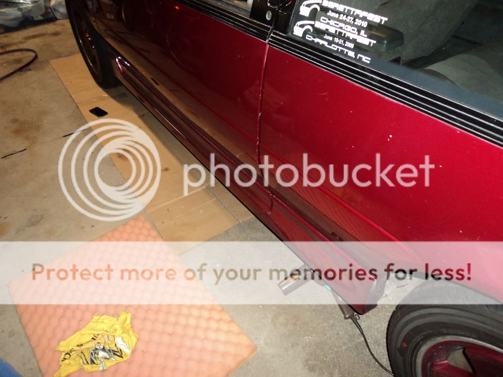

Drivers side looks really nice, didn't even need to use the buffer I went out and bought today. No lines, no faded paint, Huzzah!

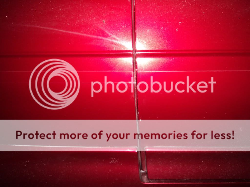

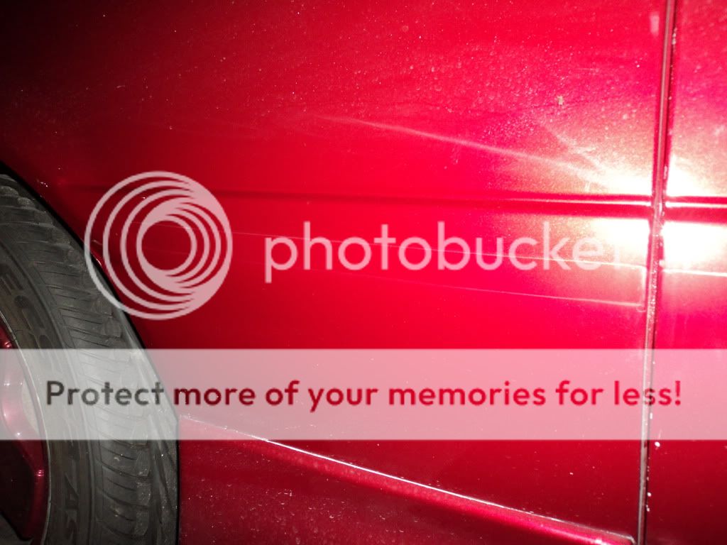

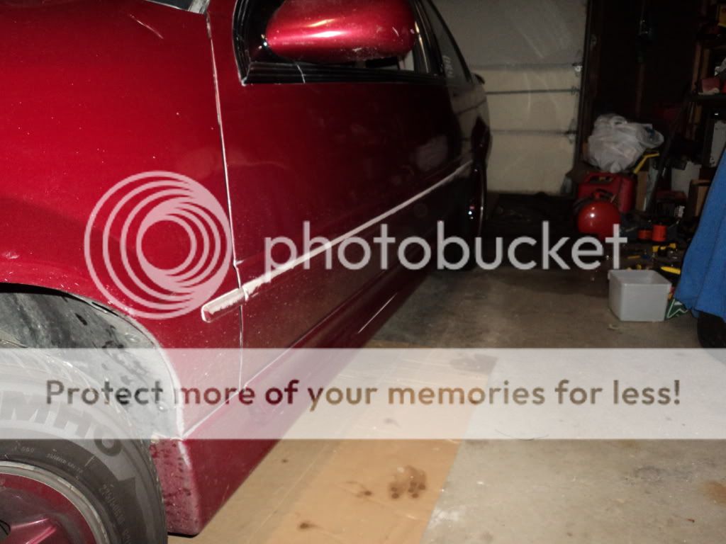

But, the passenger side did not fair so well. This is where I need help.
See the lines? I haven't even seen them in the sunlight, only the shop lights.. and they annoy the crap out of me. When I try and clean the paint, nothing is removed. I tried a clay bar thinking it was REALLY sunk in and got nothing. My fingers want to tell me that the lines are IN the paint, like grooves that somehow formed either over 20 years, or were there from day 1 factory.
What are some others options? polish compound perhaps? take it to a professional? Ask Sun God Ra to fix it nicely?

Looks good... Can you actually feel a ridge on the edge? It may have been re-painted some time before you got it. If all else fails, wet sand and buff. You may be able to get away with just compound though.

I'd prefer to stay away from sanding of any kind. I can't feel a lip, it's just more of an indentation in the paint. Shallow but there.

The very fine end of things is something like "Scratch Out" by Kit, in the yellow bottle. Coarser options would be something in the 3m "Perfect It" line of products or similar.

I had the same issue with my 95 and I never did get it out. I think it was repainted with the molding in place.

Then you have the following option:
Wetsand it, using a hard sanding block, but use a very fine grit paper, like 750 or higher. Only sand it till it is near flush. THEN polish it back. You should have enough clear around it to be safe doing this. Providing you take your time and check your work as you go. Always use long strokes going with the length of the car, and don't "spot" sand. Meaning don't just sand where the "line" is, feather it out a bit.

Yeah I'll have to try that. I told pride he gets to help me work on my car for a change, instead of me working on all his. We looked at it in the light and realized that at some point they repainted the top half of the door and the rear panel. Still looks nice, and the drivers side has no lines to speak of!
So for those that want to do it, 20 year old paint looks nice under those strips.
