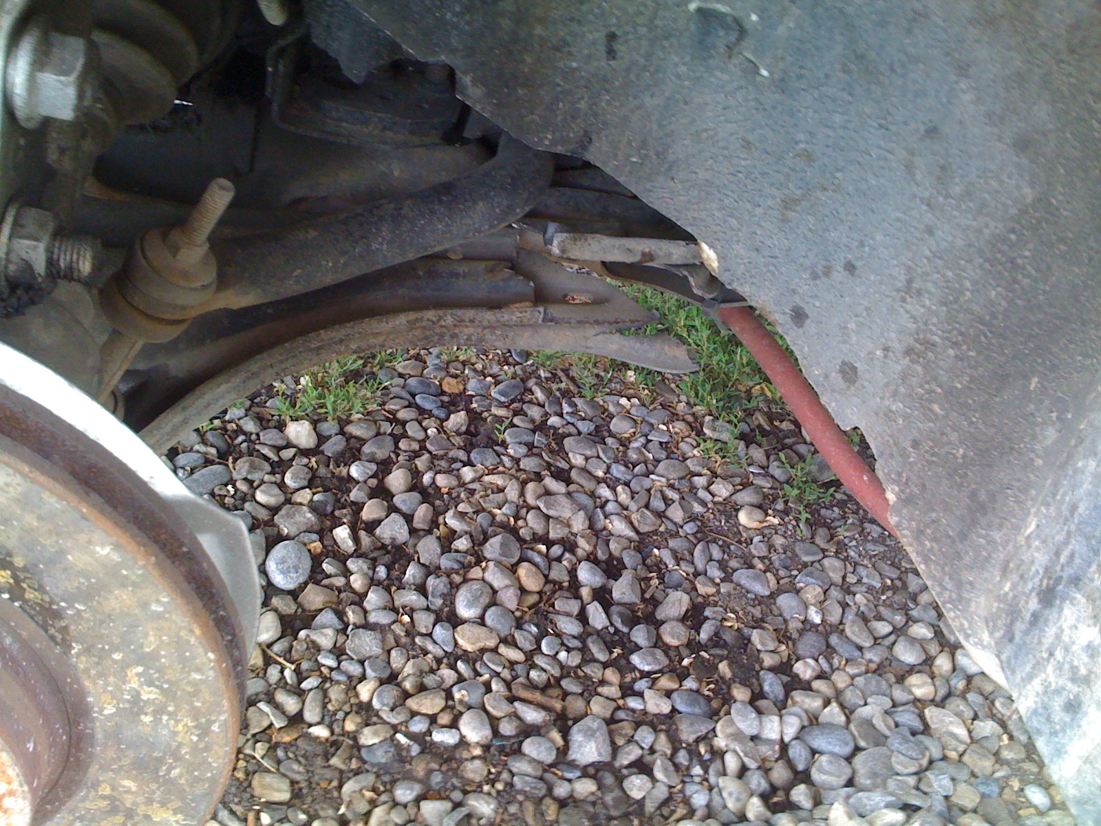

I snapped my control arm last week (ill post some pics). I now have replaced it but i think it might have hurt some other parts when it happened and wanted to know what everyone’s thoughts on it.

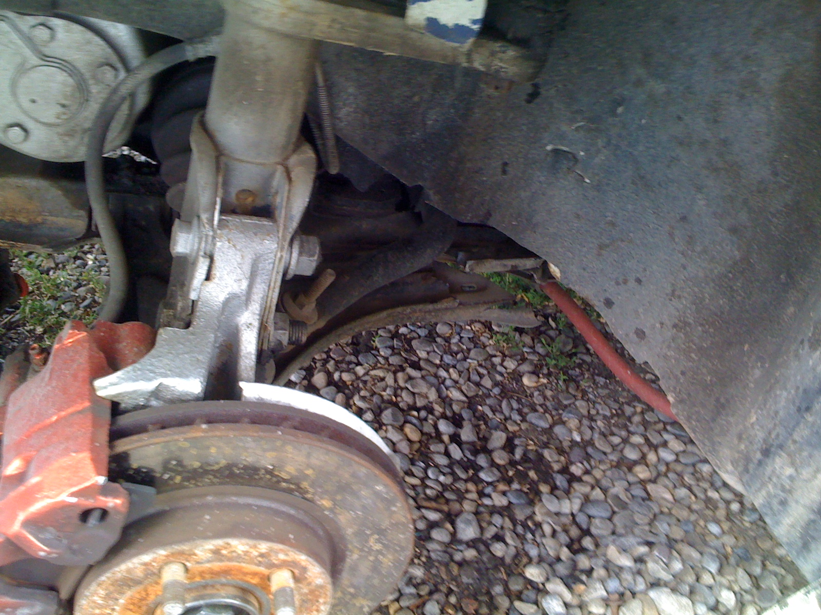

here are a few pics after i put in the new one

Happened to my Ex's sisters corsica, the control arm split right in line with where the sway bar attaches... Responded just like a ball joint failure and the wheel went back and bent the hell out of the left front fender, Pulled the axle apart and all that jazz... I have pics somewhere.
beroutofjtown
Posts: 181
Joined: Thu Apr 15, 2010 8:51 pm
Re: broke my control arm
Post by beroutofjtown »
On my Beretta one of them snapped on me and the other one was cracked and going to do the same thing.
They both were cracked right where the sway bar is, if I were anyone here I would get the wheels off and check them.
