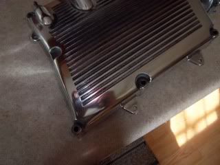

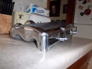

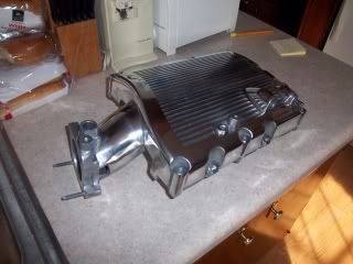

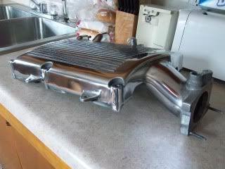

just posting some progress and finished pics up for everyone to enjoy.
a little info on the steps i took:
-to start off, i used 80 grit with a d/a to get through the casting bumps and flaws
-once the plenum was smooth, i started sanding by hand
-i started with 100 grit, and once all of the 80 grit sand scratches were removed, i went to 220, then 320, then 500, 600, 800, 1000, 1200, 1500, and wetsanded with a trizac pad with a d/a to remove the rest of the visible scratches.
-next, i went to my local discount tool store, and picked up an aluminum polishing kit. the kit i picked up for a drill was a waste, because it doesnt spin near fast enough to really polish the aluminum. so i went back and picked up a polishing bonnet that is used on a bench grinder. that worked very well!
-next, i slowly went around the plenum, using little compound and lightly running the intake across the machine.
results!!!
any further questions feel free to ask! i will be starting on the valve covers here soon, which i will add to the post

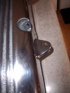

Very nice. I'd cut those stupid ears off the front though..

well, 12 hours of sanding. so yes, a lot and a lot and a lot of elbow grease. haha
as for the ears, i would, but talking to dave (superdave) he regretted cutting them off. so i figure if i decide i dont need em, i can just grind and re-polish

3400beretta wrote:Very nice. I'd cut those stupid ears off the front though..
my thought exactly.
cut the ears off an re-polish the front and it would look so much cleaner up front.
