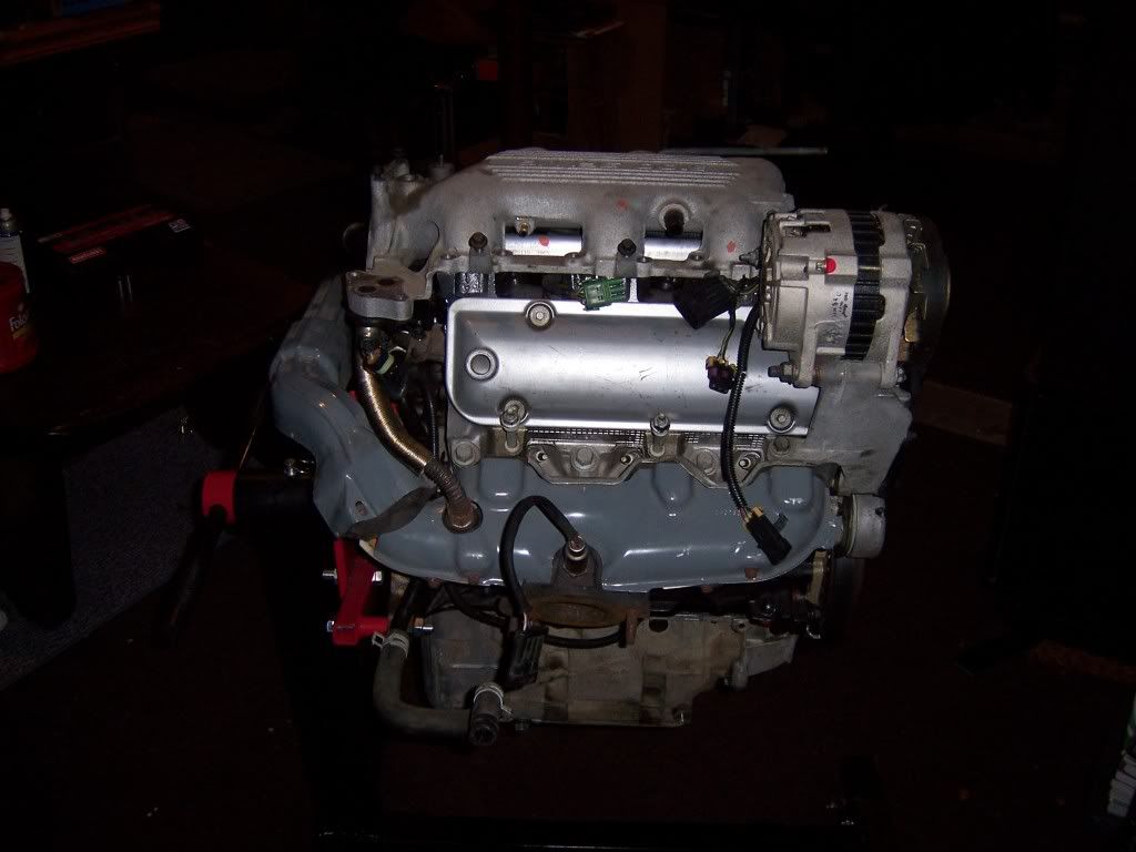

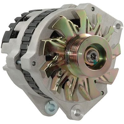

No, the 3100 has two very larg ears on the front housing and rear housing that are used as the lower bolt pivot point. I don't see that in the image posted.
3100 Alternator
3.1L Alternator
And for reference, You can see the 3100 mounting bracket in this photo.
I sent them an e-mail asking if this kit can be used on a factory alternator and not require the new rear finned housing. With the external air cooling duct that came on a 96 it may be fine the way it is.
