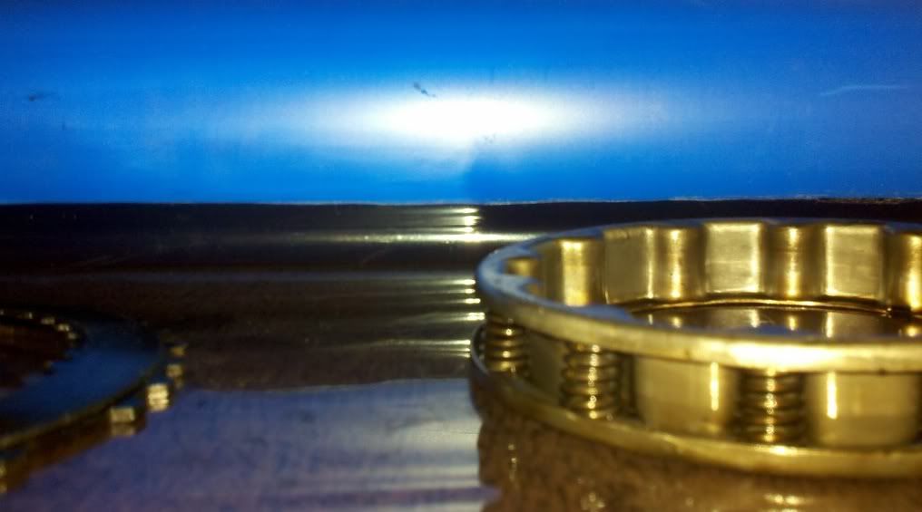

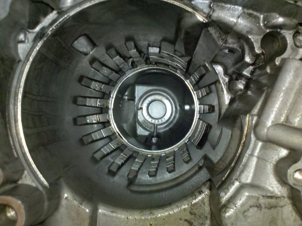

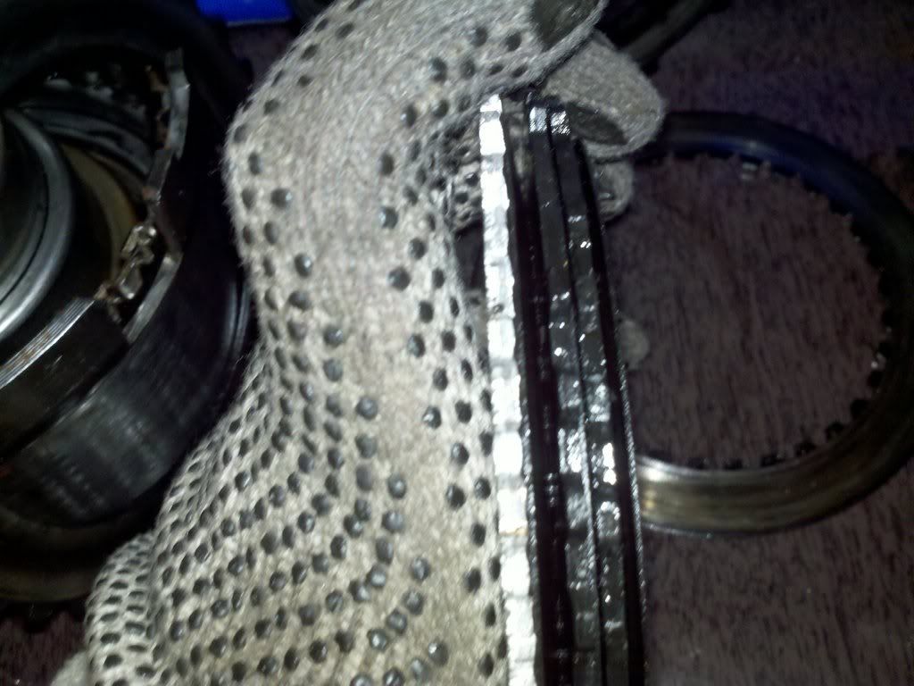

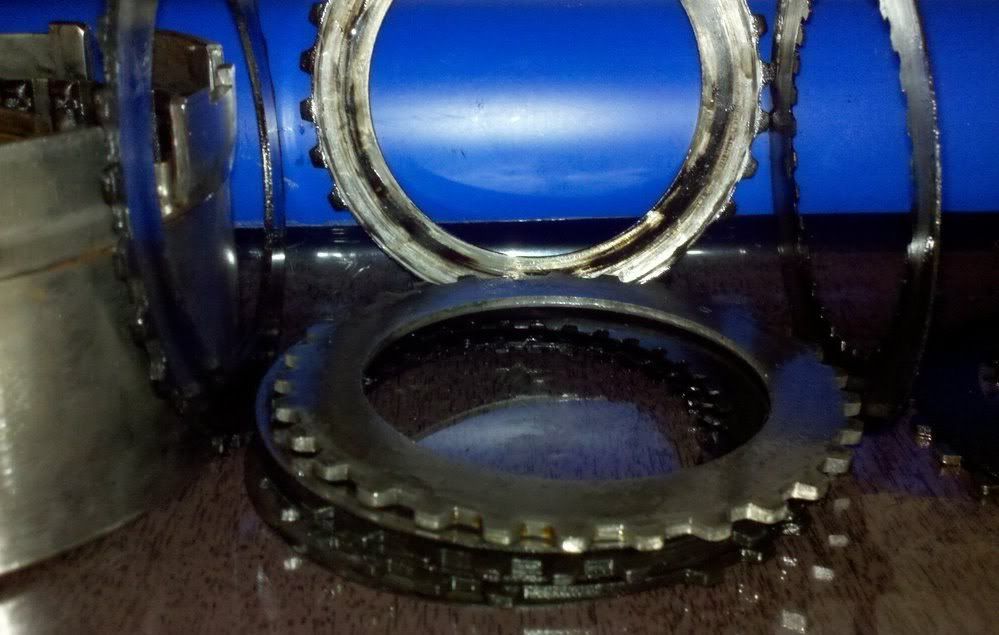

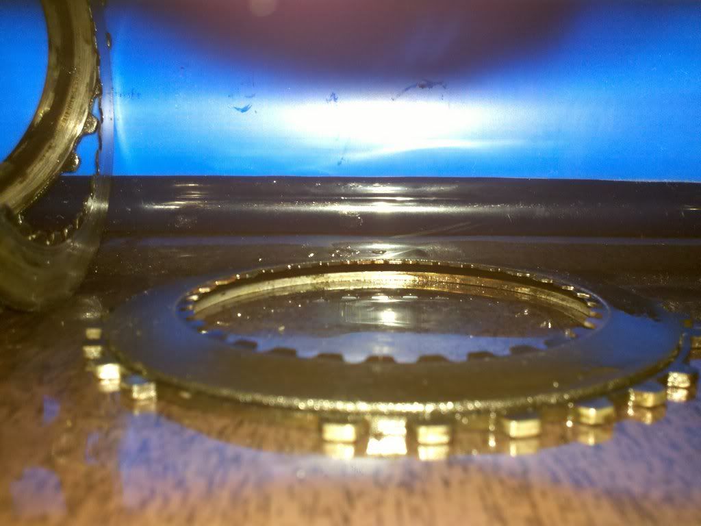

After doing a clean up of the parts I managed to snap a few pics of some parts prior to pitching...
Enjoy the carnage and random parts that survived (This trans was only in for a couple days and run time was less than 10 hours... most was of the time was idling or cruising ) :

What clutches were you using? Did you play with the valve body or up the line pressure? Without proper pressure readings and or bump in pressure then yes the clutches will slip all the time.
I still have to take mine apart to see if I had any issues with my last 12.67 run, but the only time I had clutches end up looking like that was when I put a C-clip in the wrong spot which prevented a clutch pack from disengaging when it went into OD which then yes burt the input pack to crap.
Honestly the only problem I see here is apply pressure and clutch material... I think that could be solved.

The failure was from most likely shock impact. Which resulted in the "cupping" of the clutches and waves. This last trans was my last try at using a 3speed. For that last build, I had Eric aka Asylum trans guy build it. With Eric not responding to this issue I am forced to give up on this trans and am out my money invested. So to know what he exactly did to it and what was supposed to be done... :unknown: it should have had proper pressure and correct parts installation with other "tricks" done.

I had the same cupping issue as you and there is also at least one wavy disc per pack IIRC.. And mine was a straight up slip issue which then caused all that damage by slipping as much as it did... I think I did 5 miles and I did a good job on them. So it could have just been slip. I'll have to find a close up pic of my red's so you can possibly check yours to see if thats what they were.
here's mine.
Those are hanging on my garage wall as a reminder to double check my work before closing things up... The first kit I bought to get the red clutches was close to $400 bux, I'm so glad I found the same clutches on WITTRANS.com for $155... Never buy from Level10... RIP OFF!
