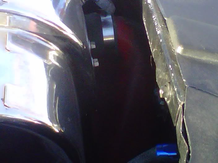

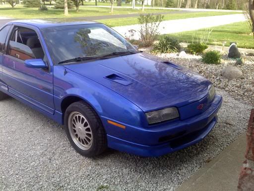

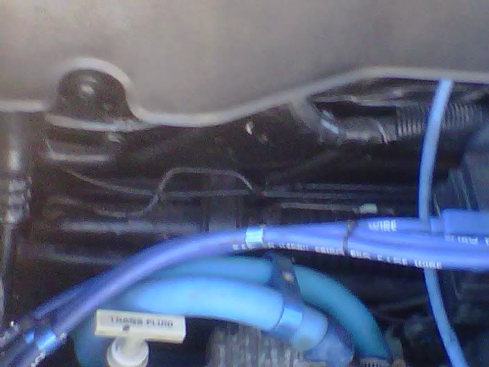

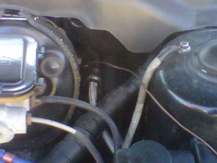

Re: Off the wall idea
alright heres some pics of a beretta that i was looking at purchasing over the winter. this is the information ive gathered upon it. its a 86 grand national/turbo regal motor. 200r4 trans. 8.5'' 10 bolt rear. it uses a section of the firewall and floor/driveshaft tunnel cut out of a turbo regal and fitted for a beretta to keep it unibody. it also utilized the stock front suspension and firewall mounted rack. i dont have pics of the bracings but as the guy described it as having a boxed subframe style connectors under the body to strengthen it up a bit. the gas tank is out of a honda civic for room. the trunk pan for the spare tire was cut and welded flat to mount the gas tank. its 100 percent unibody and is hard to tell from the outside that any of this was done.
keep in mind this type of conversion is very expensive and time consuming and would need a capable hand in doing this. im just posting and sharing these pics because someone may be able to benefit from them but also because its a similar setup to what you are asking. awd would need a complete reconfiguring of the front suspension on top of this already large list of
things to get this far and wouldnt give you any real benefits over the rwd in the long run anyway. hope some of this helps...if not at least its some nice eye candy
actually the interior i think is a modified turbo regal parts with some custom one offs to fit the size and shape of the beretta interior. as of now the car is still for sale and i have the guys contact info floating around somewhere in my email. if you want i can hook you up with him. i passed on the car, amazing enough as it is, it has some rust on the rocker area and just wasnt in the market on spending almost 10 grand for a car thats going to need some sheet metal. the rust isnt very much, but enough to deter me from it.
