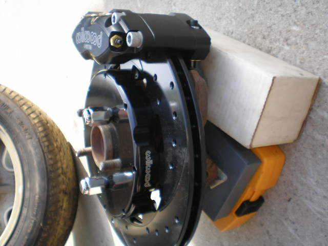

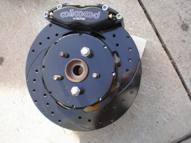

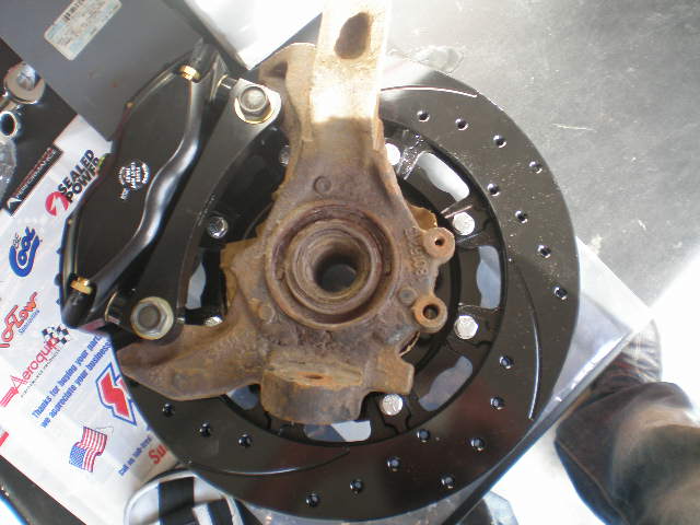

I'm building my GTU and I've been reading around on all the big brake set-ups everyone's been doing and I was getting bummed thinking I would lose the stock GTU rims. So, after a little searching I found that the 95-04 j-body uses the same caliper and rotor as the 92-96 L-body. I found the wilwood kit for the 99-04 j-body and it got me wondering if it would work.
Well, here's my answer, kinda....
The kit fits perfectly on our 92-96 knuckles once you cut the caliper guide bosses off. The 12.19" rotor will easily fit under the stock 16" rims. The only issue I've found is the need for a wheel spacer due to the huge 4 piston calipers needing clearance help. I'm not sure exactly how large of a spacer I need yet, according to the spec sheet I need 34.3mm from the face of the hub. I'm hoping someone can fill me in on a reputable company to get spacers and longer studs if necessary. Any suggestions anyone?
Yes I paid a pretty penny for this kit, but I'm building this car once, and only once, so I'm getting the best parts I can. The big upside to this kit is the minimal weight it adds to the drivetrain. Each rotor comes in at 10.8lbs! That's lighter than a stock rotor and much less than the f-bodys. For those serious about getting the most weight savings they can this kit is worth the cash. They will need custom stainless brakelines made which isn't that bad considering the investment already made.
Anyway,here's the pics so far, I wont be doing much with these for a while now, as I need the knuckles blasted and powdercoated.

Well, they're .81" thick.. Which probably isn't that different from stock i guess. The F-Body ones are 1.25" thick.

The Jbody guys love the wilwoods, and a few of them have used them in real performance driving situations - with positive feedback. So I wouldn't hesitate to use that set-up. Plus, Wilwood is one of the best names in the business in terms of performance and quality of parts.
On studs and spacers - ARP for the studs hands down. I know you're all about quality so there's no reason to go anywhere else. For spacers - I know Geoff and Jon have had some nice ones made, and I think the company they used would be a solid route for sure. Hubcentric spacers ftw.

For those interested in the specs go to wilwood and check out the pdfs on kit 140-8423-D. The rotor is a nice 2 piece design with an aluminun mounting hat to help with the weight savings.

http://www.skulte.com/ for the spacers.
ARP studs, I think I got mine from Summit or Jegs. Just make sure you measure the spline diameter. I forgot about that when I first ordered longer studs. Oops.
