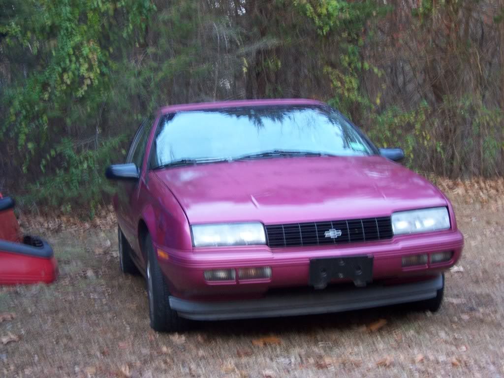

My Project.
Yeah one pic is in the sig... but here are some others.
Now the plans for this car still in the works is, N-Body Knuckles, calipers, rotors, to make my brakes a little bigger and open the option of upgrading to Vette stuff if I want later.
Engine work includes taking the hybrid from my 95 and putting a new cam in it, Much bigger one, some more port work, new valve springs and depending on if I'm crazy I may shave the heads... I doubt it though. Current setup with the cam swap alone benched 285 crank HP, so thats not bad numbers to start with, and then add a 100 shot of juice on top of it
Trans will be the 96 4t60e thats in there with a full rebuild, valve body valves replaced with coated ones, home made shift kit, Gill Younger shift correction kit, EP LSD, and a 3.42 FDR.
I'm gonna need the tuner to make this thing run...
Oh yeah its gonna get painted too, not sure how quick that will happen but I think I'm gonna keep the whole thing the original Raspberry color. Just to piss people off at the strip when I beat them with a pink Beretta... LOL
