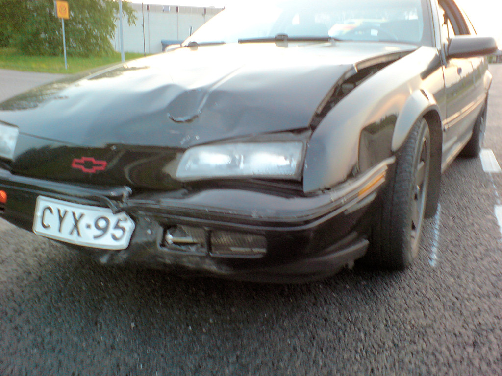

Drivers side of the radiator support has moved back 2cm (almost inch), That is going to be the hardest to fix, rest is just bolted parts.
Also hardest part to get is the base bumper cover, it would cost 300 € to ship it overseas from Rockauto, and the part it self is 60 €...
What broke:
Hood <Got white
Drivers fender <Got white
Drivers headlight <Got couple
Header panel + brackets <Got
Solid grille is slightly bent
Front bumper and cover <Got the metal part
Bumper light(s)
Air dam
Bumper lip
Hood latch support <Got
Radiator support bent
Else? Not sure yet.

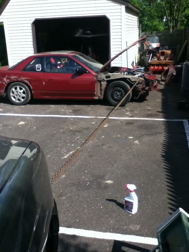

Rad support work is easy to fix. Hook a chain up to that bad boy and pull it out. I do it every time I crash the drift car.
If the support is bent downwards, like my driver side was, put a board under the chain and use it like a fulcrum and it will pull the support up and out. Works great.

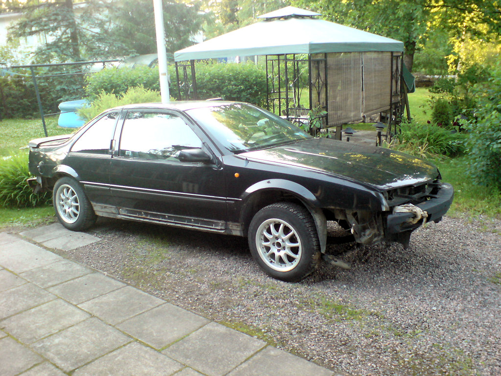

And here we have the new parts car 90 GTZ, it's quite a shamefull piece of crap to be honest, i bought i mostly because of the 2 Getrags that came with it.
I'll sort out the stuff and take more pictures later, it's stormy right now.
Anyhow, that car will donor me the hood and fender and all that stuff, Then i only need to get a set of bumper lights and bumper plastic.
Btw, this car was last driven in 2004-2005, young kid bought it for first car, then blew the head gasket and kept driving until total destruction of the engine. Later he bought a replacement drivetrain (I can't believe he actually found one!), But never fixed the car.
Looks like later he pulled the GFX from the car, and few other parts here and there, iIhave no idea where those are now, what became of easily salvageable car was this piece of junk. :(
