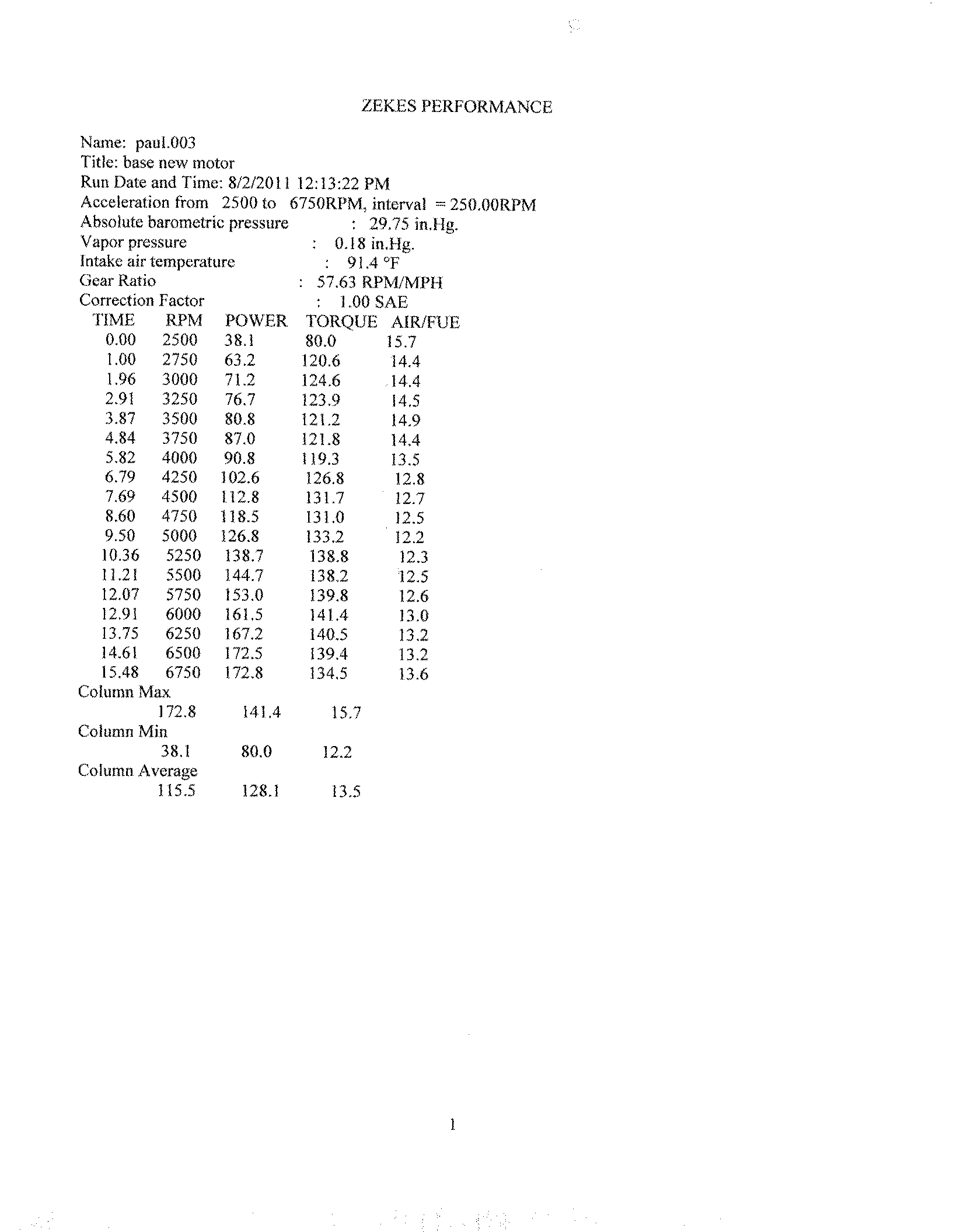

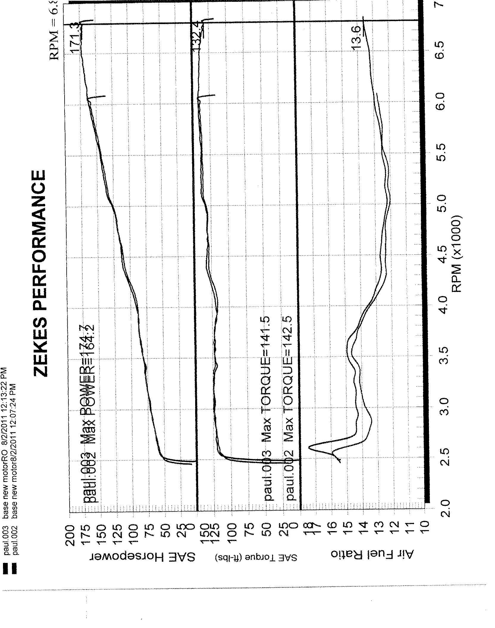

un tuned the car has been dynode 4 times, ther best is at a modest 6800 revs, 174.7 HP and 141.5 torque. My air fuel exhaust ratio is off.(need to be tuned). She was born to a 180HP and 160 torque at the flywheel.

Wow nice dyno numbers.Almost 175whp i like the duel fans also.Very nice build how do you like the total seal rings??
