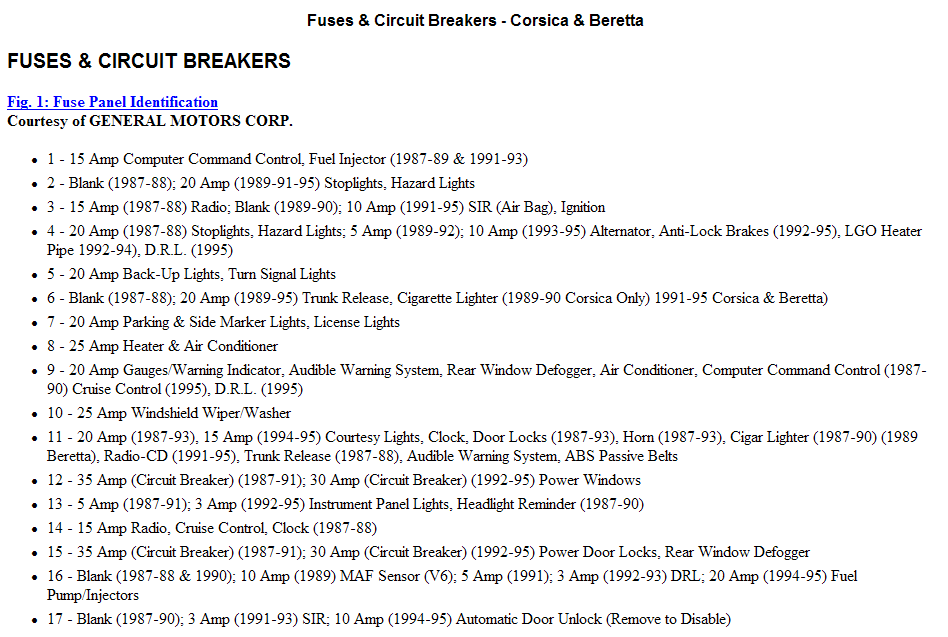

I found this info on the internet doing a search:
Hope it helps.
Courtesy of GENERAL MOTORS CORP.
1 - 15 Amp Computer Command Control, Fuel Injector (1987-89 & 1991-93)
2 - Blank (1987-88); 20 Amp (1989-91-95) Stoplights, Hazard Lights
3 - 15 Amp (1987-88) Radio; Blank (1989-90); 10 Amp (1991-95) SIR (Air Bag), Ignition
4 - 20 Amp (1987-88) Stoplights, Hazard Lights; 5 Amp (1989-92); 10 Amp (1993-95) Alternator, Anti-Lock Brakes (1992-95), LGO Heater Pipe 1992-94), D.R.L. (1995)
5 - 20 Amp Back-Up Lights, Turn Signal Lights
6 - Blank (1987-88); 20 Amp (1989-95) Trunk Release, Cigarette Lighter (1989-90 Corsica Only) 1991-95 Corsica & Beretta)
7 - 20 Amp Parking & Side Marker Lights, License Lights
8 - 25 Amp Heater & Air Conditioner
9 - 20 Amp Gauges/Warning Indicator, Audible Warning System, Rear Window Defogger, Air Conditioner, Computer Command Control (1987-90) Cruise Control (1995), D.R.L. (1995)
10 - 25 Amp Windshield Wiper/Washer
11 - 20 Amp (1987-93), 15 Amp (1994-95) Courtesy Lights, Clock, Door Locks (1987-93), Horn (1987-93), Cigar Lighter (1987-90) (1989 Beretta), Radio-CD (1991-95), Trunk Release (1987-88), Audible Warning System, ABS Passive Belts
12 - 35 Amp (Circuit Breaker) (1987-91); 30 Amp (Circuit Breaker) (1992-95) Power Windows
13 - 5 Amp (1987-91); 3 Amp (1992-95) Instrument Panel Lights, Headlight Reminder (1987-90)
14 - 15 Amp Radio, Cruise Control, Clock (1987-88)
15 - 35 Amp (Circuit Breaker) (1987-91); 30 Amp (Circuit Breaker) (1992-95) Power Door Locks, Rear Window Defogger
16 - Blank (1987-88 & 1990); 10 Amp (1989) MAF Sensor (V6); 5 Amp (1991); 3 Amp (1992-93) DRL; 20 Amp (1994-95) Fuel Pump/Injectors
17 - Blank (1987-90); 3 Amp (1991-93) SIR; 10 Amp (1994-95) Automatic Door Unlock (Remove to Disable)

Re: Fuse Box diagram!
Thank you it does help alot. ill go out anf check them.

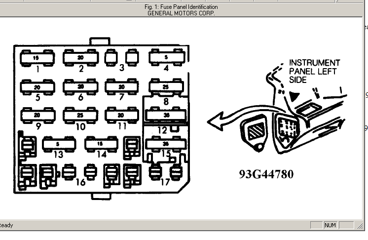

Here ya go
- Attachments
- dfadsf.bmp (1.73 MiB) Viewed 16150 times
- fuse.bmp (1.04 MiB) Viewed 16150 times
Thanks looks good. ill print this off and keep it in my car.
