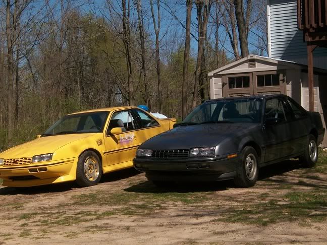

Also got the girls clean and took some pics. here are just a couple.
