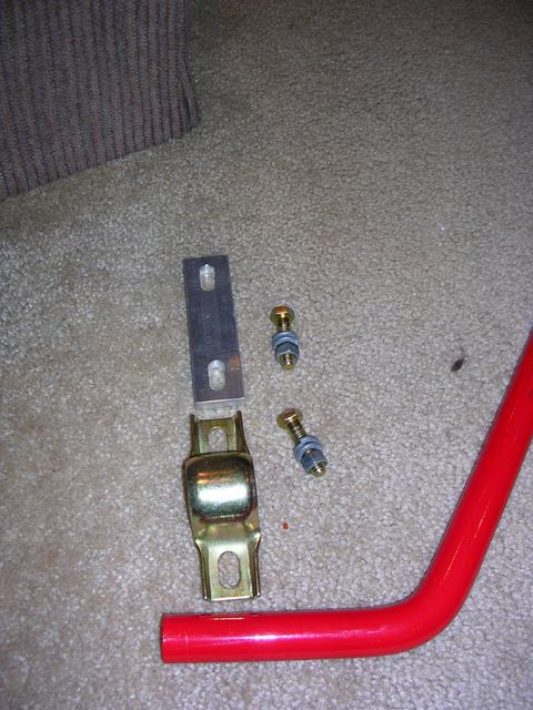

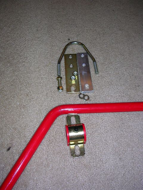

First off this should be under suspension, and what’s there not to understand about my shims? That’s how you need to install the bar to ensure it clears the lowered spring pocket on the 95+ rear sub frame.
If you need thickness measurements I can get them.
Re: ADDCO REAR SWAY BAR
IIRC, the shims were 3/8" thick.
Thanks a billion; You just made this 100x simpler. How could I have been so blind, totally need to buy new outer brackets to match the inner ones versus those supplied with the kit.
is this the correct thickness with 100% certainty?
I didn't make them I had them made by someone here at work. I could get the dimensions of them and see what he could do, but I can't promise anything.
And I know you're not promising anything, but it seems there's interest in these shimmy's. I for one wouldn't mind a set; it would make things so much easier for me. Of course if you can make it happen, I'd pay for the materials, work, +your time/effort cost.

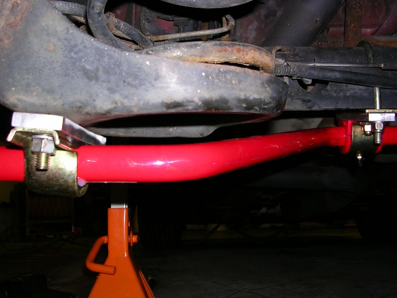

I put the same bar on my 95 without shims. You get a little bit more ground clearance that way too. I just called Addco and they sent me another pair of the inner style brackets & plates for free...
Here's an old photo:

Looks simple enough, Just have to use some flat stock and a drill press.
I'll just have to precut the length of 3/8" flat stock and wait until I get money to make such modifications :P
Posts: 10923
Those would be shims woody, just thinner than mine.
