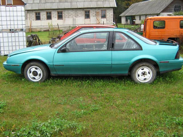

I think I should start from the beginning about the story of this Beretta. I don't even remember what the year was, when I saw a advertisement for the sale of this Beretta.
(actual picture from previous owner.
I went there to check it out in sometimes autumn and problem was the front left wheel bearing was busted. I got one from junkyard
and changed it in the night with previous owner. I got the car for around 200€ (240$) and drove it home about 50km-s. There was no ceiling carpet and air con was not working. Everything else seemed fine beside the need cleaning the car from inside and outside. First thought was to clean the car and just drive it, but it didn't happen that way. I did the cleaning and washed every bit of the car, but then I decided that the color was not for me
