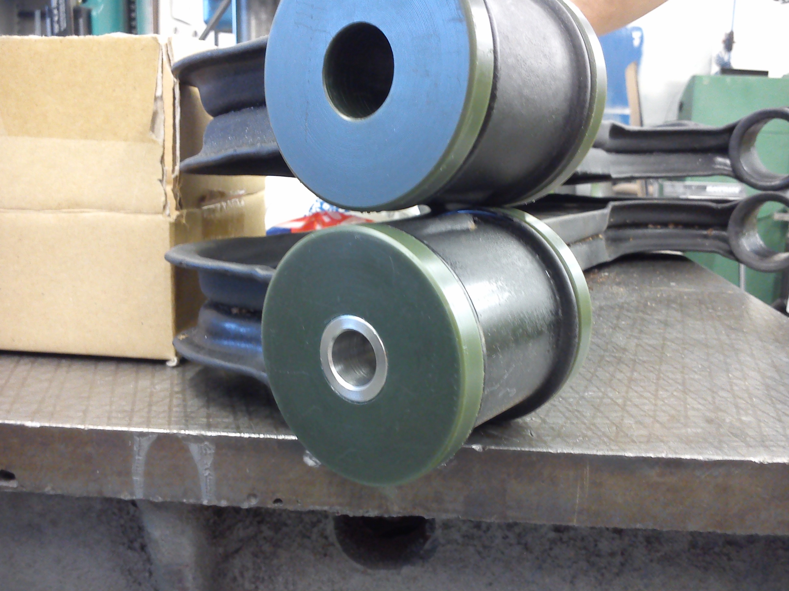

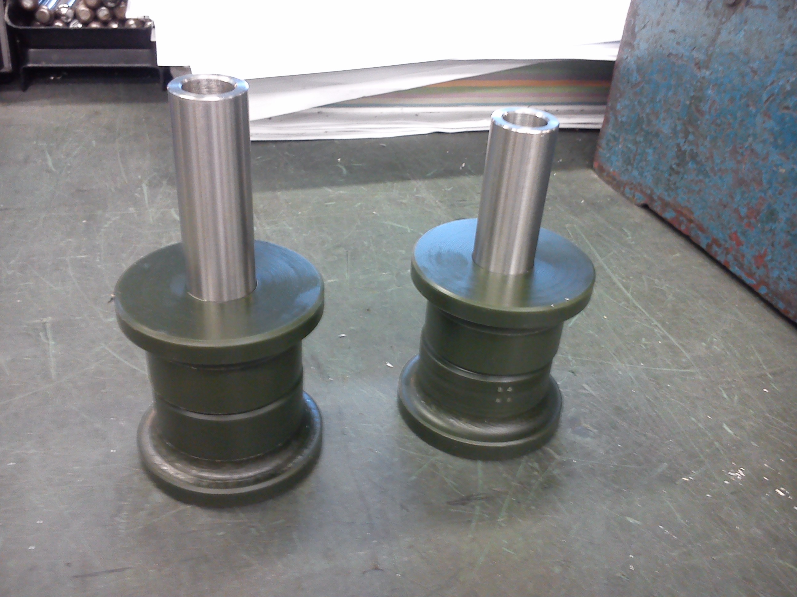

Ok some info. Got a stock bushing for rear. Multiplied it and chose nylon for material. New bushings are inside the rear frame, waiting for installation.

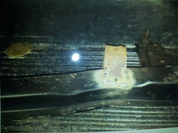

For the none "daily" driver. Rear axle with nylon bushes is in, car is on wheels again. Tomorrow will get nylon bushes for front control arms. Front subframe, that i took off 2 days ago, looks like this
New subframes were welded to little bit stronger, sandblasted, zinced and powder coated. Also stone chip protection. Same for control arms. New ball joints from Ascona C which allow a little more camber on front.
Basically that's it.

"new" subframes were actually out of some old Beretta that I found laying around some states away from me. These were the best I could find. Then just sand blast, welded, zinced and powder coated. Just need to watch that you get subframe for the right gearbox. As I have understood that for manual gearbox there is a linkage for "bone" on the subframe. For automatic it has none.
For the bushings. If only you want them, then I don't see any point of making those and send to you. Transport will kill the price of the bushings. But if you gather a group who wants these, then there's a possibility that I will produce these. Bushings are made out of strong nylon that has lubricant already inside. Sleeves are made out of rust proof steel.
