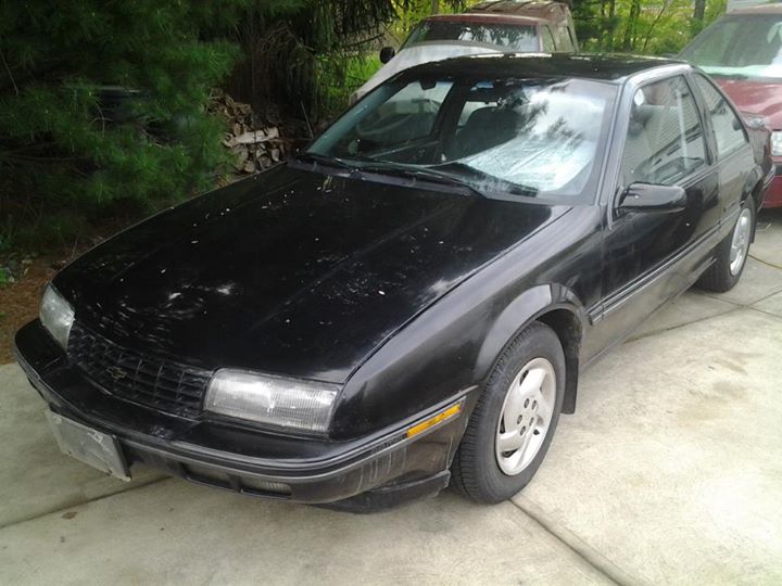

So I paid 100 Dollars at Advanced Auto, bought a clutch.
3,000 Miles later, something snapped.
I was backing up in my driveway and I heard a few loud metallic cracks, the engine stalled and I couldn't get it out of gear.
External inspection everything looks fine. I jacked up the car and it disengaged, and everything turns in neutral.
Clutch peddle got really easy to press. LOL
Its not apart yet, but I plan to add photos of the clutch in the future because I'm curious how it broke.
Its a 1988 Beretta GT, 2.8 5 SPD.
I'm hoping the fork is okay, I don't have a spare and nobody makes them anymore...

I'm still deciding though if I should wait till summer and fix it, or just sell the car for 2,000 dollars.
Idk yet.
Its in great shape, just needs a clutch...
106,000 Miles. And well taken care of.
You'd just have to tow it as I recomend changing the clutch before you start that engine again to prevent any major damage that might possibly occure from something not going in the right spot.
Clean underneath, there is a little rust in a couple places but not bad.
Best You will probably see on an 88 Beretta GT in the whole USA.
Forgot to say, its a 2.8L v6 MPFI 5 SPD.
