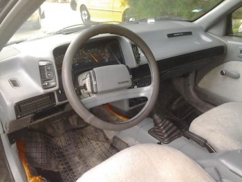

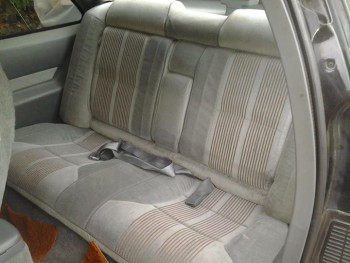

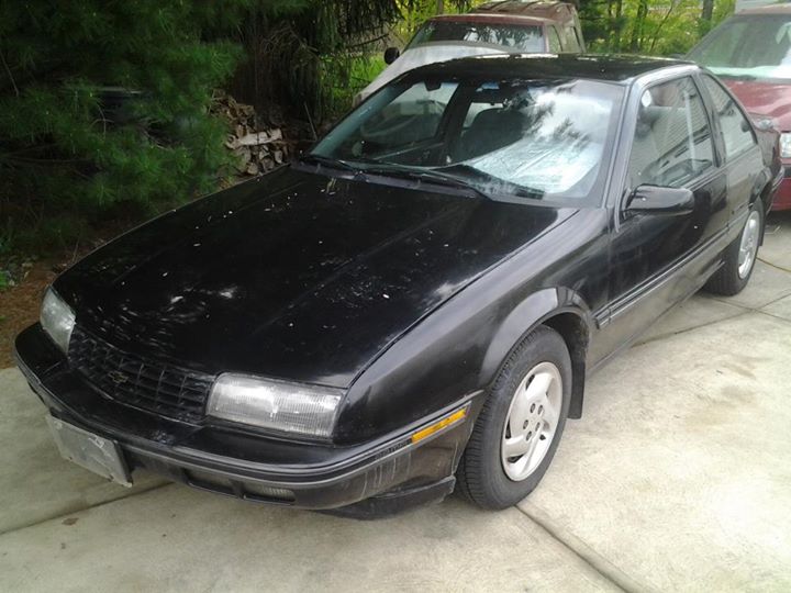

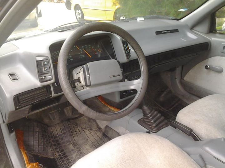

Its in great shape, just needs a clutch...
106,000 Miles. And well taken care of.
You'd just have to tow it as I recomend changing the clutch before you start that engine again to prevent any major damage that might possibly occure from something not going in the right spot.
Clean underneath, there is a little rust in a couple places but not bad.
Best You will probably see on an 88 Beretta GT in the whole USA.
