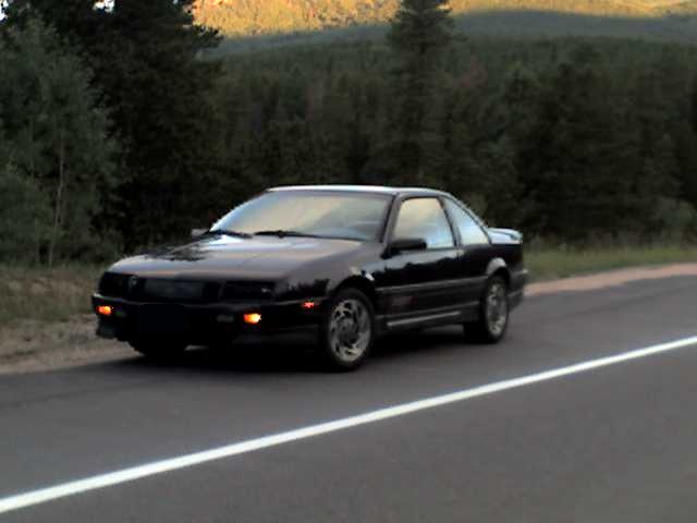

This was my first 'Retta, the '90 Turbo.  She is lying, she actually has a 3.4 intercooled turbo, not a 3.1...

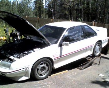

Here is my Super Charged 3800 II GTU, after the engine and five-speed swap, but before the six-speed conversion and the theft of my GTU rims (she has been wearing GTZ wheels for a few years now).

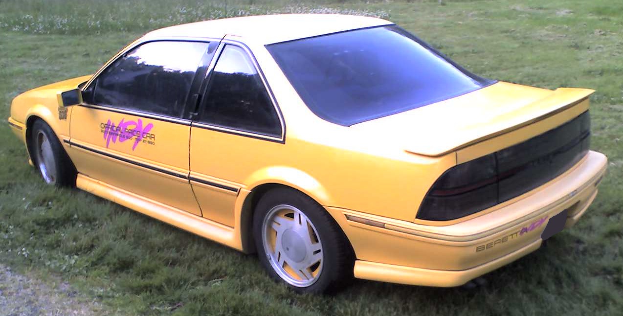

This was (is?) my '95 Z.  I don't have many pics of this car, and I have to go back halfway across the country to get her again, but I really do want to.  She has had a VERY hard life, but still has a lot of life left, too.
Here is the prettiest of the Berettas in my family.  So far mechanically stock (!), she is slated for a five-speed swap, and will likely get a low mileage 3.4 TDC engine I have from a Z-34 Lumina.  I might try to use the correct Muncie/Getrag 284 for that engine, which will need  custom or hybrid CV joints, or I might save that tranny for my Fiero and just use a 282.

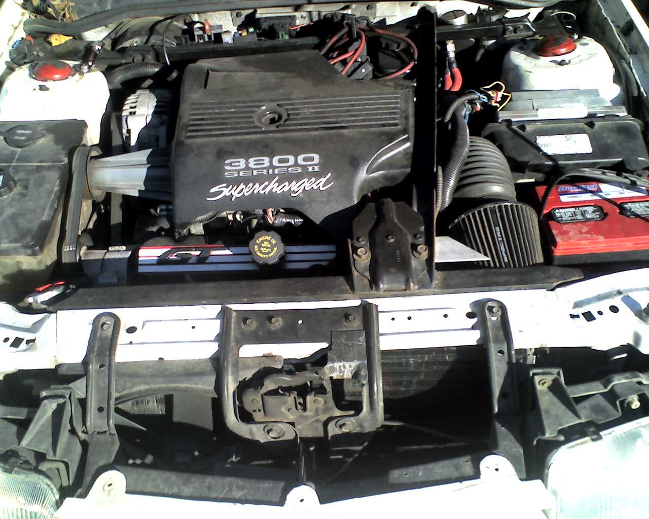

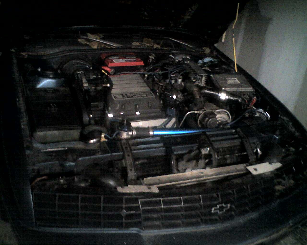

Here is a fairly recent pic of the GTU's engine-bay.  I have since replaced the missing 'u' from the valve-cover though.

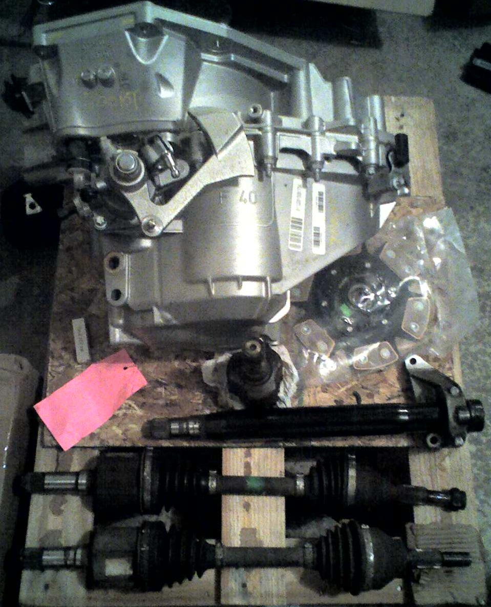

Here is the six-speed I put into the car (before modifications).

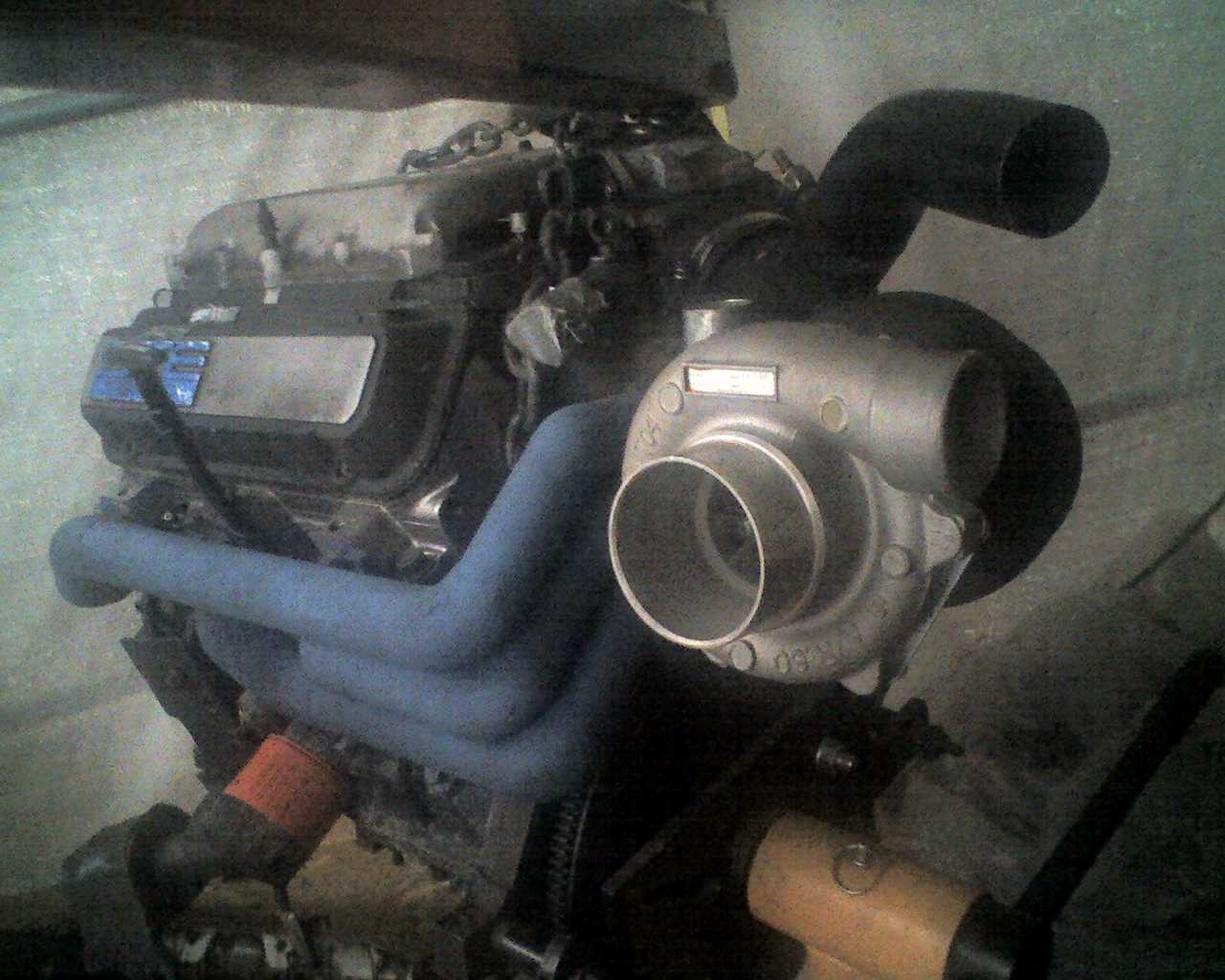

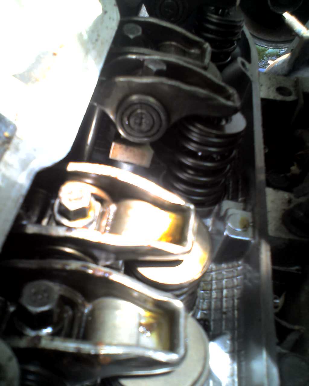

My '90 Turbo was upgraded with a 3400 block and ported-out 3.1 MPFI Turbo top-end, modified for roller-rockers and 1.5" primary headers feeding a new Garrett T-4 externally waste-gated turbo-charger. I've been fighting chronic oil-leaks from the turbo's supply-lines, and have been playing with different instrument clusters for it, so it hasn't gotten much run-time since the swap was finished.
It took two tries to get this engine working right in the car.  I bought it from the salvage yard for $60 with a 'blown head gasket' that was actually a blown-out LIMG.  I didn't know that it had already spun the rear main bearing, so it developed no oil-pressure once warm.  I pulled it out, and later re-built it into this.

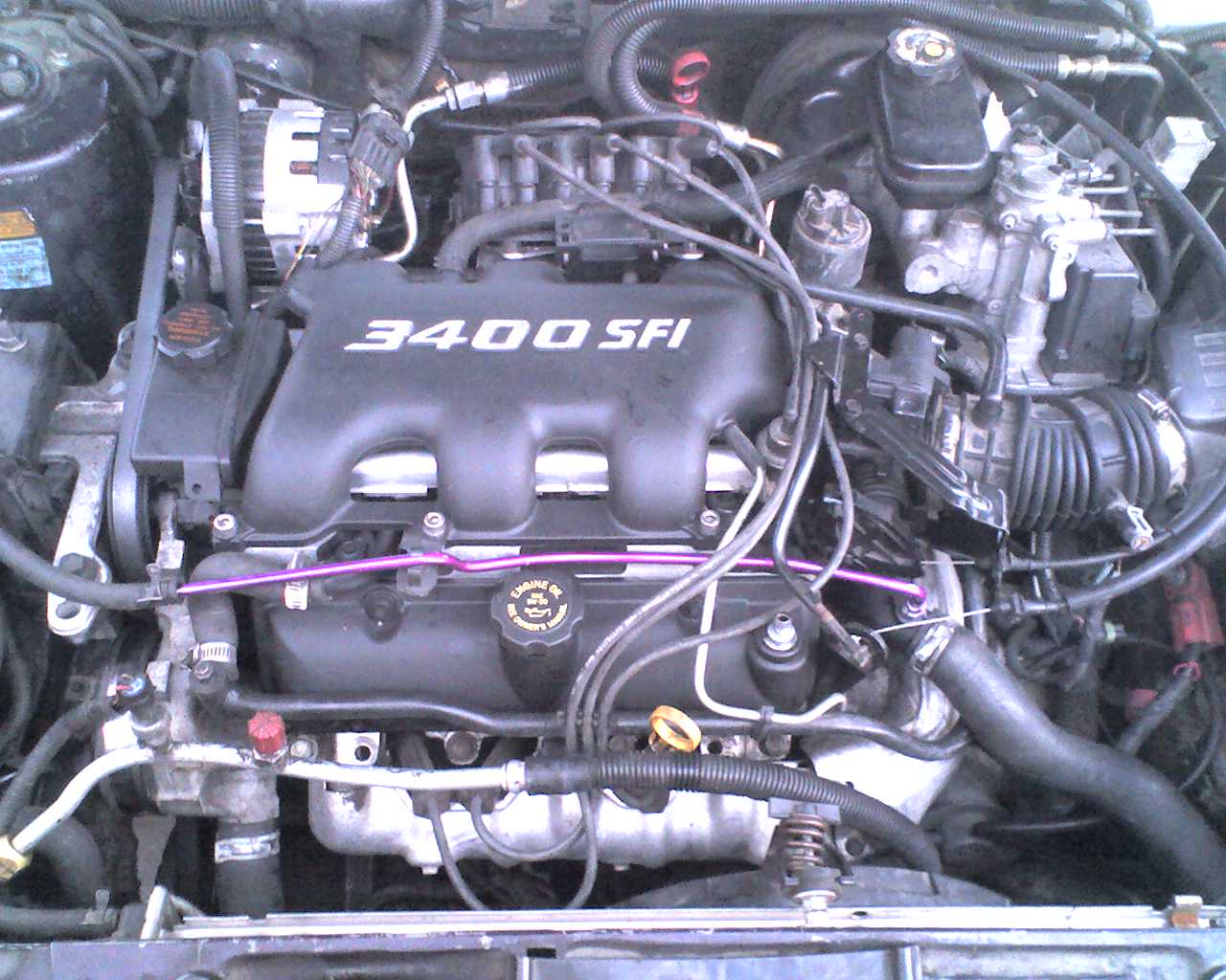

In the car now.  It runs like a monster, and makes almost as much torque as the 3800 SC (pushing 300 foot-pounds, or more).

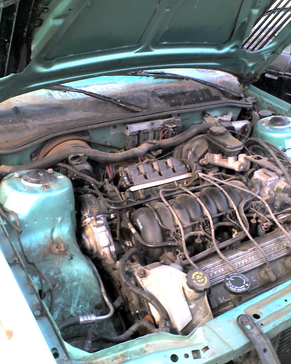

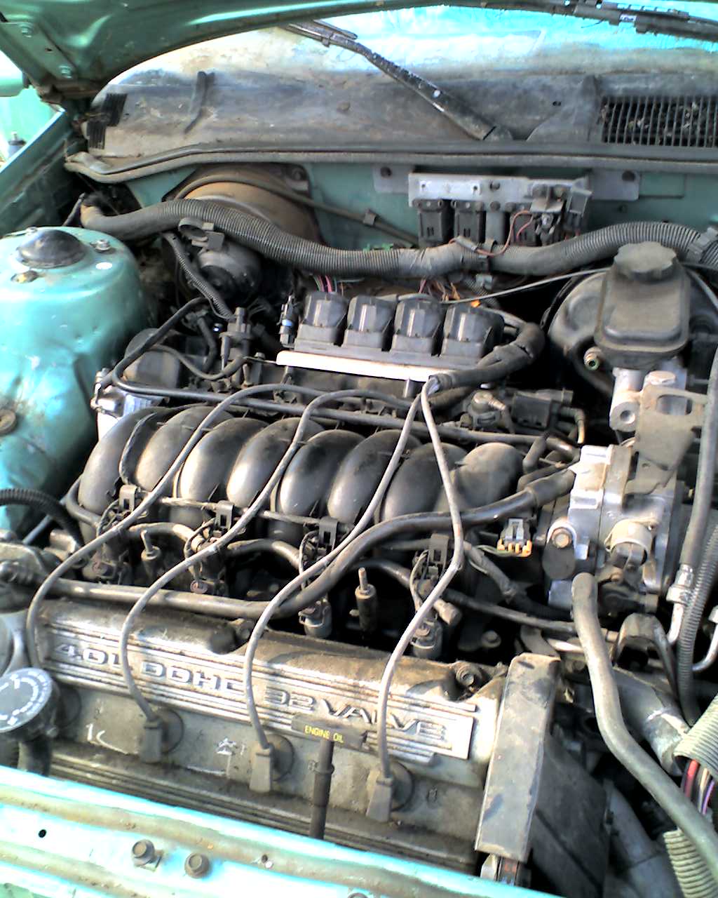

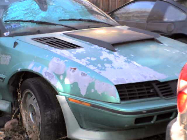

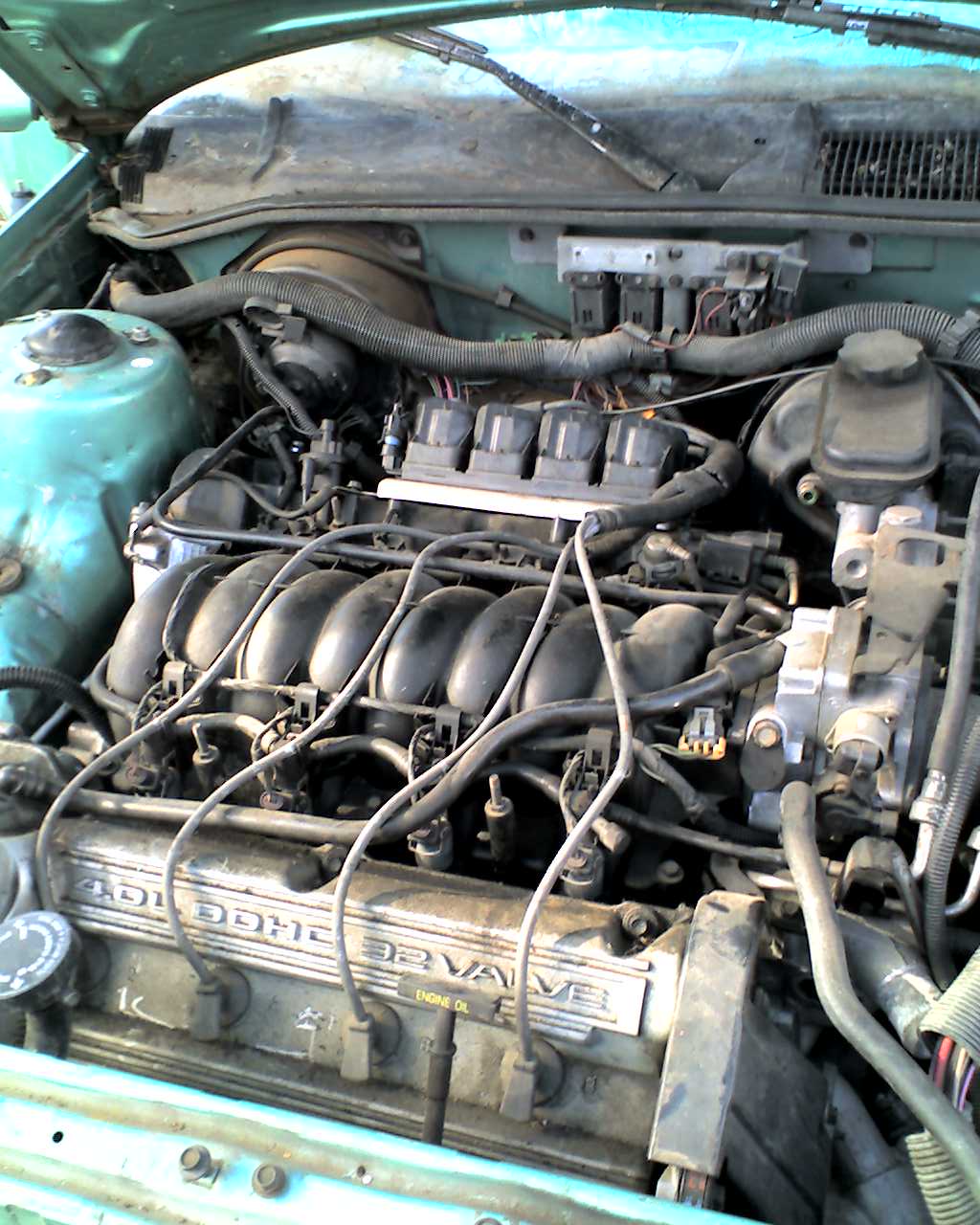

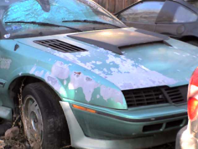

I don't have any new pics of the V-8 Indy. Here are the old ones from before I took it home. It is an original five-speed digi-dash car. Most likely, I will re-paint the car in black with teal accents and custom teal Indy decals. It also has a Fiero GT Wing spoiler, which doesn't look bad on the car, just a little big.
New engine and tranny mounts, radiator hoses, a full L47 PCM re-wire, and a new dual-exhaust are in the works. I have, um, misplaced that radiator too, and it is virtually impossible to replace, so hopefully I can find it. This car was a kick in its' day, with 240 HP and a wicked V-8 note, I really want to get her up and running again, hopefully better than ever. I am concerned about the internal condition of the engine, as it seems to be stuck, so it will likely be coming back out again before being run. And, a new custom oil-pan has to be built, as the original modified pan was busted -why the car was parked to begin with. I still hear from people that the Northstar engines won't fit a Beretta bay. I don't talk much about the car, just because I am tired of arguing against ignorance.
