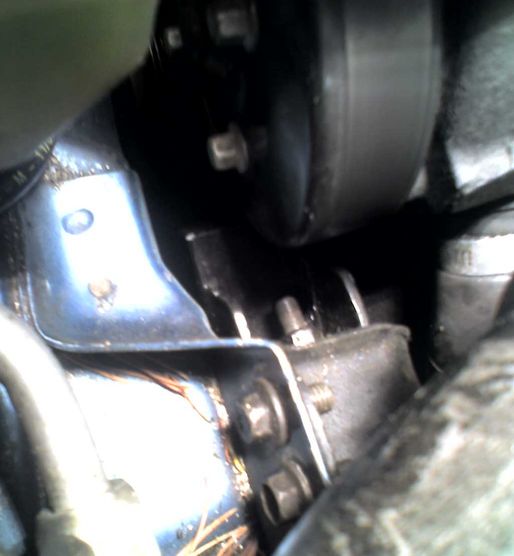

I needed a decent front engine mount for the 3x00 block since I was working with an older Beretta, and my old temporary one couldn’t properly support this engine with the old turbo, exhaust, and 3.1 ECU during very gentle test-driving. It wouldn’t hold up for long under the updates I made, so I didn’t bother with it, except to use it as a template for a heavier-duty unit. I used ¼” thick 3”x3” steel angle stock for this one, and it looked and worked perfect.
